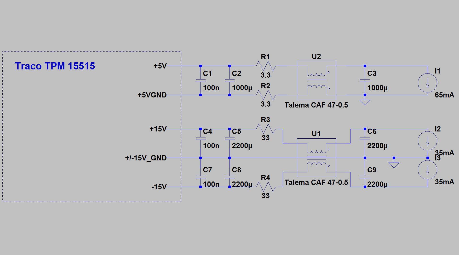

Please find attached the Filter for the Traco SMPS Joachim tested.

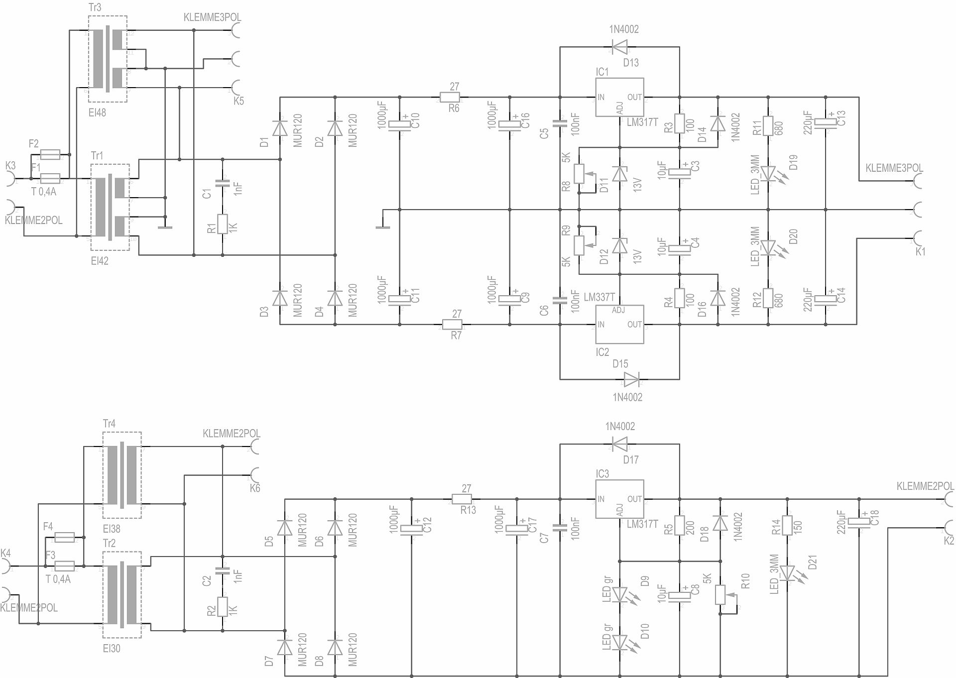

I'm using 3 power supplies all designed by AMB audio. The model of the supply is the Sigma 25. The first power supply is providing 5v to the DAC board and to an Acko S01 Isolator / Re-clocker board. The supply is connected to a terminal strip which then connects to the two separate boards. I'm reading +5v in to both boards and 3.3v or 3.6v after their respective LDO regulators (DAC, XO, and power for re-clocker board). The other two supplies are connected together to provide +/- 15v for the JG Buffer. I'm getting a reading of +/- 15v for this supply. So it looks like my power is in order.
