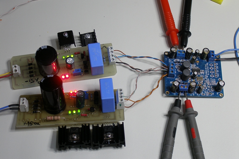

I measured the dc-offset of dac.
The measuring done with 2 Salas regulated to ±15Vdc and 5V from my DP832 Power Supply without any input signal.
Unfortunately, the man who constructed this doesn't much well the fet's.
As you can see, the left output has -63.13mV and the right output has 51.18mV.
Respectively the ESS-9023 output was -1.2mV the left and 2.75mV the right.
I am thinking to study the Daniel's method of fet matching and to replace all of them.
Hi lemon,
indeed it seems there was some missunderstanding at the manufacturer how to proper match the FETs although I provided a detailed instruction. Me and friends built more than 20 DACs and all had a DC offset below 5mV. I am in contact with miniDSP and we are currently working on this issue.
I'll keep you informed...
BTW: what would you think is a acceptable/expected DC offset (keep in mind the cost of the board )?
regards, Daniel

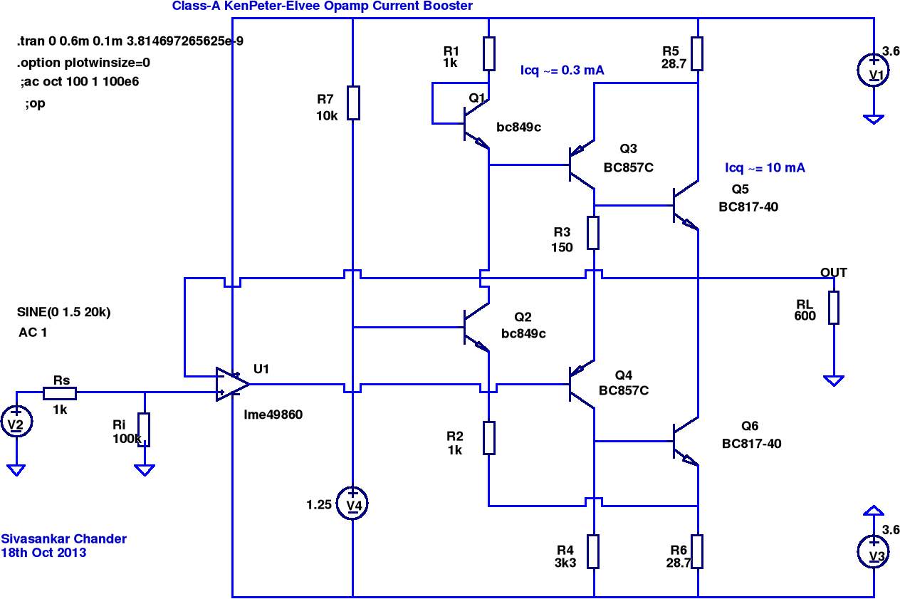

I believe Ken's Diamond (basically a BJT buffer derived from the Taylor follower) probably outperforms the JFET buffer, open-loop - here's the key post that defines the topology:
http://www.diyaudio.com/forums/soli...-buffer-power-output-stage-9.html#post2056889
I did some minor changes in simulation (flipped polarities of all actives) and added an opamp to imcrease the loop gain as well as servo out the offset - the opamp is optional, but it greatly enhances the performance. In practice, a low-rail or rail-to-rail opamp would work best at the +/- 3.6 V rails available from the ES9023, instead of the LME49860 shown in the LTSpice simulation schematic shown below.
At 1.5V into 600R, THD20 is ~ -150 dBr with the opamp in the GNFB loop. Without the opamp, and the buffer running open-loop, THD20 is still respectable at ~-80 dBr at 1.5V into 600R.

Thanks for the feedbackand good to hear that you like the sound
While the DC should not be a big problem if the amp is ac-coupled (capacitor or servo) I am wondering a bit about the quite high values. I build more than 10 DACs myself and always had below 10mV (most are 2-4mV). I'll check this with the manufacturer.
The 0 Ohm resistors are R46 and R56, however adjustment only works in one direction. So if you have a small negative offset (e.g. -50mV referenced to ground) you can use a small pot (you'll need approximately 10 Ohm for 50mV) instead of the jumpers to adjust the DC offset.
regards, Daniel

The first quote is from another thread "ES9023 I2S Input DAC incl. JG Filter Buffer".
Have in mind the above two quotes, I have some questions for you.
1) What is the appropriate smd variable pot for the position of R46/R56 (not value, but what type)
2) What is the meaning with that "however adjustment only works in one direction". If the one channel has negative offset and the other positive can't they to trim -> 0mV?
3) Is there critical difference if the matching done by pot or by well matching fets?
4) What is the right procedure to match well these fets? Is there any reference somewhere? I am thinking to use the Atlas DCA Pro Semiconductor Analyser for that purpose.
Daniel, I hope so don't misunderstand me for what I wrote that he who constructed it didn't a good job in matching. This is a dac, a cheap one, but this is a dac and the output must to be as possible without dc-offset.
You made well design of course, but the constructor didn't follow your directions or he has confused about these.
It is better to correct this, otherwise it is better to you to give it without the output stage and the diy person to complete this himself, as your directions.
This is my opinion.
I give the answer to myself
1) there isn't such a small smd pot, it is better to put a Bourns 3296Y type btw 2&3 or 1&2 legs with some mods on legs.
3) the corrections can be achieved only to negative values the positives values couldn't to decreased. I tried two of them and the correction done only to negative place.
Totally, if you have one channel with positive and other channel with negative dc-offset, the better is matching the fets right.
