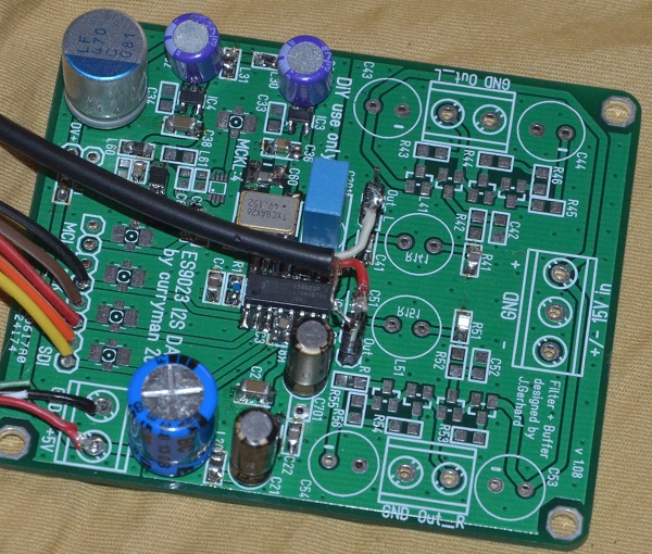

I use LP2985 3.6V reg + 150nF COG noise cap + 22uF X7R output cap (ESR is minimum allowed). There is 470uF BC038 + ferrite + 10uF Silmic II on input. Power is linear from uA7805. I2S source is isolated.
For J1 I use 15R thin film + 470uF Nichicon PLF for RC filter. I use 2x LP5907 3.3V reg with 1uF X7R output cap and 47uF oscon input caps.
XO is TXC 49Mhz with <1ps. It is not the great part but it is the best I can get from the local seller. I fit one flip flop so there is 24.576Mhz output. I will try with CS8421 asrc.
The extra long pads are great. I can parallel 100nF COG with 2.2uF X7R for charge pump. I use 100nF COG + 1uF film for neg rail.
Again, thank you. :D

Just to make sure: from the picture it looks like you put some Cs (Pana PPS) to R41 and R51?

Yes, you see the R41/R51 is 4.7nF pps, ready to try a second order filter. Today I already tried some different output filter because I cannot buy the coils. I like 4.7nF on the DAC output, 100R for R141/R151, and 9.4nF for R41/51 (it is 2x 4.7nF on each channel). I also try the CS8421 upsample to 96khz and 192khz - the DAC likes 192Khz ! So now I am very happy, especially my soldering on the tiny flip flop is successful, and must listen to more music and more music.

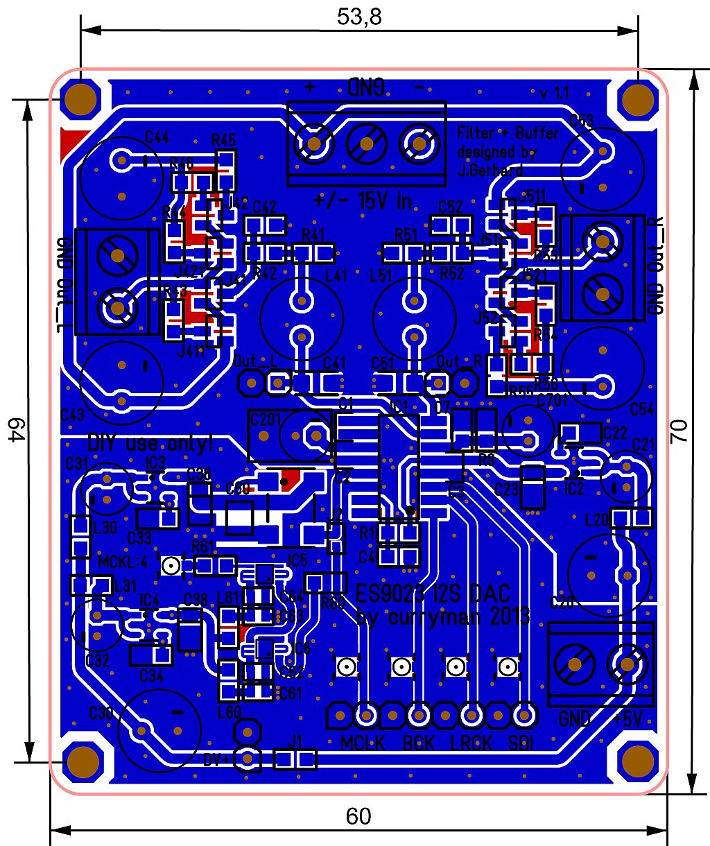

Board dimensions
gmant123: please give me one or two more weeks. Then I will be able to give you more info about availability and price of stuffed boards.
Mull3t: please find attached the dimensions of the board (v1.1, but v1.08 is identical). Measures are rounded to 1/10th mm.
Best regards, Daniel

changes from 1.08 to 1.1
There are no significant changes from 1.08 to 1.1.
I moved R8 at Vreg to the top layer which makes the board easier to produce (all relevant* parts on top layer) and did some minor changes/corrections to the silkscreen, e.g. C23, C36 and C38 and +/-15V in connector. So not really worth upgrading existing boards ;)
*BTW: After discussion with Joachim I removed the Rs parallel to the inductors. We both had the feeling it sounds better without. Should still be no problem to solder them between the inductor pins though ;)

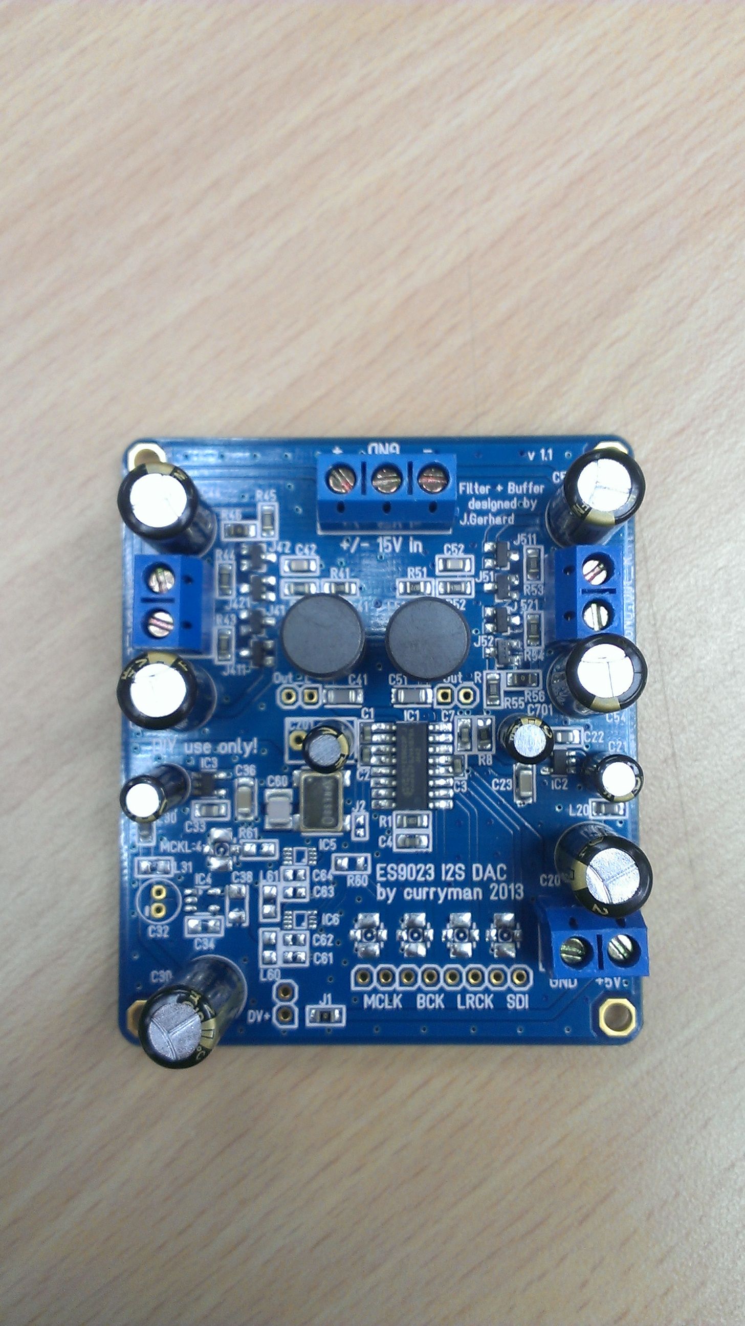

Update
After some minor issues with the manufacturing we are on a good way to release the stuffed boards. Please find attached a picture of a prototype. Please note that some parts have changed for the final version (some Cs).
As you can see the 1:4 MCLK divider parts are not placed to keep the cost down (most users won't use this feature anyway) but pins and traces are still available so everyone can upgrade ;)
We didn't decide on the final price but I estimate something arround 40-45 US$.
I'll announce the boards in the commercial area when they are available:D
best regards, Daniel
