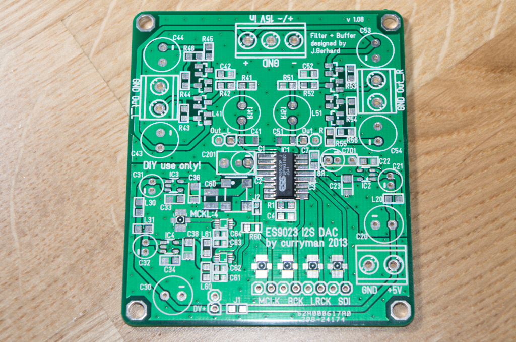

I did not have the time yet to do my own tests but after looking into the datasheets of the DSP the I2S data outputs probably have not enough drive capability to drive more than two or three receiver. Also reflections from not properly designed traces might be a problem (traces and connections on my board have 50Ohm impedance).
With my boards using its own MCLK we will not have any problem with MCLK and SDI (each data output is only connected to one board), but LRCLK and BCLK must be shared and thats a problem. I am just working on an active solution using buffers (either 74HC244 or CDCVLVC1104 Fanout Buffer) however that may take some time. I will also discuss this with DevTeam from miniDSP.

Just to followup - I have some troubleshooting in my future wired it up for testing and didn't get any output. Just started to check my v at various vias and pins and my granddaughter busted in. It was a mad scramble to clear my work area before those lightning quick 3 year old fingers hit their target.
I'll be back at hit when company clears. I'm sure I just did something stupid.
If you have another DAC with I2S input you should make sure that the I2S signal are all good ... in other words that the known good DAC works with them. If not then that will have to wait.
Having looked at your photo just now I have a one thing that I would look at: the center pin [of 3] of the regulator next to C22 might not have any solder. You don't need R8, but having it should not cause you any grief. I had it soldered in place on my board for a while and everything worked great. The connections to the ES9023 using the 0 Ohm resistors are obviously a bit iffy, but difficult to check. What did you do to make sure that you are not making contact with the vias in the ES9023 footprint?
Best of luck.
Best of luck.
grufti, good that you mention the vias under the ES9023! They are at GND potential and not covered by solder mask. I simply overlooked that for the first revision For the second board they will be covered
@MisterRogers: please also check the right solder joint of C6. Looks suspicious to me. While this will not stop the regulator working it will degrade performance. Hoping you will find the fault soon, I can very well follow your situation. My Kids are also amazingly fast
BTW: I ordered some V2 boards (hoping they will be delivered by the end of next week) and parts I will keep you informed about my progress...
Thanks for giving my board the 'eagle-eye' mates! Face-palm; forgot the isolation material above the vias under the E9023. Daniel reminded me, as did Pat; just zoned out and forgot. C6 & C22 are fine; I just need to remove and re-solder the DAC chip. At least that, but it's likely that. Thanks for the look gents.

Dampers
SO the ~47K damper R's go on the bottom? And the C201? doubles as a -V pin-header if you wish to insert -V to ES9023 "NEG" vs using it's charge-pump, eh? It looks very nice!
I did not measure potential impact, if any, on value of the Vreg resistor on ES9023 pin#6 to GND vs what -V you would read at ES9023 "NEG" pin, if using a CP cap [I do not know if there is a relationship at all]. In testing I took a reading of -V at NEG, then removed the CP cap and inserted the same value -V using a 79L05 and a 100R POT preset, then soldered in, then fine tuned to, in my case, -3.4V which is what my VOM read when CP had been running.
Thanks for the update, Pat
