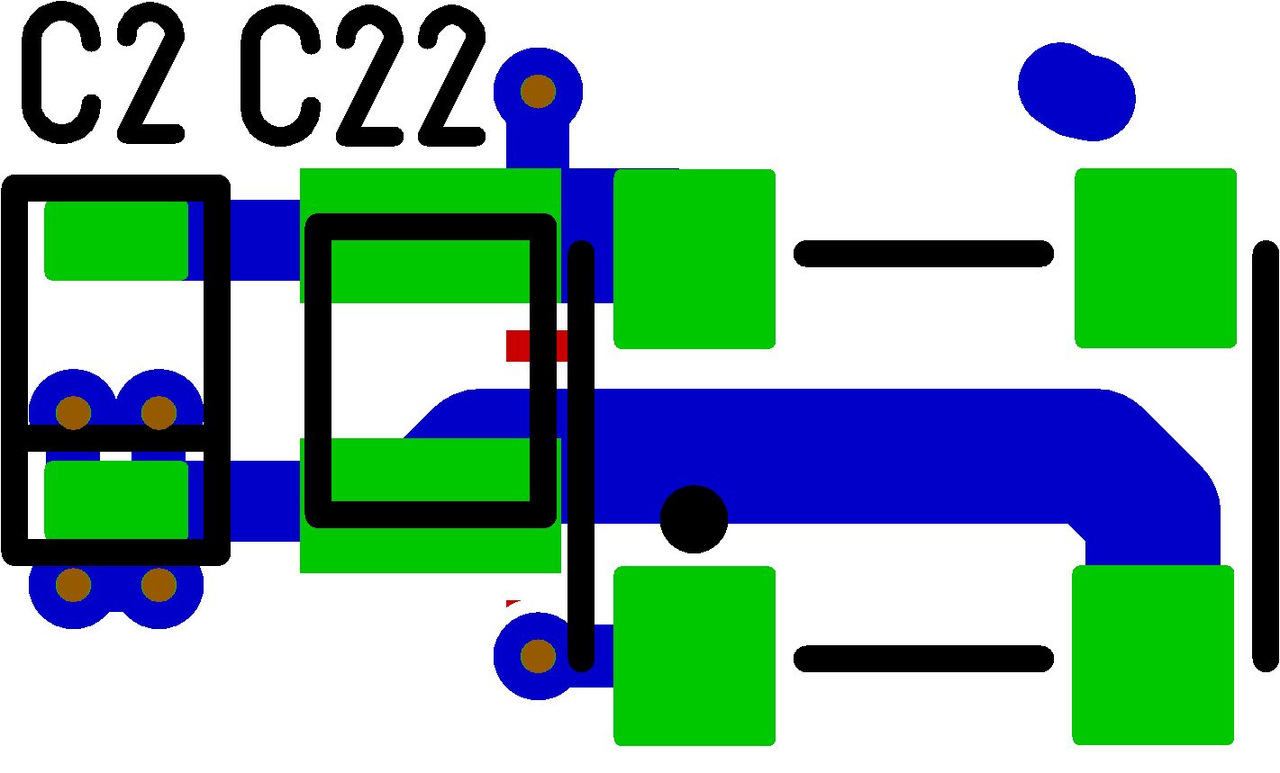

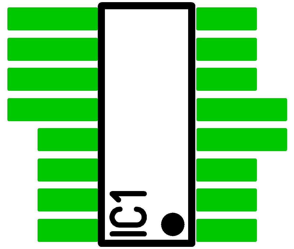

Since it turned out eek that a suitable pad layout for the ES9023 was not available I made a new one. Some pads are a little bit longer in order to put Cs directly at the pins For the charge pump 1-2.2µF X7R (0402 or 0603) is perfectly suited.
Have a look at the layout for the XO decoupling and grounding. The small cap C22 for local decoupling (10nF COG/NPO) is as close a possible to VDD. GND is routed with a low impedance trace to the Cap. Note that only the bigger cap C2 (e.g. 2.2µF) is connected to the groundplane. The XO will draw current during rising or trailing edge. This will be delivered only from C22 (C2 is too slow and too far away) and thus the current will flow from C22 through the XO and back to C22. All the noise will stay there and not affect the main ground! I used the same layout for the flipflops
I omitted the TH foil caps (103, 104) since I am convinced that the SMD PPS caps are really good here and this gave some more room for improvements on the lower board area

Good reasons to drop C103, C104. I had noticed the close proximity of C2, C22. That sounds like a good way to go, possibly even overkill, but that would not hurt. The longer pads around the ES9023 are a neat idea. I can't wait to try that version.

Don't think that C2 + C22 are overkill. You'll need a fast cap (e.g. <100nF) to serve the current need of the XO (3ns rise time -> 333MHz + harmonics up to GHz!) and with this small cap the reg will not be stable (at least MIC needs some ESR as you also mentioned -> Tantal). Also reg is much too slow to reload the small cap between the transitions.

It's always difficult to communicate glitch free on a forum like this. I didn't mean to suggest overkill. I really like the C2 , C22 arrangement as proposed. As far as I can tell it could handle frequencies many times higher than the ones we're dealing with here. That's where the idea came in.

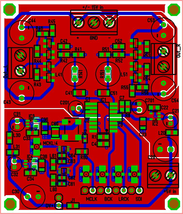

Update: progress of next version
Hello all,
just want to give a short update of the actual progress of the next board version. Please find attached the actual layout. Note that the top layer ground plane (incl. all the vias) is not routed yet.
For the 3.6V reg I went for the MIC5205 with respect to bypass C layout (one C from BYP pin to ground). For the two 3.3V regs there is a second bypass C from BYP pin to OUT pin thus also other regs can be used (e.g. LT1761, heard that someone has lots of ).
The XO was turned 90 degrees. The clock trace to ES9023 is a few mm longer (though impedance controlled 50Ohm) but I forgot the return current from ES9023 DGND pin to GND connection of C36. This way back was interupted before the 90 degrees turn by the ENABLE pin connection to SUPPLY pin of the XO which was routed on the bottom layer (damn HF)
I also introduced a segmented ground plane to keep the analog ground clean from digital noise. The connection is below the ES9023.
I will prepare a new BOM soon. This will also introduce the new component numbering.
Any comments, critics, recommendations,... are very welcome!

About 825x LT1761 3.3v "around" yes. I have most of the parts for something like a group-buy of around 250x, but the FET matching I am not sure I would want to do. If you trust them, paying say a young kid to take the readings, might be an option.
Can you extend out a NEG pin pad to insert -V there? Else I would use top-mounted SMD C and fly in -V to it topside. I suspect I will make my OWN negative rail V as I did in the recent test: 79L05 or better, a POT, a cap. Micrel -3.6 might also work [the negative version of the +5209 model]. I am not done testing if there is DC offset on outs when I am flying in -3.4V to NEG pin [no CP cap{s}]. If there is DC OFFSET I could tune it out with my 10-turn PCB POT.
The segmented ground is nice, it would be even nicer if one could be ABLE to saw off the JG filter-buffer stage in a pinch, but eventually I WILL make the super tiny I2s ES9023 I am longing for. :^)
So there is regulator ART for FlipFlips{3.3V}, 50 clock{dedicated 3.3V}, and ES9023 {3.6}? Is there room for a ferrite between V+ to OSC and the LT1761? {am I nuts?}

Lovely, I don't see anything that I would want to change! The only exception to that is one label: I believe "GND" at the +15/-15 header is actually written "8ND", but then, maybe for a reason?
Glad that you like it You have good eyes: it indeed looks like "8ND". Must be JPEG compression artefact since in my layout programm it reads "GND"
Thank you very much for the feedback!

What about using the C201 pins to connect to the NEG pin? If you have your dedicated -V supply you'll probably have a suitable cap "onboard"
Mmh, to be honest I don't see any reason to cut of the JG filter buffer as thats one of the main features of the boards If you want to have it super tiny have a look at EUVLs excellent boards!
So there is regulator ART for FlipFlips{3.3V}, 50 clock{dedicated 3.3V}, and ES9023 {3.6}? Is there room for a ferrite between V+ to OSC and the LT1761? {am I nuts}
ART? Yes, there are three dedicated regulators on board. One for the ES9023 (pin layout suitable for MIC5205 3.6V), one for the clock and one for the FFs. The latter two have two different alternative bypass C so that you can use both MIC5205 3.3 and LT1761 3.3 (or other compatible regs). There is a ferrite in front of the OSC reg to provide clean power to the reg and to prevent OSC noise spreading to other parts. Another ferrite between the reg and the OSC does not bring any further benefit. Thats different for the FFs, where one reg is supplying two FF. Here the ferrites decouple the two FF. Yes, you are nuts! (just a joke )

I want to keep the board simple and so I will probably not add isolators. To be honest I am not sure if those isolators are a real benefit. According to the datasheet they have 100ps pulse Jitter and max 3ns channel to channel skew. Thats in the range of the SDI/LRCLK set-up time to BCLK rising edge (t_DS = 2ns for the ES9023 as per the datasheet) so in the extreme situation you might have invalid SDI/LRCLK!. Not sure if this would be a real problem here but on the one hand we are discussing about clocks with jitter below 1ps and on the other hand... USB isolators might be a different thing!
One other quite trivial reason is I am using a freeware version of Target! with a maximum of component 250 pins and I am already using 240
