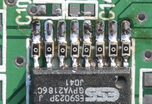

I used eight 0603 zero Ohm resistors to bridge the gap to the pads for the ES9023 that are spaced too far apart on the beta PCB's. I had a lot less trouble doing it that way than when I tried to copy Daniel's strategy using tiny snippets of wire. Don't worry, the flux will get cleaned off once I'm done with all soldering.

The 0R trick next to ES9023 is brilliant! I have kapton tape if I remember to send any to the USA beta people [remind me when we chat].

@grufti: very good work around! Looks much better than my wirework ;-)

I could use 30Ga wire-wrap wire but the 0R would be cleaner so... "it's only money". A sliver of Kapton tape...

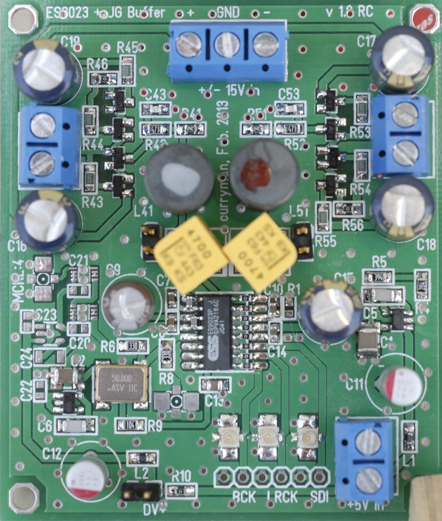

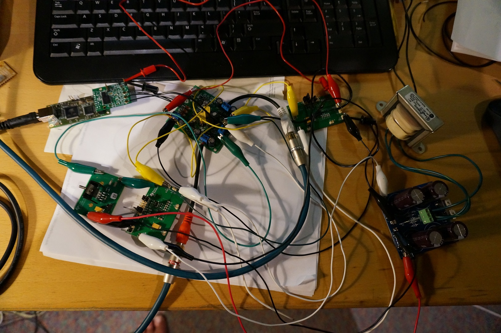

Beta PCB built up
Done! Almost all parts match the BOM value exactly, but size and type are sometimes what I already had lying around. This configuration is meant to run asynch on data from a USB port.
Now I'll have to come up with a power supply and then hopefully music.
Please let me know, if you see something that looks funky to you. The more eyes the better.
The 18.7K?
R to ground just after the coils is confusing what value.
Thank you for checking things so closely. That resistor is a 17.4 kOhm Susumu thin film 0603. Mouser part #: 754-RR0816P-1742D24C. I'm not sure why it reads 24C, if I can make that out correctly. It measures 17.4 kOhm. It also happens to be a good match for my inductors. I picked two from the lower end of the distribution.
Thank you Daniel, Joachim, EUVL, Abraxalito, EssTech... the list goes on. No debugging needed.
Clean, clear, harmonious sounds right from the first second after power up. It will be some time before I get around to measuring its performance. Maybe I'll should save myself the effort and wait for the second version, which is coming anyway. There is absolutely nothing egregiously wrong with it. Very nicely done.

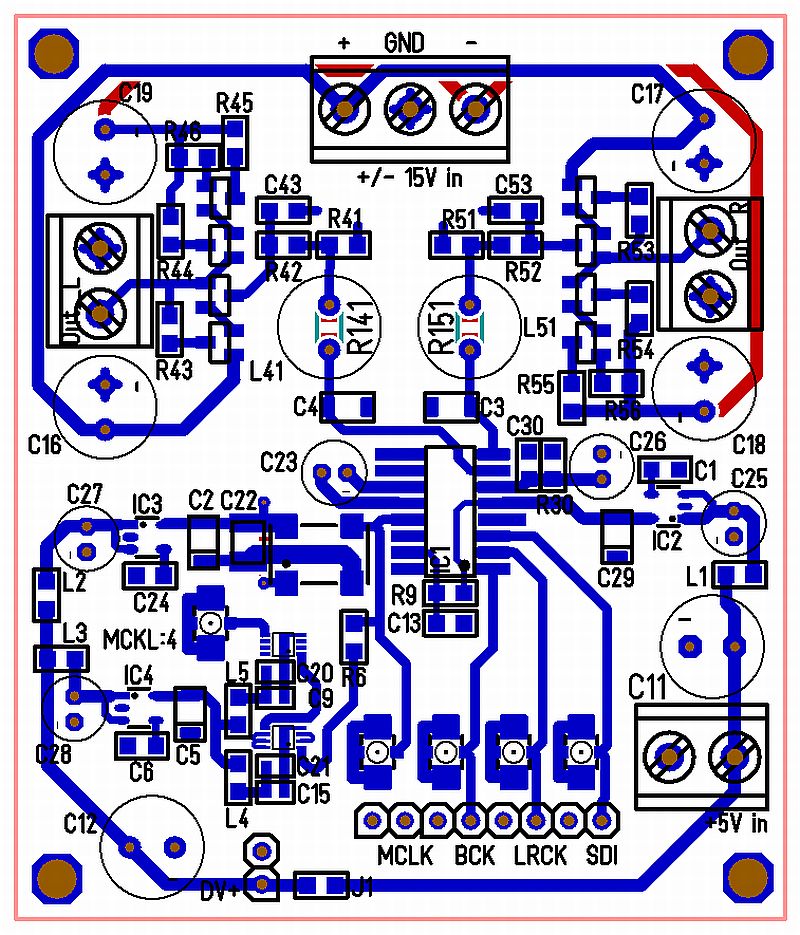

Second version makes good progress. Please find below a teaser...
Will post some more information soon
GND is not routed yet. At least not on the board but only in my head ;)
