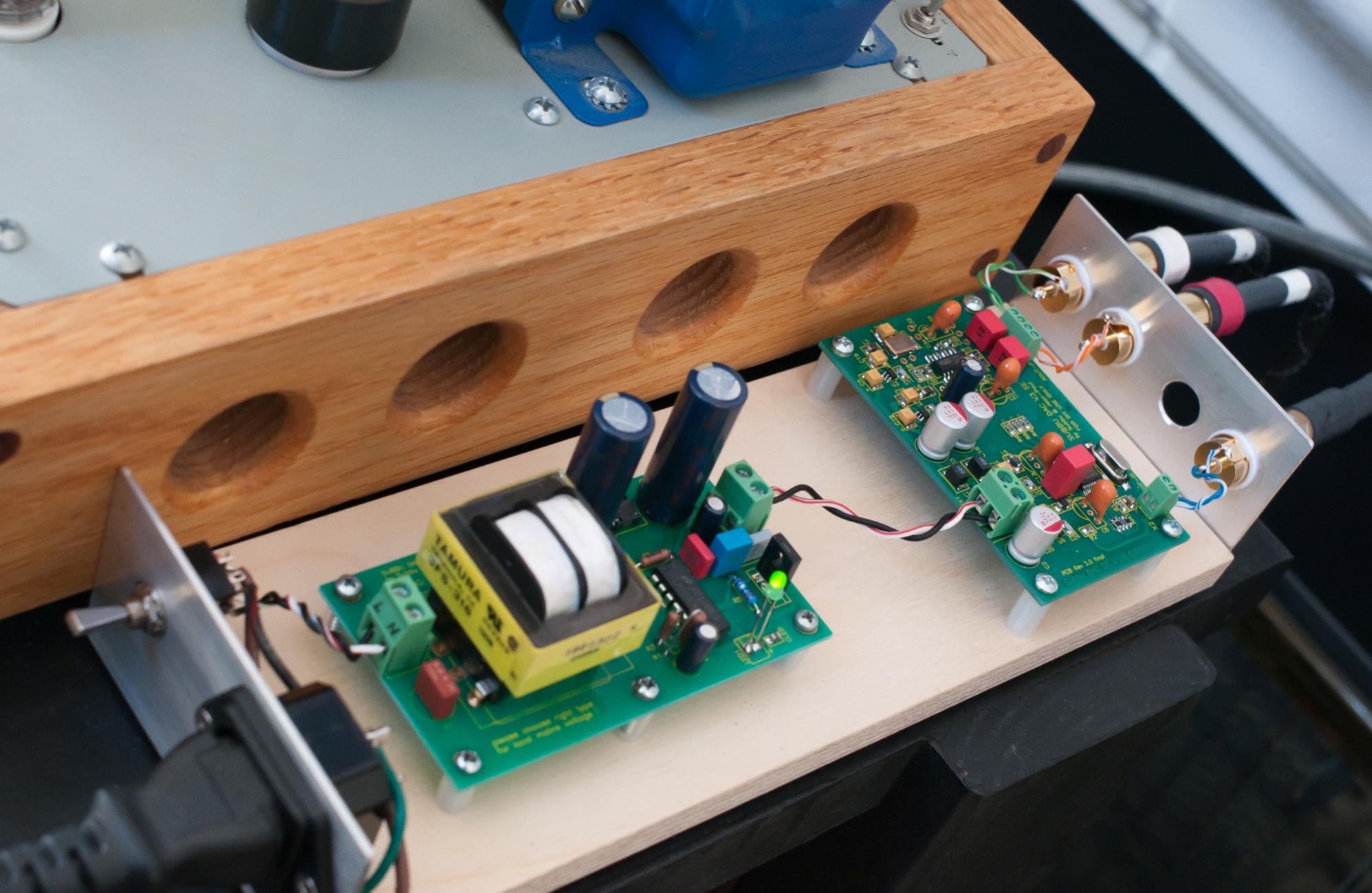

One more SB Dac to sing
I just finished the dac and hook up to the CDP at the moment because I don't have a USB to SPDIF converter yet. The pads for the Q2 were tight and the WM8804 needed to be patience, dial in the correct soldering temperature and good quality of wick to remove excessive solder on the WM8804. Thank you JP and SB to make this GB happen.
By the way, anyone can recommend a decent USB to SPDIF converter?
Sidney

Just thought I would post a pic of my completed DAC. Fitted into a Hammond case (just).
Sounding superb from the off, but I have not had a chance to do any serious listening yet.
Out of shot to the bottom left are the input (BNC) and output (phono) jacks.
I used a combined switched & fused IEC inlet - A tight fit as can be seen.
