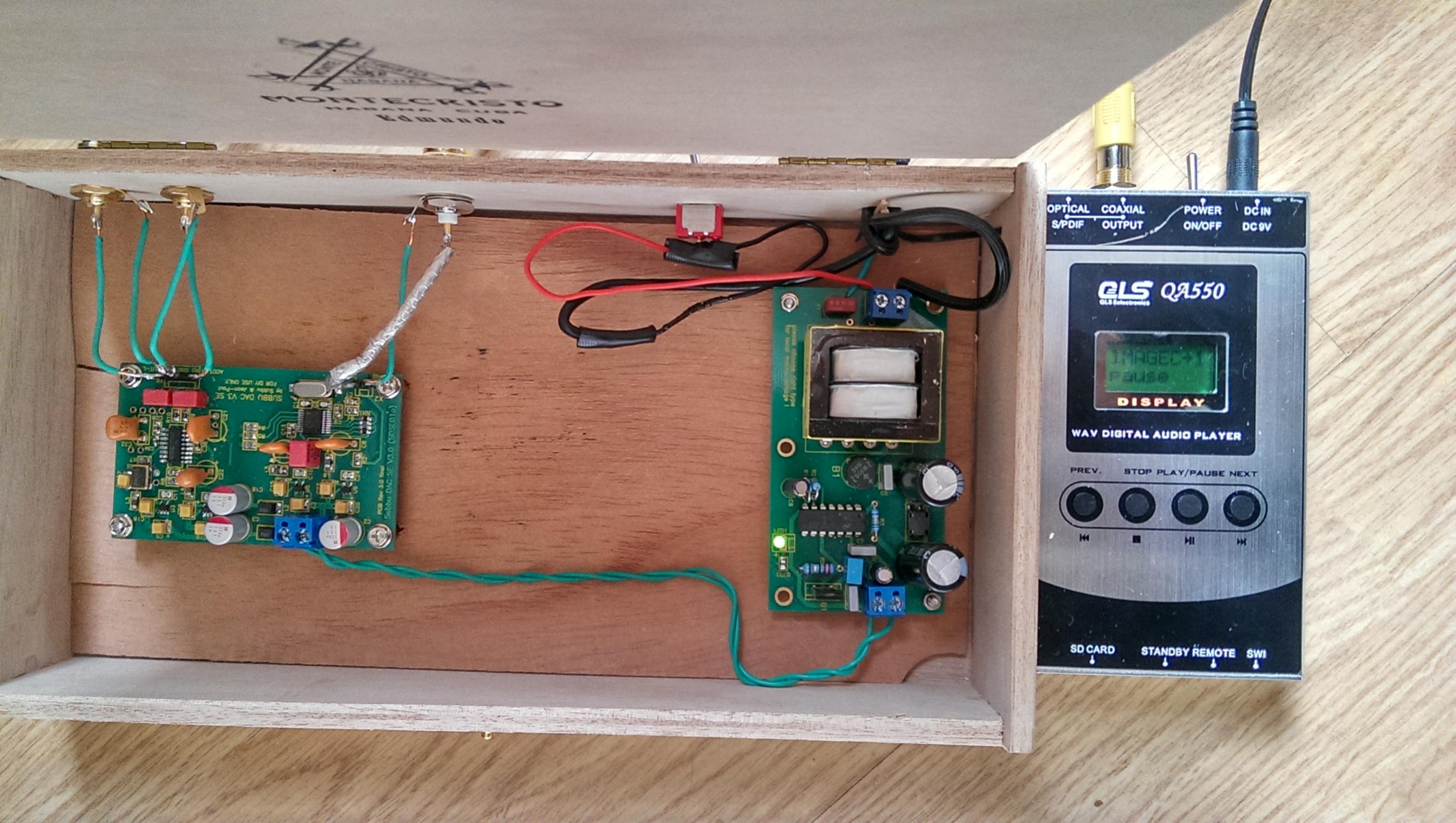

Another DAC is singing right now!
This is my first DIY dac and: it has been difficult but satisfying :D
It didn't work the first time, so I was worried for Q2 :( After, I checked the voltage on ES9023 and WM8804 (thanks atapi!) and everything matched within 5%
Finally, it was a dry joint on wm8804 pin 2 (the sw mode pin, if I'm not wrong)! After that, it started to play :)
Thanks to JP, Subbu for the design & GB. Thanks to Phil for the parts GB.
You struggled but you are still on your feet and succeeded. How does it sound ?

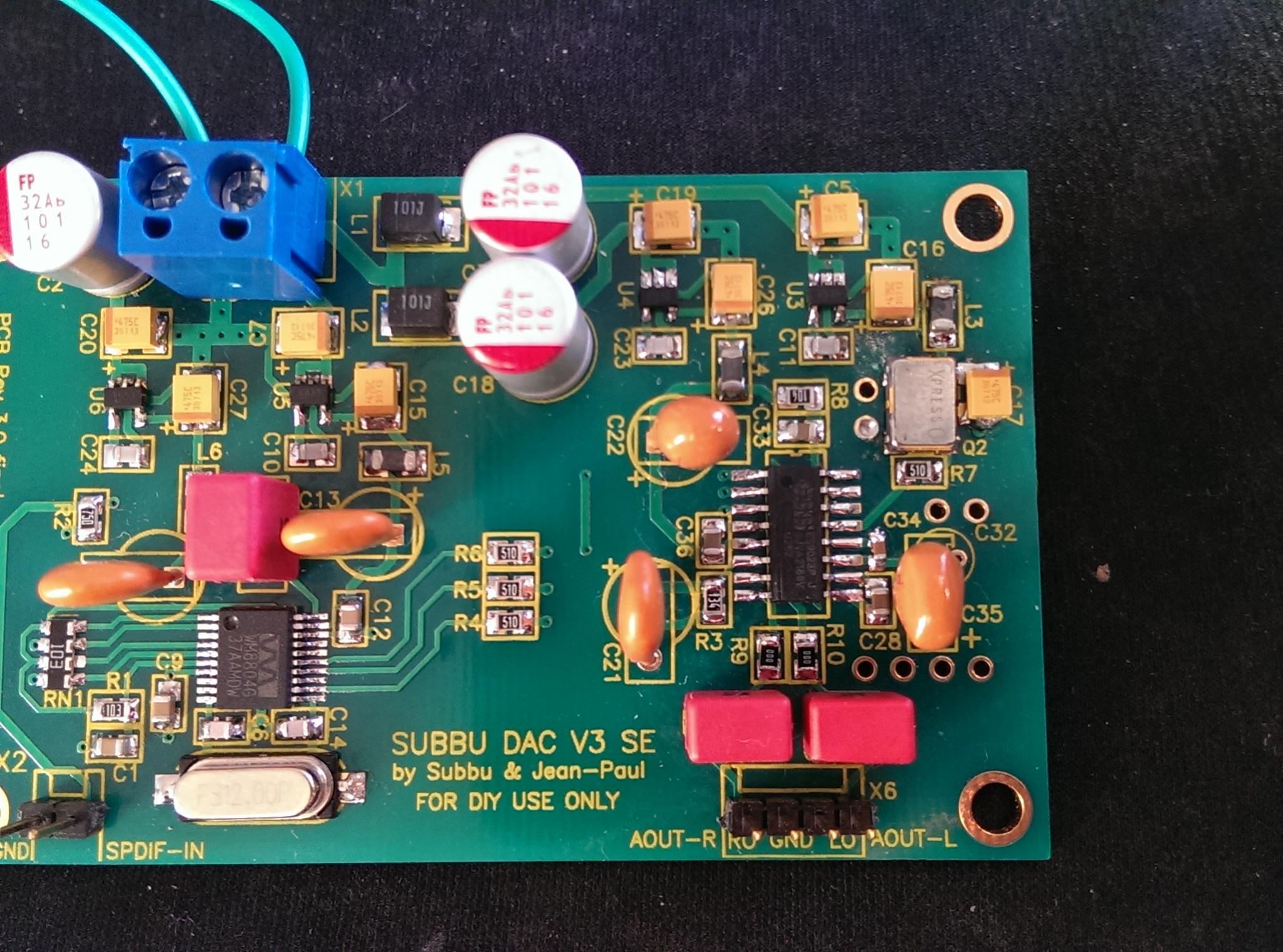

got the dac working just fine for the past few days now, today i inadvertently touched the ground and positive spdif together and now i can only see the power supply supplying a very dim light when it is turned on. i really don't know where to check where that short is coming from, it's on the dac that's for sure but where, any help would be appreciated, thank you.

The gurus might better advise you, but I'd check l3, 4, 5 & 6 first to see if all is OK to that point. The read sheet in the first post may be helpful. If you look at the schematic from the "l"s back to power in you can see the power path if needed.
taught would post photos, least try....
Hello, I would check:
- U3 & U4 pins continuity (with no PS): from the photos... it seems that a short could be there.
- RN1, third resistor from top: it seems that the right pin is not well soldered.
- of course, I do not think that an occasional short on the input spdif made a problem to the DAC. It was just the event that triggered a already present problem...
go figure, started working again like nothing ever happened, surely there is someone on the board not cooperating, also might have filled up a component with negative charge or something but will check for bad solder that might just be the case for this stop and go.... thanks guys much appreciate your output.
