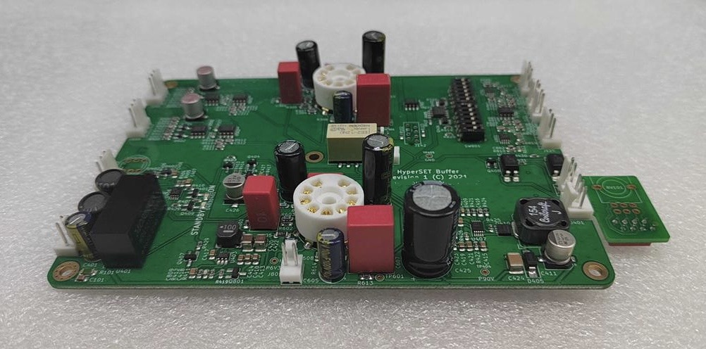

Ok,
I'm planning to build the Nilai 500 DIY stereo kit, but with to separate power supplies to get the maximum from the modules. The same as 2 separate mono blocks but in one case. Should I be using separate power supply for the HyperSet board or use the power from one of the supplies?
This is the PSU I recommend to use with the HyperSET. It’s a universal 25W class AC/DC 12v 2.1A. Model EPS-25-12.
https://www.digikey.com/en/products/detail/mean-well-usa-inc/EPS-25-12/7703153
I have also used wall plug Wall wart type 12v 2A ones from Amazon with success.
They will come stock with matched NOS Russian 6N1P tubes. You can install your own E88CC’s or 6DJ8’s as all are compatible.
They will be preconfigured to bypass the external volume pot. If you wish to use the volume control, there are two small SMT jumpers that need to be removed. I’ll write all this up in a users manual. Also details on how to use the on/off switch and how to trigger logic on external amp (open collector logic).
A good 12v PSU to use is the Meanwell EPS-25-12 universal open frame 25W 12v supply.
