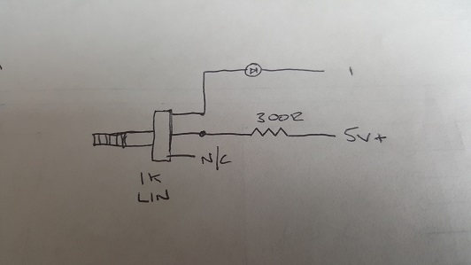

The pots have landed so heres the results for just the ldrs, not sure if i should of connected the third leg on the pot but the resistance didnt go very high on any. 3 of them went from their lowest value (which ive already stated) to 270-350 ohms, the dodgy one only went up to 100 ohms but it stays around 200 when powered down. I havnt checked the board yet....
Basic criteria for good LDR:
1. At 10ma, the LDR reads < 40 ohms (red dot) < 60 ohms (non red dot).
2. As current is varied (move the pot) the resistance changes appropriately and smoothly.
3. With power completely removed, the resistance is > 1 megohm.
If an LDR meets all of those standards, it's almost certainly good. If not, you should replace it.

Thanks Karl. Then if the resistance values i show are ok it looks like i still have just one bad ldr as it doesnt go high with power off. i will check the board over the weekend, its out and ready but im off to catch ELO at the O2....
