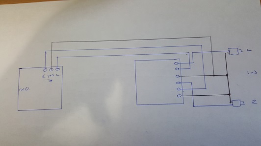

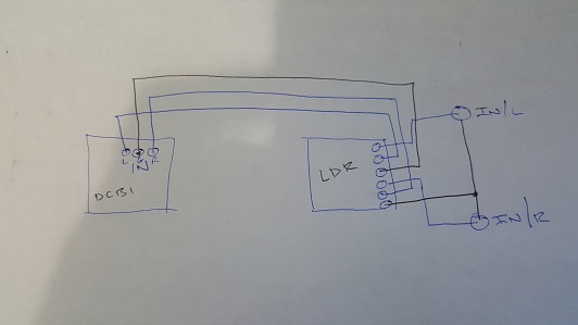

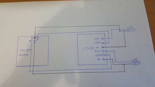

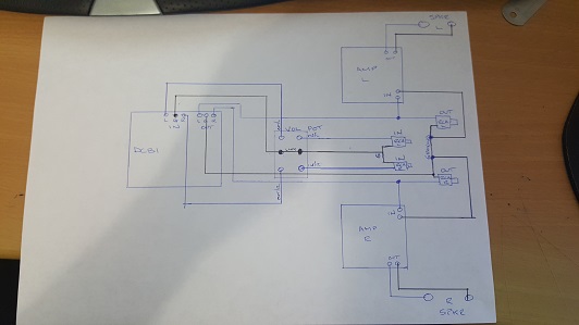

Back again! So i just tried to swap my volume pot for the LDR, bit of a disaster, massive buzzing, exact same buzzing i got when i accidently swapped the input and output jacks around on the DCB1 so i think its just a ground issue. Now ive had a few beers so its getting hard for me to focus but here are my wiring options. Sorry about the pics. looks like i will have to upload and edit using the file manager......
The first pic is my working circuit, dead silent so no probs, the second pic is how i implemented the LDR, I was hoping it had a common ground, should of checked really.... anyway i have one wire for my ground on the buffer so i thought it might be ok, obviouly not. Third pic is I guess how i should of done it but this involves cutting a ground/return bar between my inputs and fudging 2 cables onto the DCB1 input. After doing the drawings, is the third pic any different from the fourth? Instead of 2 wires going to the buffer i would have 2 wires going to my return/ground bar. I can see that on the BTFSystem drawing you have separated the ground on L/R inputs but with my buffer they will join together anyway?
Ive put the pot back on for now so i can relax for the evening, hopefully i will sort this tomorrow.
