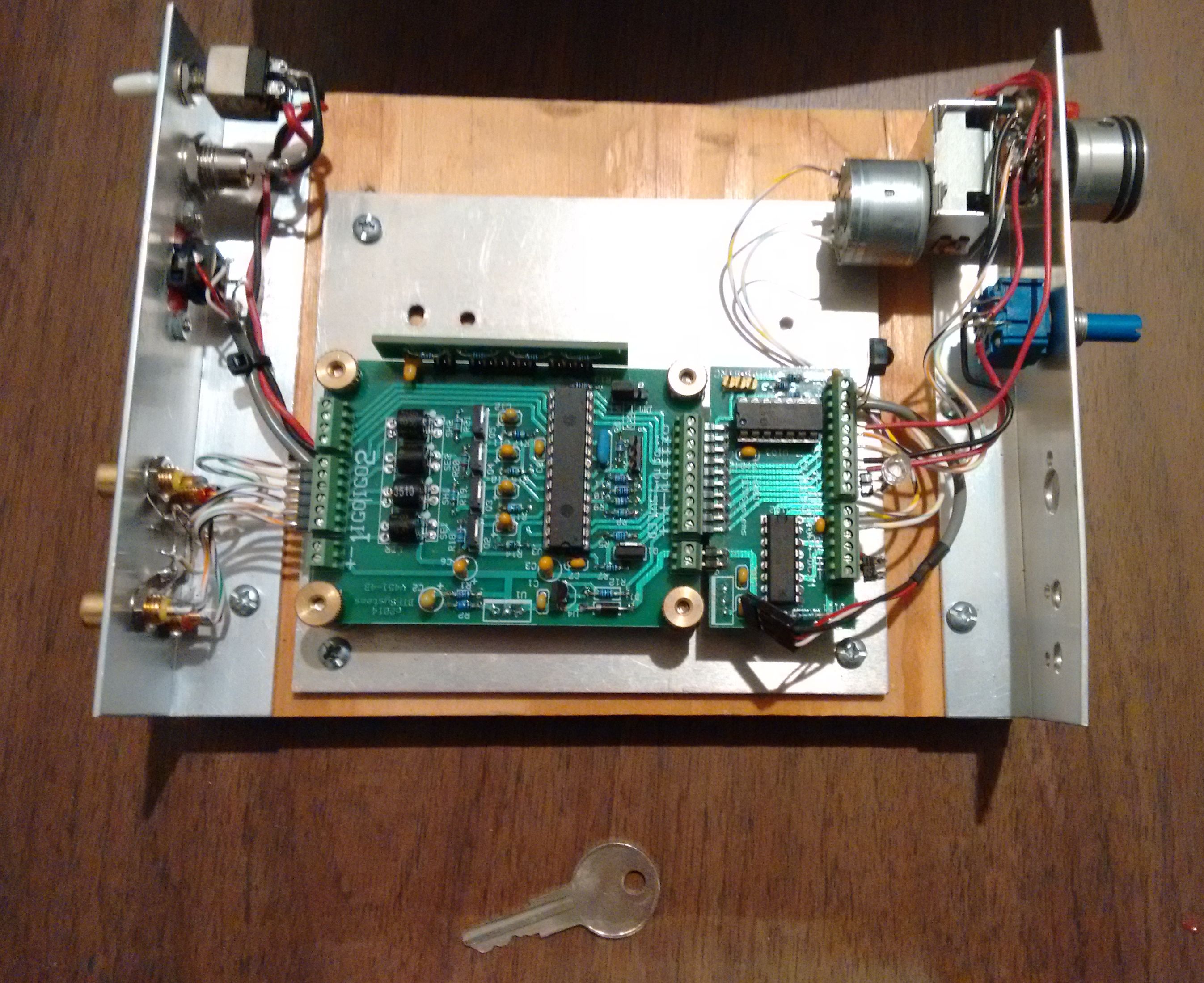

1. Plans for input switching function -- yes, I plan to do that, and using pure LDR control if at all possible.
2. The RE/IR/Display board works only with a rotary encoder -- the "RE" part of the name. There is no H-bridge on this board.
3. I've already built a prototype motorized pot front end (see attached image of my prototy[e). The design is two years old, I'd do it differently now but the concept is there, and it worked just fine. The balance could also be motorized if you wanted it to be -- the H bridge chip I used will handle two motors.
I switched to rotary encoder because the opinion on the thread at the time preferred it to motorized pots. I can see this as a way to upgrade an existing amplifier, but starting from scratch an encoder might be a better choice.
If there's enough interest I can make a motorized pot front end happen . . .

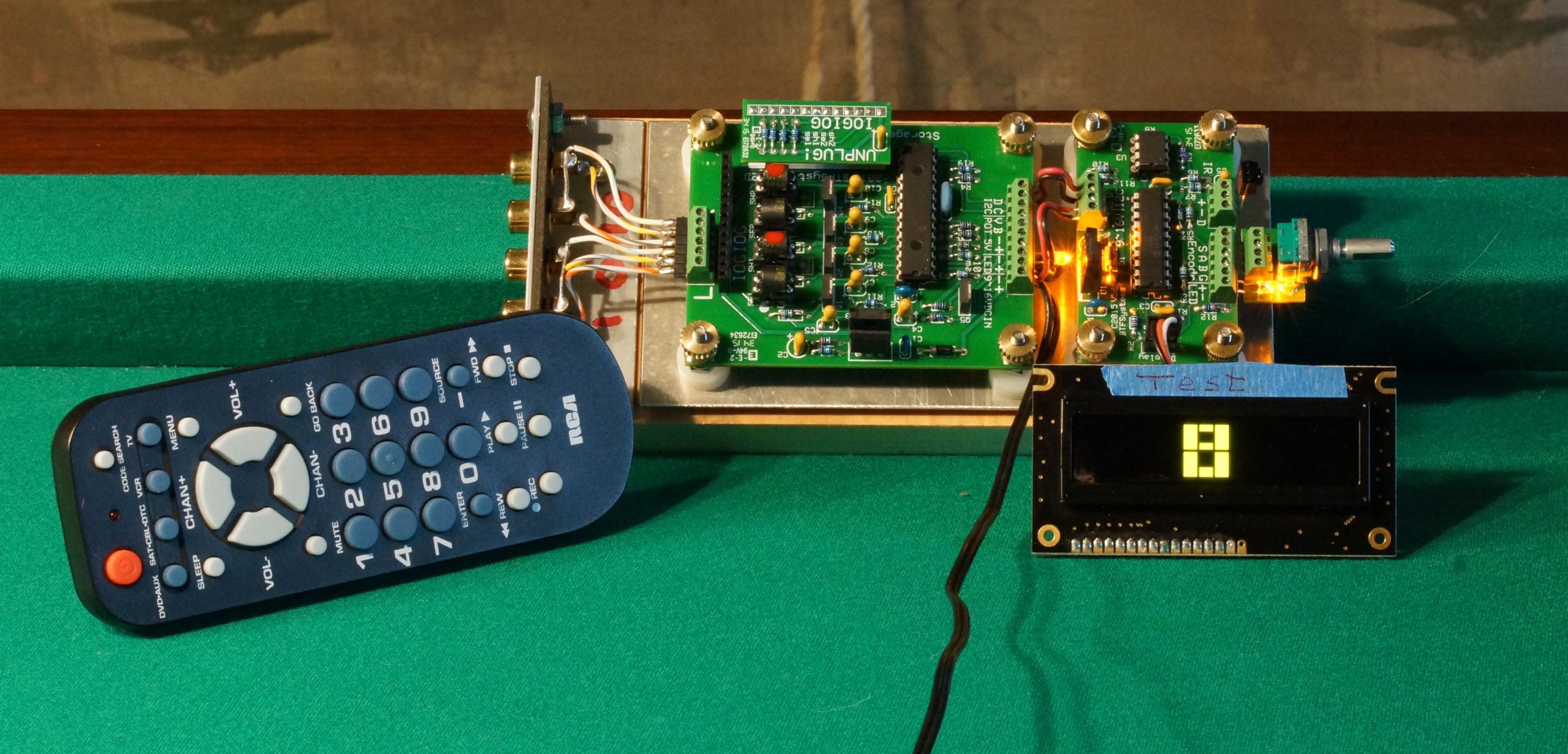

Someone asked about how difficult the wiring would be, the answer is: "dead simple."
This image is of my test rig -- the complete system with rotary encoder and IR receiver and OLED display connected to the LDR controller module.
The LDR controller module wiring consists of the connections to the audio jacks at one end, and +12VDC and two wires to the RE/IR/Display board at the other end.
The RE/IR/Display board connections are to the LDR board and +12VDC on one side, and the IR receiver (barely visible above the rotary encoder) and rotary encoder on the other side, plus the plug-in OLED cable.
That's it.
The LEDs are inserted for testing, they are not required when the OLED display is connected.
The remote controller is an inexpensive generic universal controller which does what's needed -- volume, balance, mute.

The wiring does look about as simple as simple gets.
So where the wall wart connects to the LDR controller board, you also have 2 wires coming out of that board(in parallel with the wall wart wires) going to the "9-16VDC" connections on the RE/IR board to power it?
I also see the 2 wires near the top for the +12VDC connection.
Just as a suggestion...you may want to take some close up photos of the wiring connections on your test rig for those who still may be unsure or have questions.

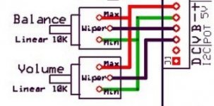

I uploaded two wiring diagrams to the BTFSystems website -- one shows the most basic circuit using 10K linear potentiometers and the LDR Controller, the other shows the wiring for the complete system to include the RE/IR/Display Controller board and circuitry.
The standout feature -- both systems are extremely easy to wire up.
Also uploaded the complete calibration procedure using either the OLED Display or a simple LED indicator. Also very easy, and very seldom required.
In this drawing, are the pots' terminals up or down?
In a simple circuit where the pot is controlling the input of a audio signal(I know we are controlling voltages here instead) with the terminals facing down like on a PCB, the terminals you have labeled as Max. are typically grounded and the terminals you have labeled Min. are where the audio enters the pot.

Oops! I had a look at mine and it's connected as per the diagram with the +5 volt connection to the pins adjacent to the 'max' label as you look at them from 'on top' position - initially, I had them connected incorrectly (the other way) and simply changed the wires at the terminal block instead of changing the wires on the pots - same thing for the balance pot
