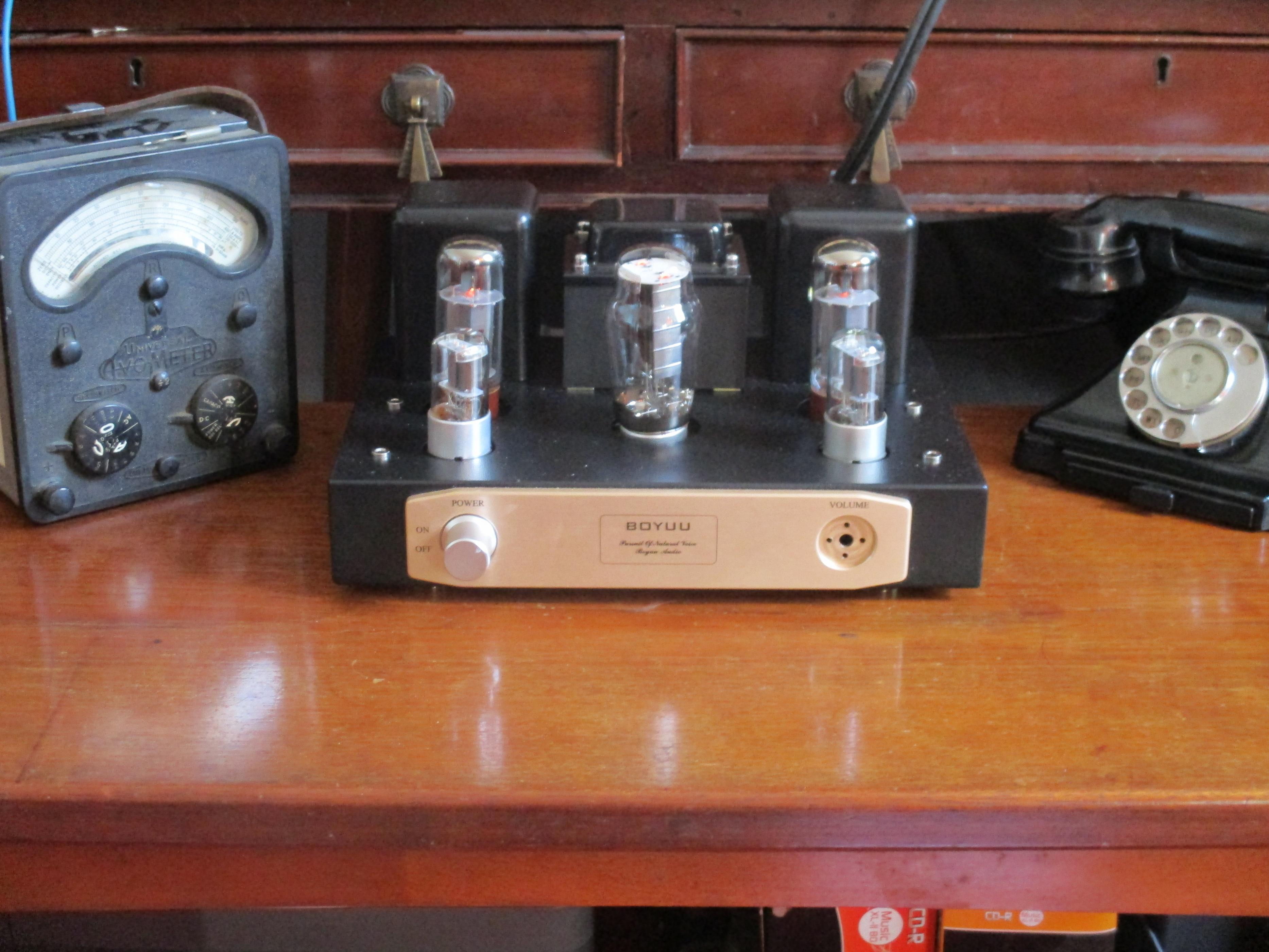

Below is a picture of the amp along with my state-of-the-art measuring equipment. ;-)
I'll now set about building a second amplifier the same; only with paper-in-oil caps etc as suggested in the thread. If that works well I'll do the same mods to this first amp.Then I will use them for treble and midrange in a 3-way active configuration with my old transistor amplifier driving the bass.

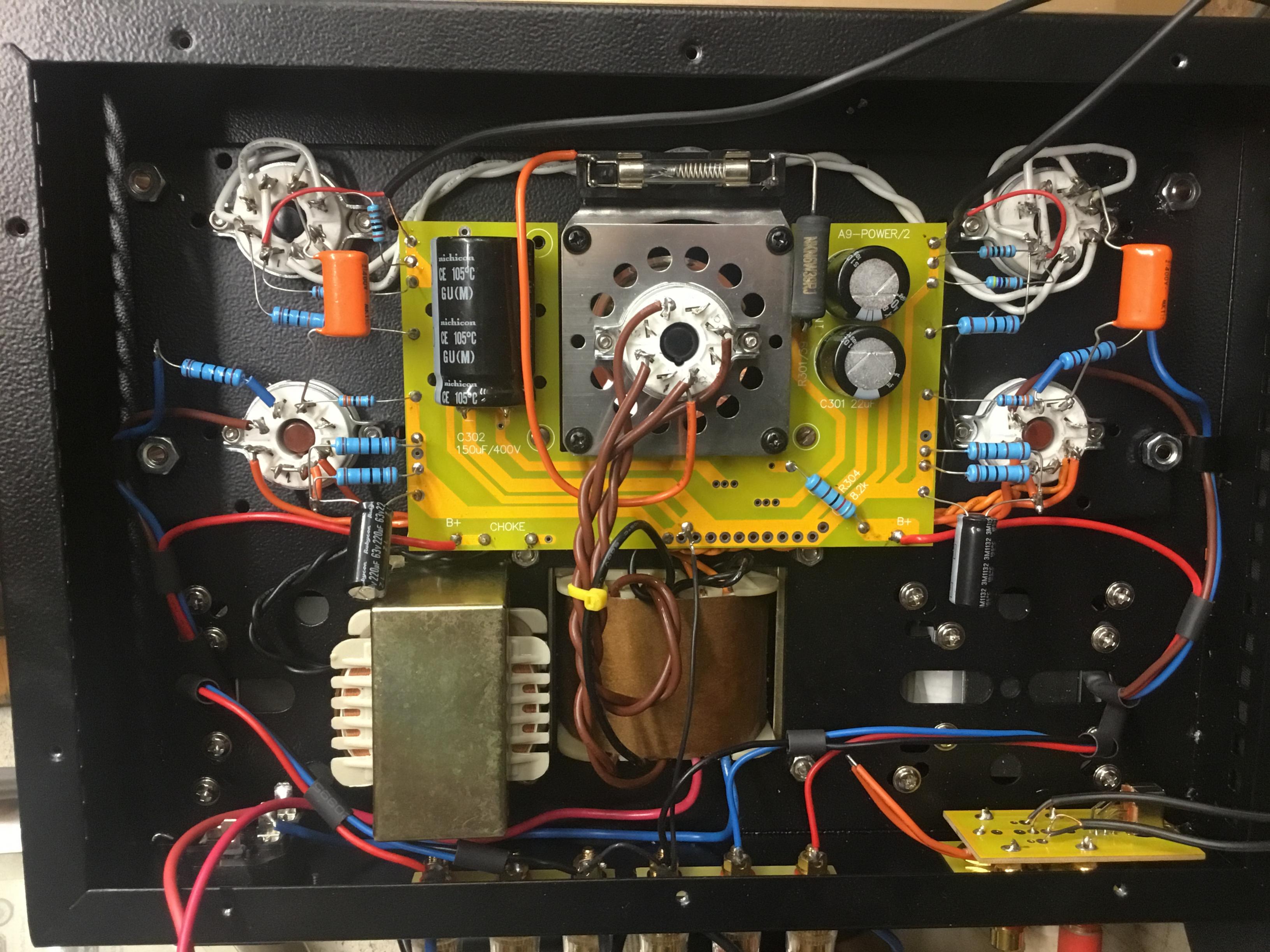

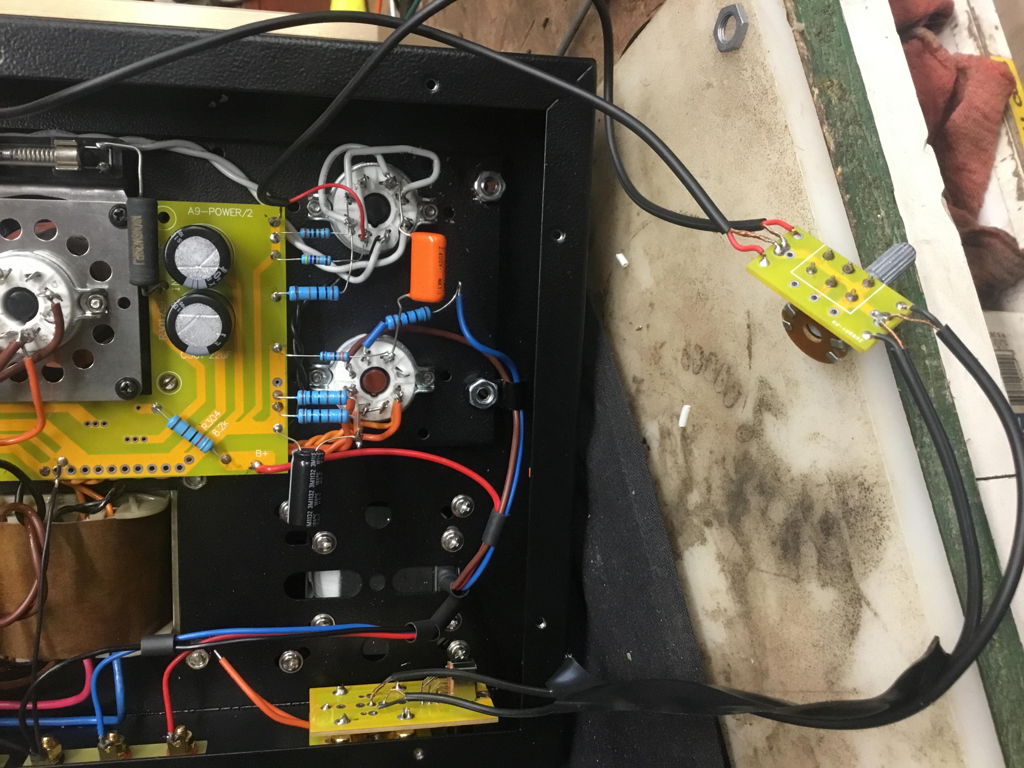

So with the guidance of this forum I put one of theses together without fire flame but yes the HUM. Thank you to the guys who posted a lot of the answers it took the black and blue marks away from my head, but that dam 60 Hz HUM. I will try this week to do the mods that are said to correct it. I have to go raid Vintage Hi-Fi of Pittsburgh’s parts bin to get what I need, he has all the needed parts sitting on the shelf. Set 2 pics of how I put it together. I took the power switch out and the volume just to see if it had anything to do with the HUM.
It hums just like a 75kva transformer and I have the simple answer wht. It just doesn’t know the words.

natoe,
Are you saying that the transformer Audibly Hums, like a transformer on the power pole outside you house?
If the amplifier works properly, with proper voltage and current draw, then it sounds like you have either a poor quality transformer, or one that was dropped which loosened the laminations.
Or, the same could be said for the B+ choke if it was dropped and disturbed the laminations.
Or are you saying that there is lots of hum in your speakers?
What kind of cap are you going to put on the 120V power line? What kind of connection.
You can not stop hum that way. But put a cap Across a 120V power line, and the only thing that may happen is an explosion or fire.
The 0.1uF cap across the power switch does not increase, nor does it decrease hum when the switch is closed.
