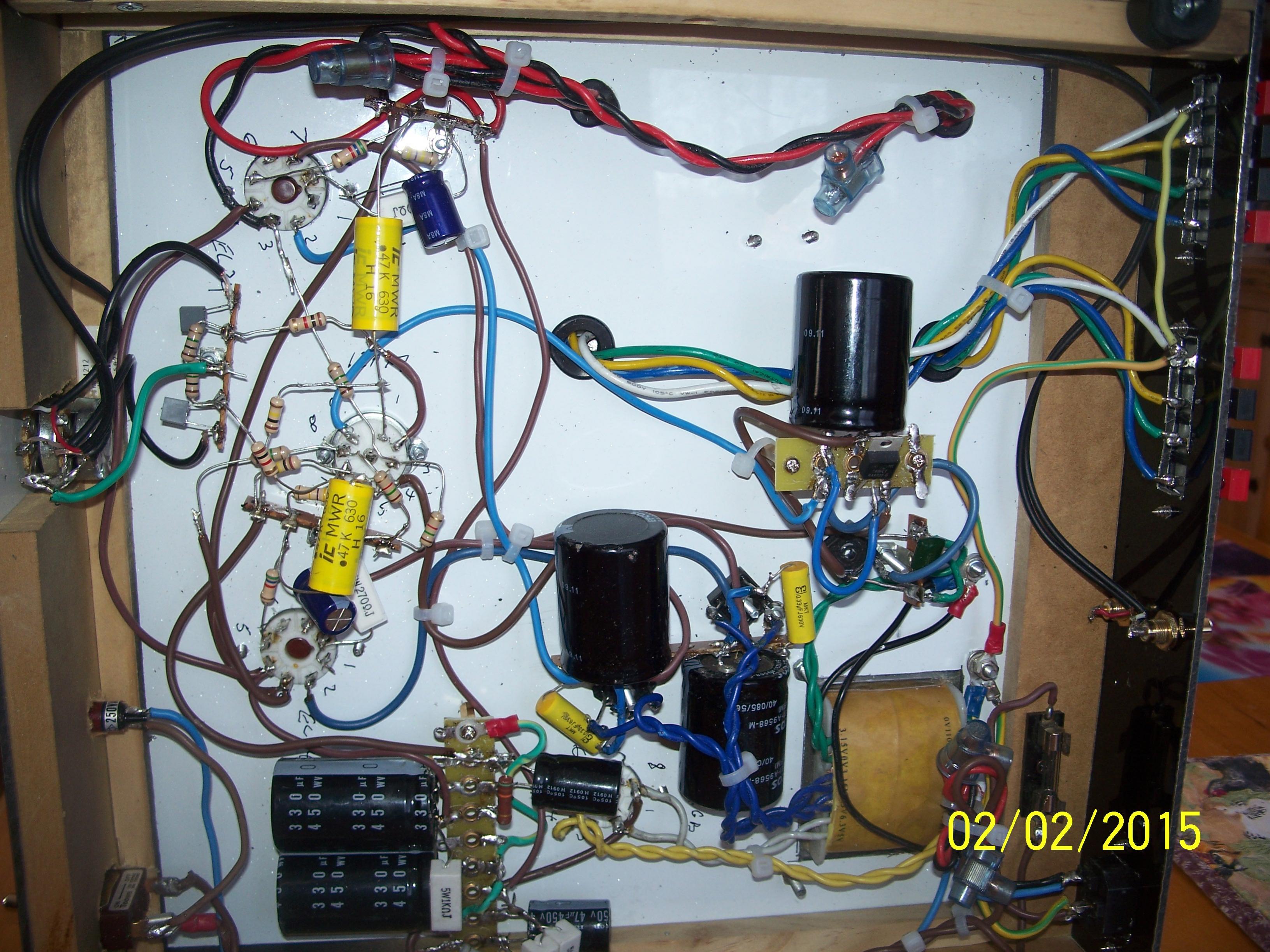

Hey guys,
I bought the boyuu a9 three years ago. I struggled alot, because I hadn't any clue how the amplifier works.
Now I wouldn't say, that I know anything more than before. :D When I turned the amplifier on a humming sound gets louder. When I use the pontiometer to control the volume I can control the volume of the humming noise. The humming comes without any source. When I try to play some music, the music sounds really bad when I raise the volume. The Lepai LP-2020A+ sounds way better. I try to use the boyuu a9 with my Heco Celan 300 on 4 Ohm.
I think there many failure in my cable management. Would you guys do me a favour and give me some hints? The yellow wire from 7 and 2, which is connected to the other tube; is it important that the yellow wire from 2 goes to 2, or doesn't matter?
Also my on/off switch isn't working. Both states are "on". When I check with my multimeter I got continuity on both positions.
Best regards! And I'm, sorry for my crappy english.
René

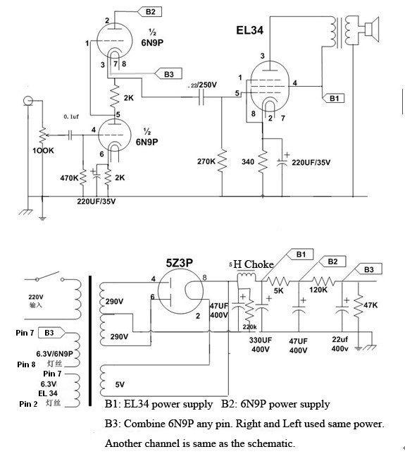

If there is no center tap on the 6.3V winding(s) that you can connect to ground, then . . .
Do not ground one end of the 6.3 winding, instead connect two 100 Ohm resistors, each resistor to different ends of the 6.3V, and then connect the other ends of the 100 Ohm resistors to ground (that forms a virtual center tap to ground).
Then make sure that the B+ secondary center tap connects directly to the minus (-) end of the first filter cap.
Do not connect the center tap directly to the amplifier central ground point, instead, connect the minus (-) end of the first filter cap, and from there, use a separate wire to connect to the minus (-) end of the second filter cap; then a third wire from the second cap minus (-) to the amplifier central ground point.
PCBs make it harder to modify an improperly constructed amplifier to correct ground loops that cause hum.
The RCA input jacks also have to be done properly, that is another post (later if you need info on that)
My worst vacuum tube amplifier has 500uV hum (it has a no-no . . . a magnetic steel chassis), all the other amplifiers I designed and built have less than 100uV hum. I learned so many tricks along the way, to get the hum that low.

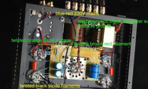

Do you mean all of them? So the both orange wires (6.3V/AC 4A, EL34) and both black wires (6.3V/AC 2A 6N2J)? Should I connect them to the groundboard of the pcb or do you mean the real earth of the socket, which is, in my case the green wire? Thank you for your upcoming answer. :)
#Edit.## now i googled a little bit. The center tap could be a wire. But I think as 6A3sUMMER mentioned, I haven't got a center tap on the main transformer. You can see all of my wires in the both pictures. :)
@6A3sUMMER before I raise the iron I'd rather ask before. Do I understood everything right? So after the 100 Ohm resistor, I connect either pin 2 or 7 and the ground of the pcb and also the other EL34? Should I do the same with the other 6.3V (black wires | 2A) for the 6N2J?
I absolutly don't get the second part. Because I don't know which one of the wires and caps are the right.
The brown thick wire of of the transformator is the secondary center tap, or? The first filter cap it the black one which is directly connected to the socket? And the second filter cap the blue ones on the pcb? Or is it the second black cap to the left?
@PrebenK can you make some marks on the bad solders, I doesn't know which one is bad. Two or three are enought, than I can check for more!

Yes, both have to be earthed/grounded in one way or another.
I don't want to belittle the proposal/advise 6A3sUMMER gave in any way (creating a virtual ground with two resistors per 6.3 V winding; your drawing of it is wrong b.t.w.) but in my experience this is not necessary in most cases when dealing with a two stage amplifier like yours. You could first try the simple way (only two wires have to be added, one per 6.3 V winding). If that doesn't work, you could always try the virtual ground.
For the supply of the EL34's the simple way would be to solder a wire between ground and one of the two pins on the socket where an orange wire 'meets' a yellow wire (it doesn't matter which of the two pins you choose).
Than do the same for the other winding. So solder a wire between ground and one of the two pins where a black wire coming from the power transformer 'meets' a black wire going to the other tube socket (it again doesn't matter which of the two pins you choose).

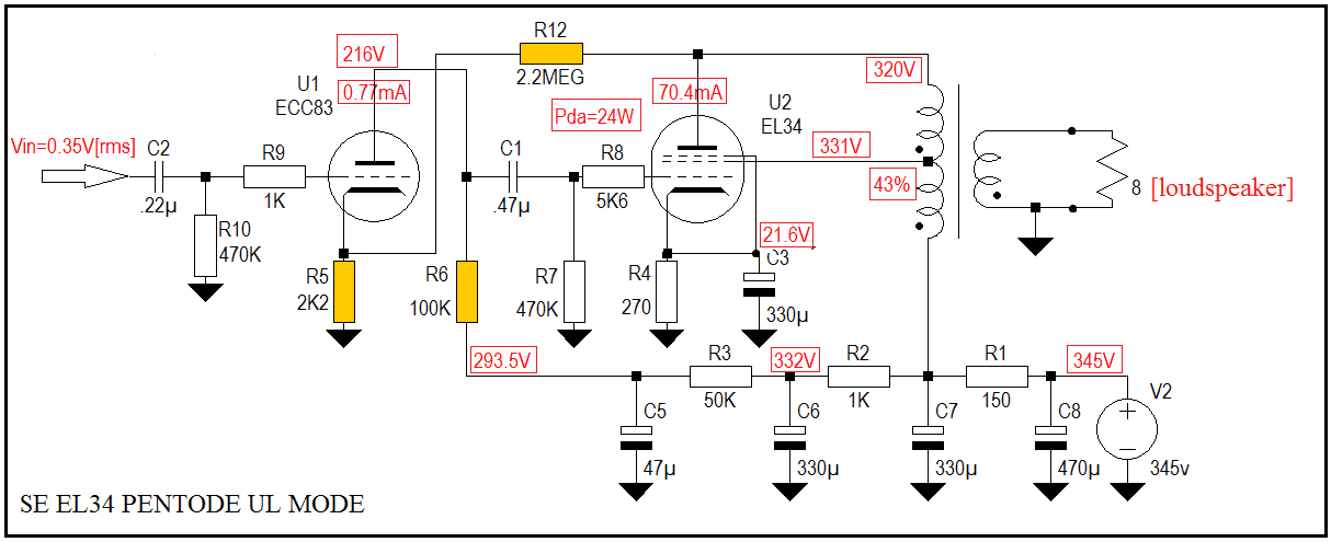

1. The idea of connecting a center tap, or 2-resistor virtual center tap to ground . . . is so that the two filament ends will be 3.15V above ground; instead of one filament end at 6.3V above ground, and the other filament end 0V above ground.
2. An input tube that has an un-bypassed cathode can inject power mains frequency from the filament, and if there is higher frequency noise on the filament winding, will very easily inject that noise into the cathode.
An example would be the noise from a B+ winding on the same transformer, that has a capacitor input filter for the B+ circuit.
3. For an SRPP, or other similar floating cathode on the top tube, any filament power main frequency, and any noise on the filament winding will be injected into the top cathode of the SRPP.
So, use the center tap, or the virtual center tap, and instead of connecting it to ground, connect a two resistor resistive divider from B+ to ground. Connect the junction of the resistive divider to the center tap or virtual center tap.
Then connect a bypass cap from there to ground.
The correct DC voltage is found by the two cathode voltages of the SRPP, and the filament to cathode voltage ratings (+ and -), and also how far the top cathode will swing at maximum signal.
There are examples of good voltage selections versus those parameters.
Also, a concertina phase splitter has the same problem, the filament can inject power frequency and noise into the cathode.
The same technique of raised DC voltage, with bypass capacitor to ground, can fix that problem.
Use the technique in number 3. above.
I had an amplifier that really suffered from this problem, it needed the elevated filament mod with resistors and bypass capacitor.
Over the years, I have seen Boyuu original or modified schematics that had un-bypassed cathode parallel input triode(s), and SRPP input stages.
Those can have hum and noise injected into the cathodes.
Some tubes are better than others at rejecting that hum and noise, but the SRPPS should have elevated filaments with bypass caps from the elevated DC to ground.
Just my opinions.
