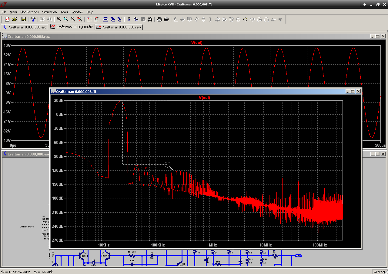

I don't agree. I disagree only in the sense that your model is still one of the best I've seen. Quite possibly, they are the best in the world. I can see it in the fact that their use in the model of the amplifier are greatly increased distortion, from 40 to 60 dB. Therefore, I always try to use your model. I see in your models your work.
The rest, I agree. The simulator gives the circuitry indicative rating "better or worse". I found a border of the veracity of his calculations. I think, that the distortion caused by changes of regimes (collector current and voltage collector-emitter) during the period of the signal. Simulator sees these changes very well. We should only reduce them - for this we need the knowledge in schematic.
What do you mean by the term quasi-saturation?Read it in notepad.
* _kq - My models which have quasi-saturation!
Thanks, your models are very realistic. The data of the distortion schematic (thank you, jan.didden ) are in good agreement with the data of the sound card.20KHz
I used the model library attached. It is mostly hand-made models. Read it in notepad.
TotaI Harmonic Distortion: 0.000014 %(0.000000%)
You need to check the currents of idle 100 mA from each of the output transistors.

The 2nd and 3rd are at ~ -110dB.
These two distortions are ~ -140dB ref signal.
add them together and you get ~-134dB, then add on all the other distortions. what do we get -133db or -132dB or -130dB?
But convert 0.000014% to dB and I get -137dB
That indicates an error of at least 5dB.
What does not add up?

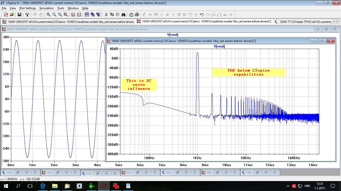

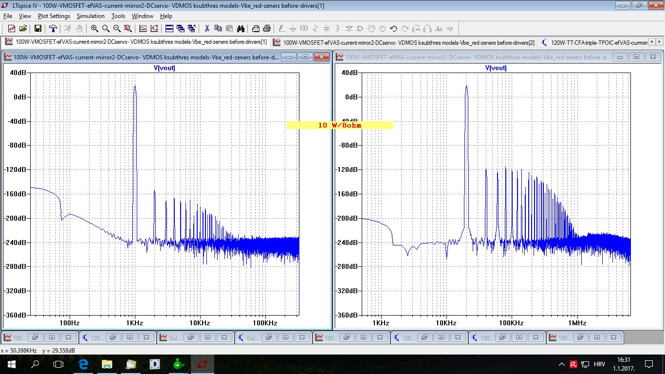

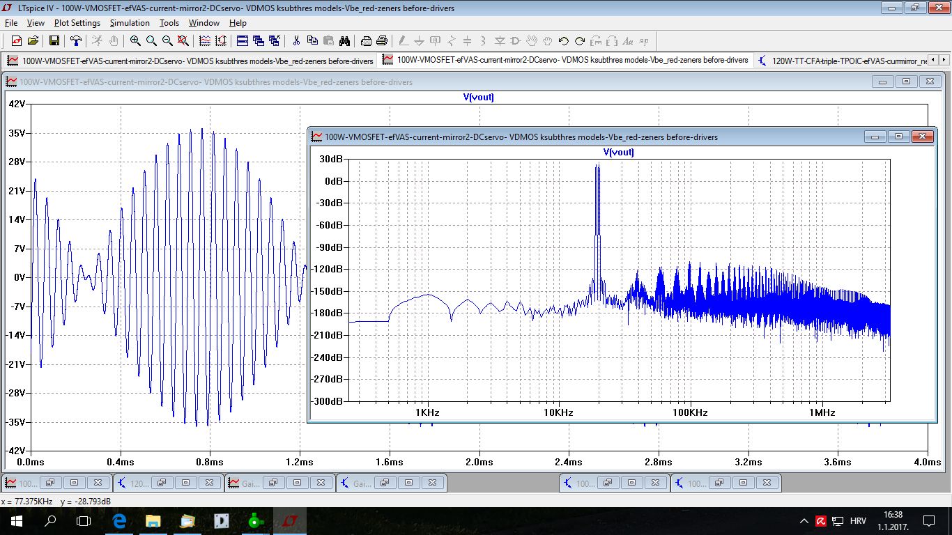

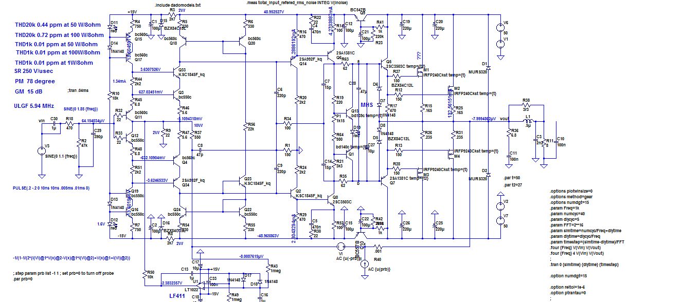

Happy New Year to everyone!
Attached 100W CFA. Simulated THD is below 1 ppm at all frequencies and and all output power (before clipping). At 1 kHz is below zero, or below LTspice simulation capabilities.
The Loop Gain looks as VFA one but it's pure CFA, pay attention how the compensation made, I called it Output Inclusive Two Pole Compensation (I've never seen it used in in any other amplifier). With this kind I am getting best result with distortion and stability.
In my opinion it's not possible to make it simpler with close ti its data.

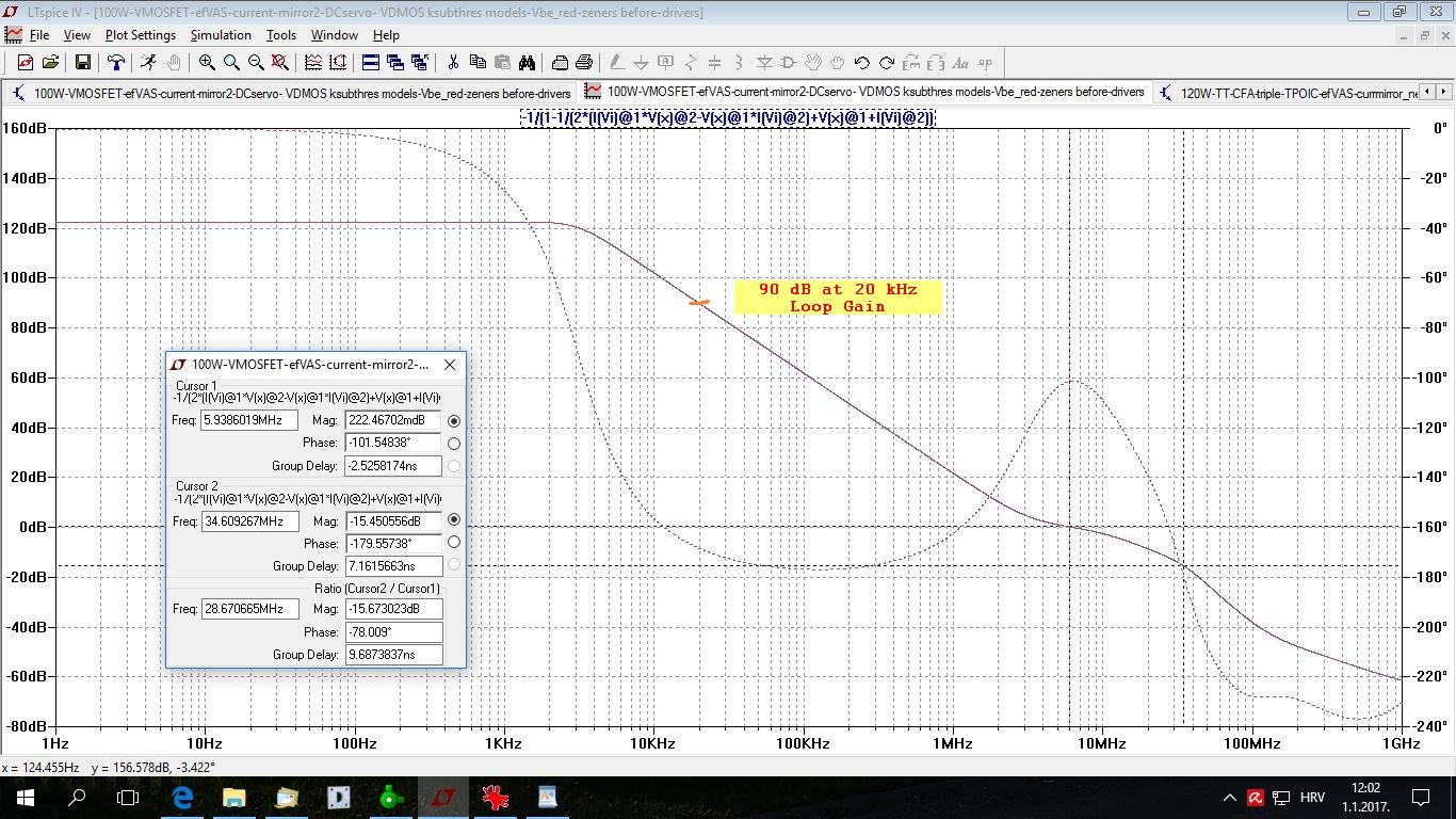

I want to say on the need to harmonize the output and input impedances of cascades. Schematic was posted earlier. Here's a graphic of loop gain of the amplifier in which the high output impedance of the first LTP, and high input impedance of the second LTP:
This amplifier has a second cascade (LTP) with low input impedance:
We can see the loss of 43 dB in the audio band and 33 dB at the frequency 20K. Obviously, this amp has more distortion than the first.
To achieve high loop gain is very difficult, but you can lose it very easily.
