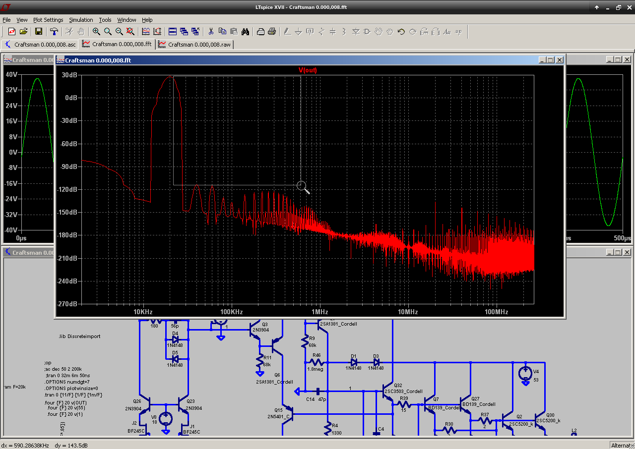

I know that. I have posted a spectrogram. According to my information, the simulator calculates the distortion accurately, since the level of 0.000,1% or more. You have achieved much more distortion, and the simulator is never wrong for levels of distortion at 0.002%. This is a very good simulator, but you can check out your advice to other simulator. It will show the same.

They are the stupid graphic fell between pixels, it's the minus input. This is kind of frustrating for me, years ago I spent hours of my own time trying to show how some simple circuits could get dramatic results and I went to the length of actually building them and publishing the results (always placing everything in the public domain).
I take the model c THD = 0.000,008%
Maybe you meant 0.000008 without the %. I get this at 20KHz:

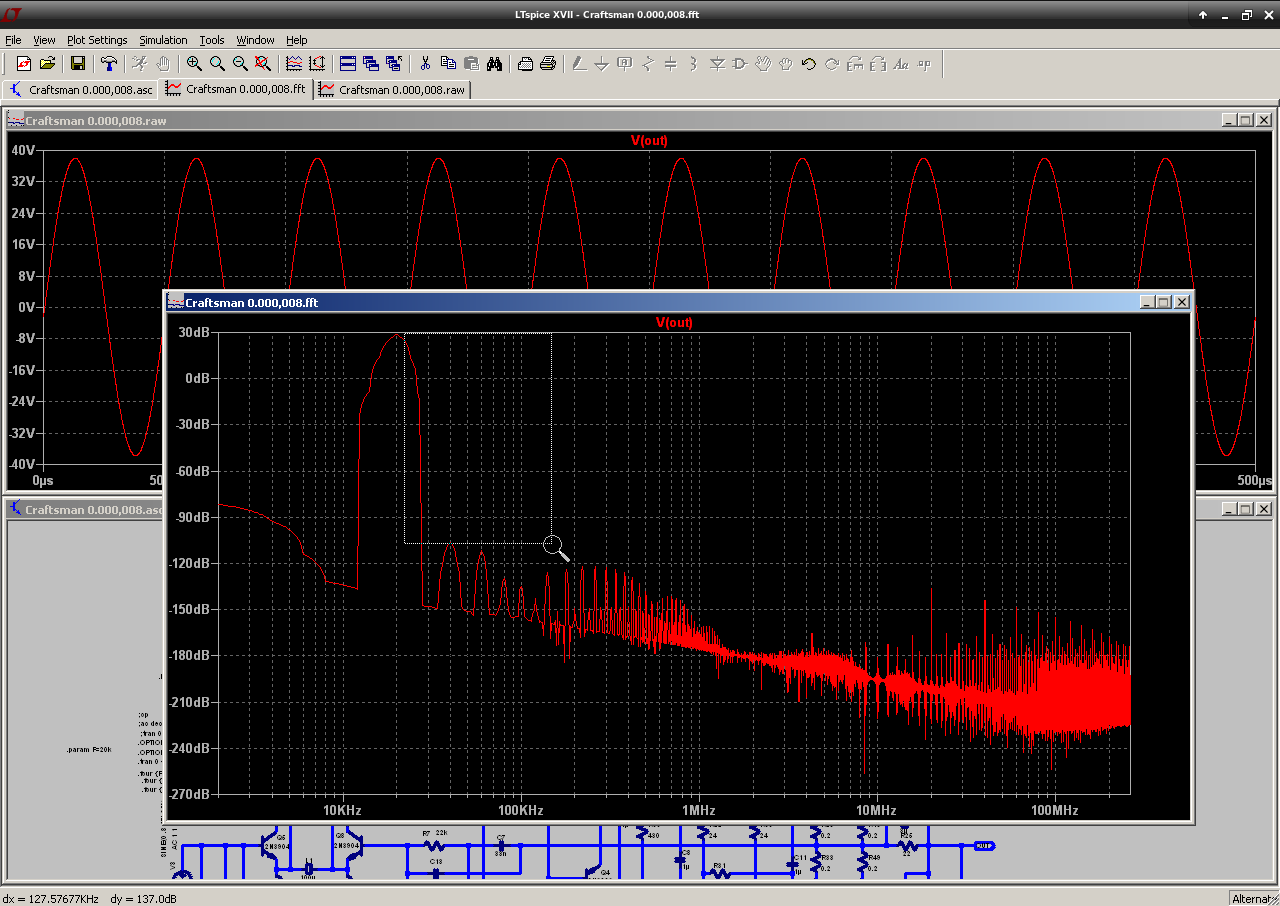

Maybe we use different models of transistors. Maybe too big the DC component of the output.
DC component:0.147388
DC component:0.07435
Sometimes this offset can also increase distortion.

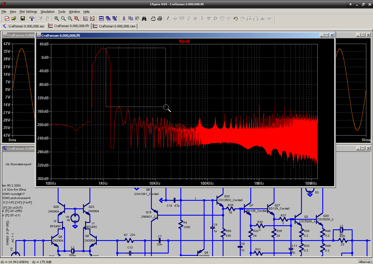

FFTs
1KHz
attachment.php
20KHz
attachment.php
I used the model library attached. It is mostly hand-made models. Read it in notepad.

It's not offset that causes false .four reports, it is drift. When the simulator solves the operating point correctly, there is no drift.
The .four command doesn't use a very powerful FFT window it seems, so it tends to be influenced more by drift than the FFT window when you use Hann, Blackman or Blackman-nuttal windows.

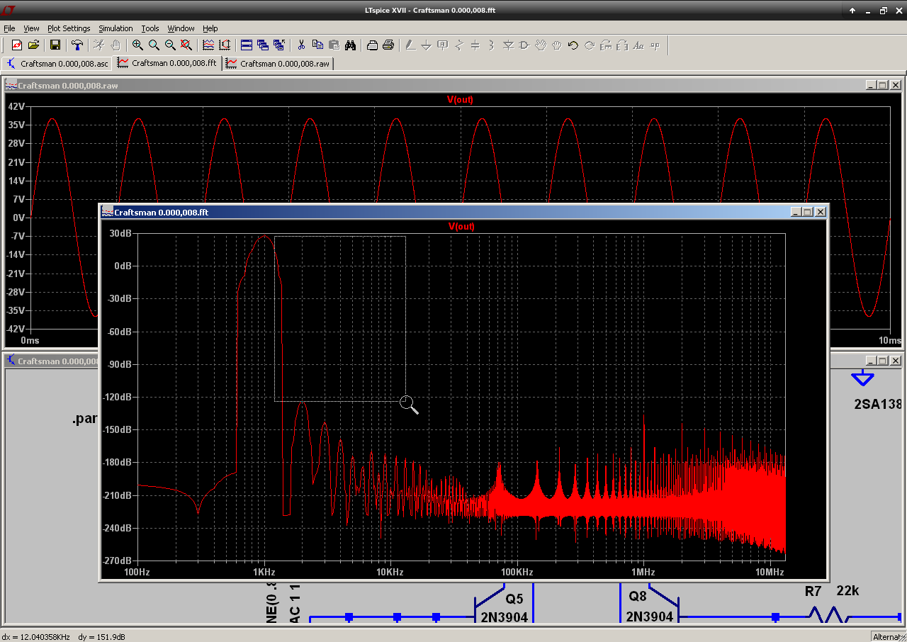

The greatest benefit from this occurs at 1KHz where the majority of distortion does in fact come from the Early effect on Q9. Of course by now all of this is buried in noise and the increasingly impossible job of the prototype designer is nowhere near finished.
-151.9db to -175.8db is a 24db (16x) improvement.
