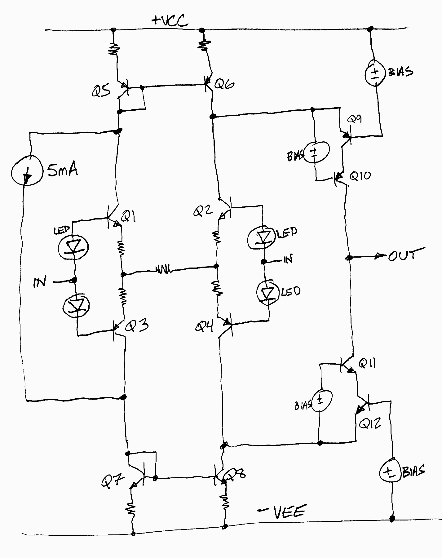

I bought Kolinummi's book from the Linear Audio website and I encourage others to buy it too. On page 200 he says
_
The complementary symmetric input stage topology makes it easier to create a symmetric VA-stage. In such a circuit, asymmetric input-stage loading can be accepted without increased distortion, and this topology is also superior in terms of offset voltage, input current, and PSRR.
One of his examples of this idea appears on page 194. Not wanting to upload copyrighted material, I have redrawn it by hand, and made some (very!) slight changes; thus it's not a copy. Trust me, the schematic below faithfully represents the essence of his example. Or if you don't trust me, open the book to page 194 and find all of the differences. Maybe you won't agree they are very slight (?)_

Interesting circuit.
This appears to be a folded cascode, so VAS signal current cannot exceed IPS signal current (unless I've overlooked a factor of 2 somewhere.
Not sure about the noise performance without simulation.
What biases the 4 LEDs? If it is current sources, they would seem to need to be very carefully matched. Also, it looks like the LEDs must be matched in forward voltage.
Bob
