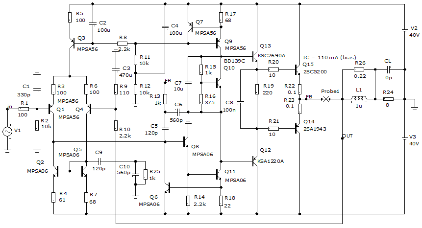

Yes, this is a real prototype. I simulated it and then built it. I have a 40MHz signal generator so I have some indication hen simulations and reality don't converge.
Thanks for the info. I onder if I coul find the source of the oscillation by probing the air around the traces. I suppose this ould be a job better suited for an FET probe, unfortunately I don't have one.
Hi Keantoken,
I'm sorry for being late to getting back to you. I wouldn't think probing the iar around the traces would be very effective. Tracking these things down can be difficult. If you haven't tried it, tray base stoppers fir the driver transistors. If you have base stoppers for the output transistors, try probing on both sides of them to see the amplitude of the oscillation. BTW, sometimes just probing with a 10pF 10:1 probe on a sensitive node can stop the oscillation.
Bob
Yes, I'm aware of the difficulties. My scope has about 180pF probe capacitance counting the probe and scope, which makes it totally useless for probing anything but the power supply and output.
I think that a low-Cob active FET probe, with a special insulated frilly tip to maximize surface area, may be able to probe traces through the air. This is because the capacitive input impedance, in series with the capacitance through the air, would form a voltage divider just like resistors would. It would only be an approximate probe at LF because of the lopass needed and the varying probe gain with trace proximity. Nonlinear capacitance would need to be cascoded away to increase the accuracy and sensitivity.
The 150p/47R RC stopped oscillation at 50MHz. Then I discovered oscillation at 150MHz! But, this oscillation remains even when I turn off my amp... How confusing. I wonder who is transmitting!?

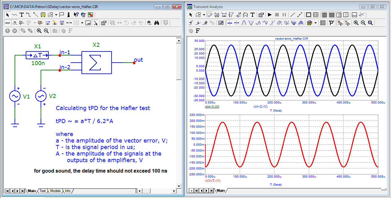

Presumably, Carver uses the Hafler test, which I have already quoted along with the Baxandall test.
What is the attenuation of the vector error signal by 50 ... 70 dB. This means that the level of the vector error is 300 ... 3000 times less than the signals at the outputs of the amplifiers. Let's imagine that we use a triangular signal with a frequency of 10 kHz (100 μs period) as a test signal, while its amplitude at the outputs of the amplifiers is 60 V from peak to peak. If the signals at the outputs of the amplifiers are equal, the difference signal will be a rectangular signal with an amplitude of 0.2 to 0.02 V.
Time Propagation Delay is calculated by the formula:
tPD = aT / 4A
where
a - is the amplitude of the rectangular signal at the load;
T - is the period of the triangular signal;
A - amplitude of the triangular signal at the outputs of the amplifiers
In this case
tPD (max) = 0.2 * 100/4 * 60 = 20/240 = 0.083 μs = 83 ns
tPD (min) = 0.02 * 100/4 * 60 = 2/240 = 0.0083 μs = 8.3 ns
I have repeatedly mentioned that the signal propagation delay time should not exceed 100 ns. As you can see, Carver is doing just that.

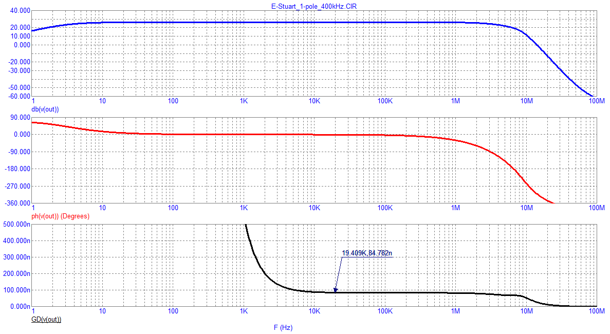

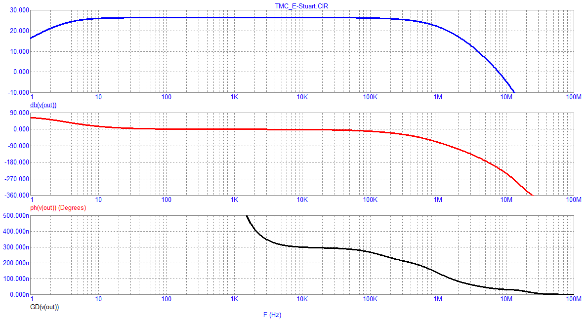

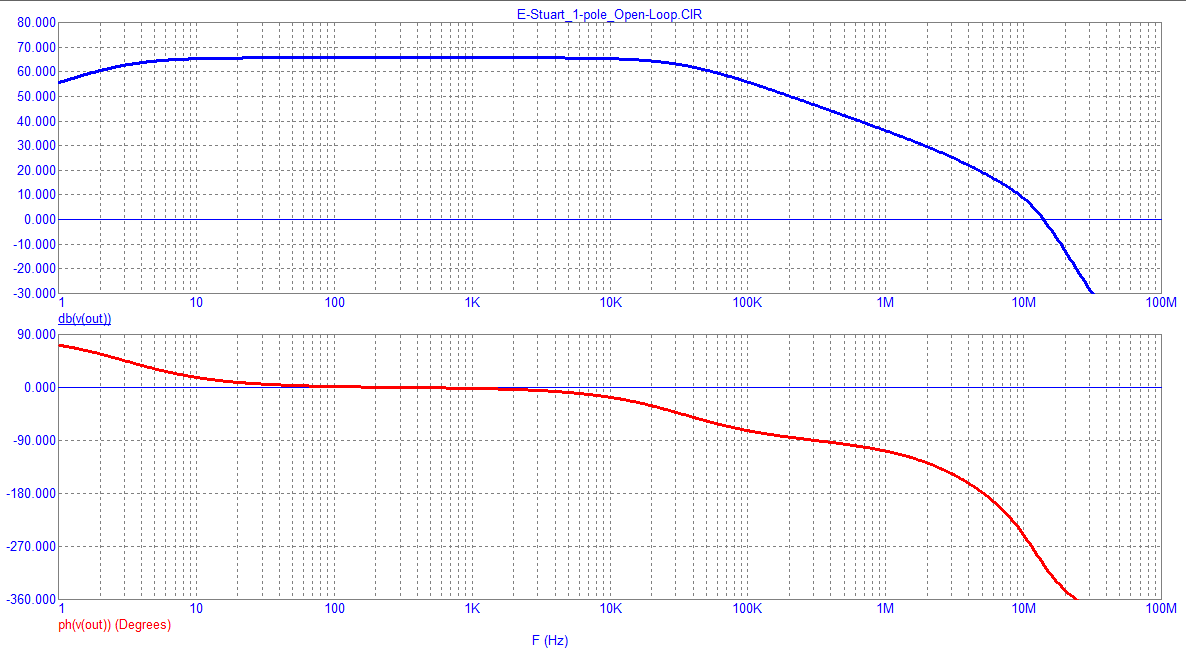

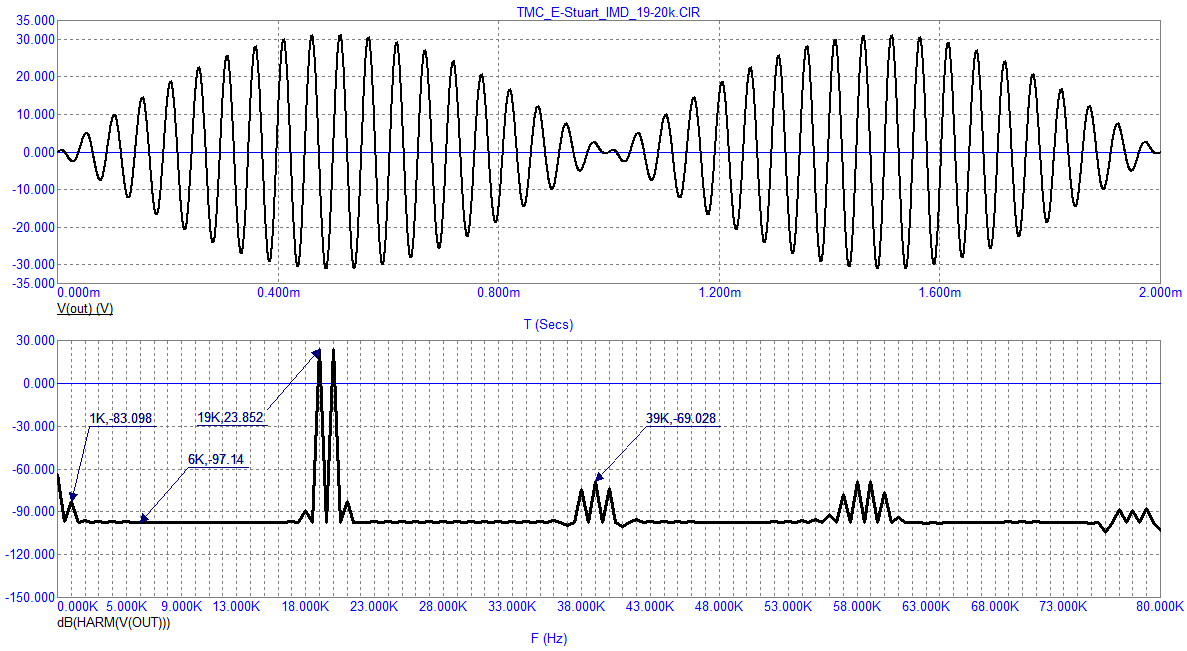

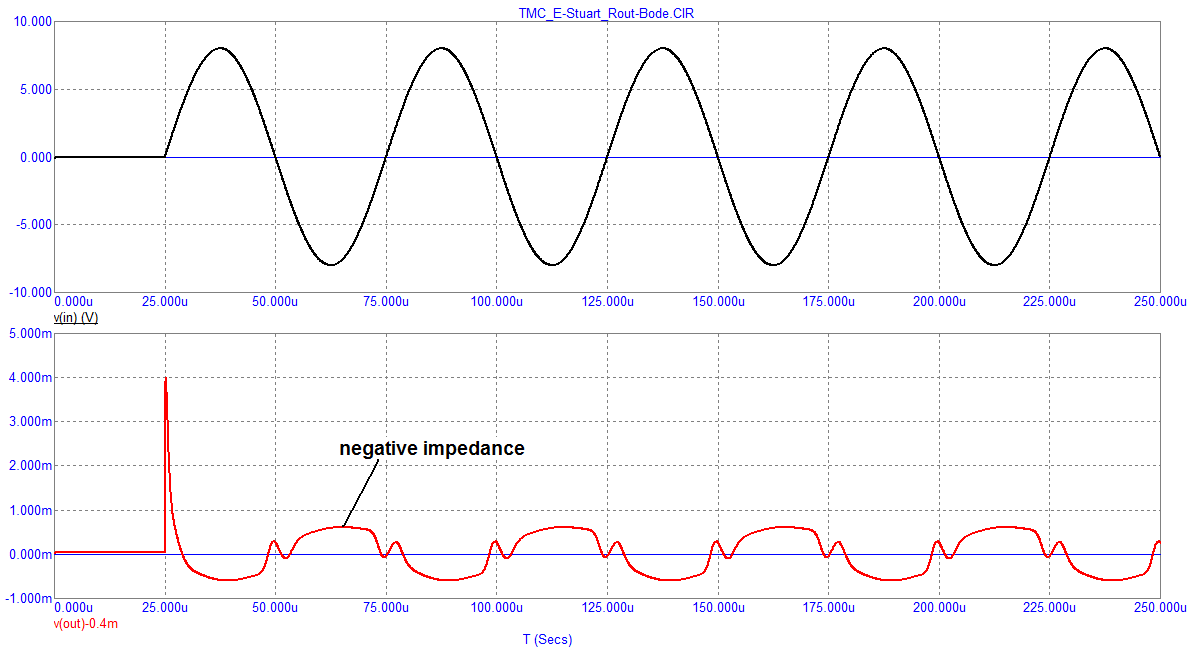

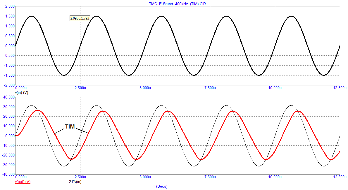

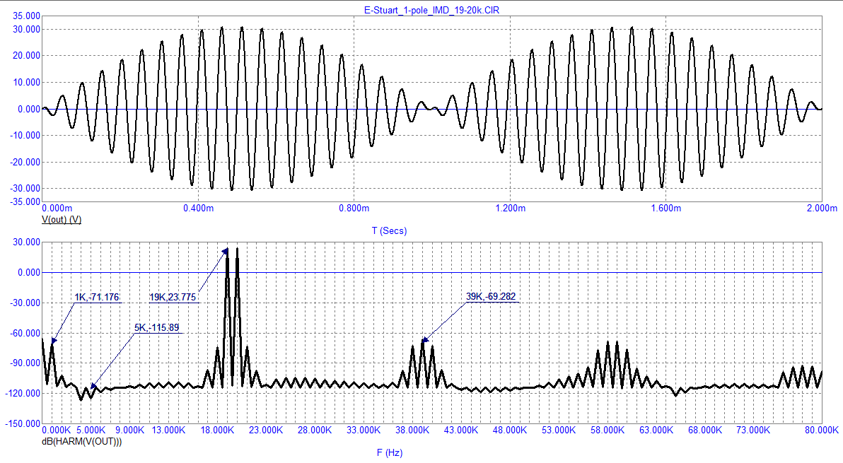

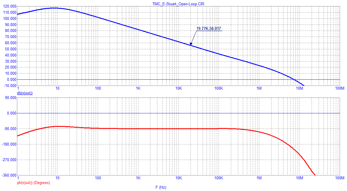

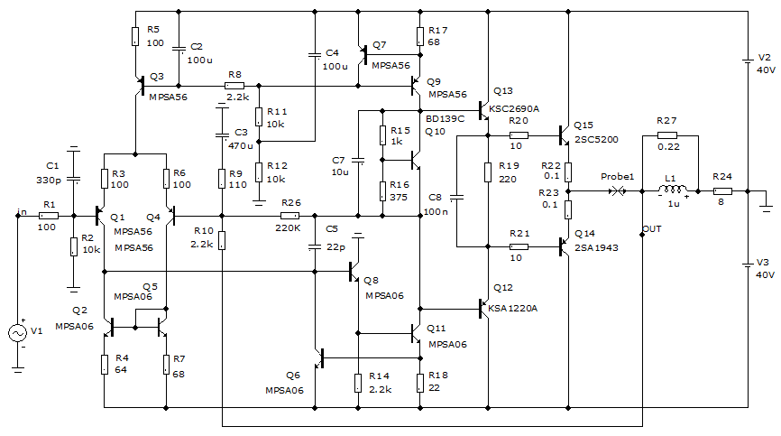

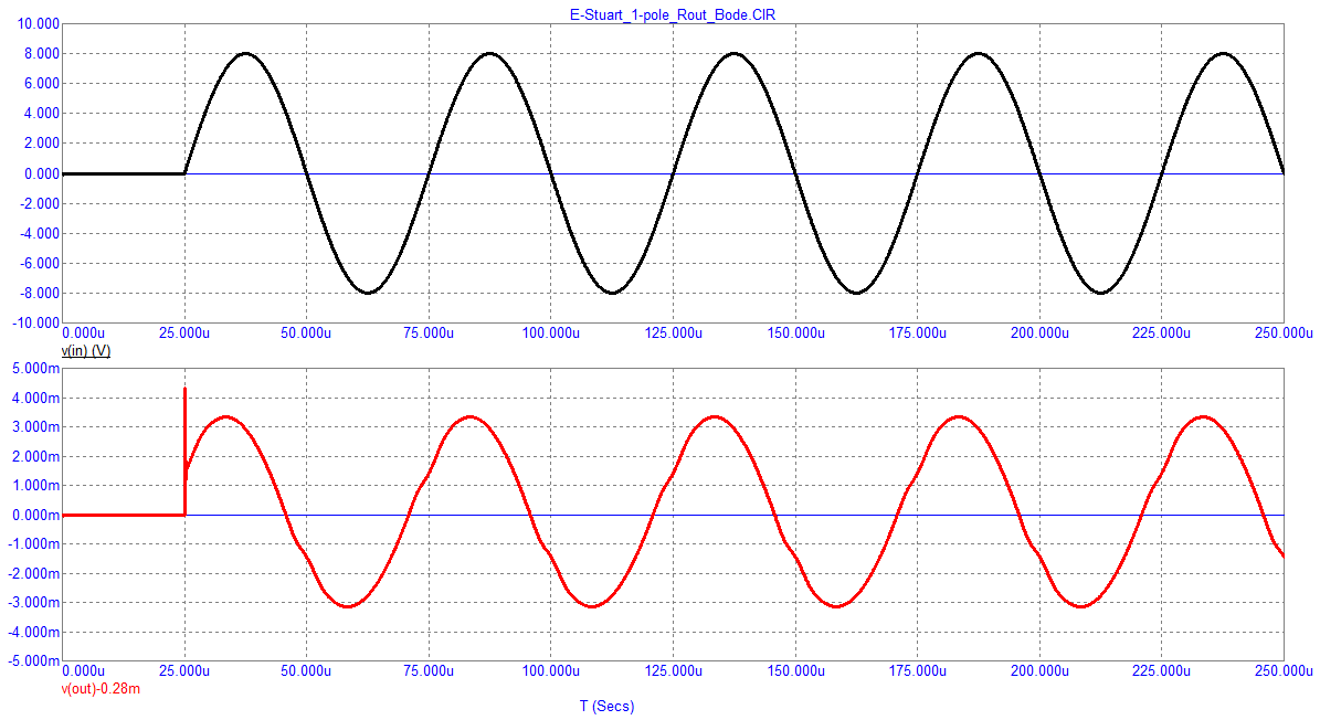

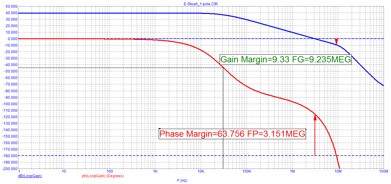

I also decided to type in the model and see how it works.
I was not satisfied with the work of TMC. Therefore, I decided to simplify the circuit as much as possible and raise the frequency of the first pole above the audio range as recommended by Matti Otala. As a result, the noise floor in the soundband in the IMD test decreased by almost 20 dB (almost 10 times). The signal transmission delay time has decreased by about 3 times. The output impedance is constant throughout the entire audio band. The slew rate of the output voltage has increased.
Graham Maynard
This is what I mean by the reactive nature of Edmonds arrangement.
We should be aiming for a flat phased damping response.

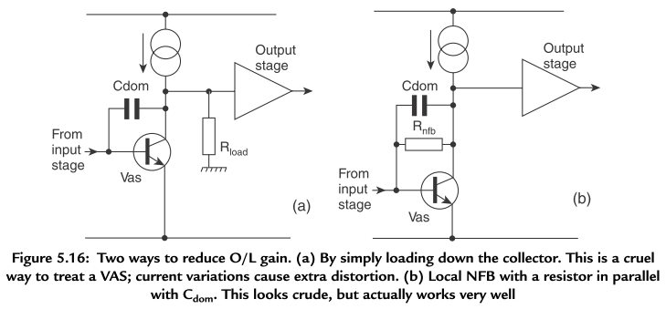

As for the frequency of the first pole, apart from Bruno
Douglas Self writes about it in the fifth edition
With regard to increasing the frequency of the first pole, the following methods are used:
include the load resistor at the VAS output to the common one, i.e. parallel to the VK input. This stabilizes the VAS load and thus reduces the dynamic distortion caused by the amplifier load impedance swings. When using the Darlington triple, the load resistor can be of a large value and additionally does not load the VAS;
include a resistor in parallel with the Cdom condensate as shown in the fifth edition of Douglas Self's book;
and finally, a nested NFB loop is introduced from the VAS output to the NFB summation point. Such a nested FB loop reduces and stabilizes the VAS output impedance (even in the open circuit of the Global NFB loop), and also stabilizes the OPS input impedance, since it is essentially connected in parallel to its input.
You are replying the 9-year old thread. Apparently, me too...
From the schematics you posted. There are couple of things changed. To fully understand what change contributes to lower distortion, you have to isolate those changes.
1. TMC is changed to simple Miller compensation. Maybe the original TMC is sub-optimized, and causes more distortion.
2. The equivalent Miller cap value is changed from 120p to 22p. More feedback around output stage, lower distortion value is expected.
3. The way you put R26 is different than the one mentioned in the book. You include input stage as well. It may help lower distortion of input stage a little bit, if there is any.

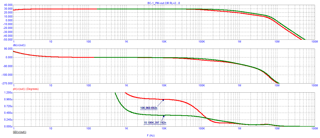

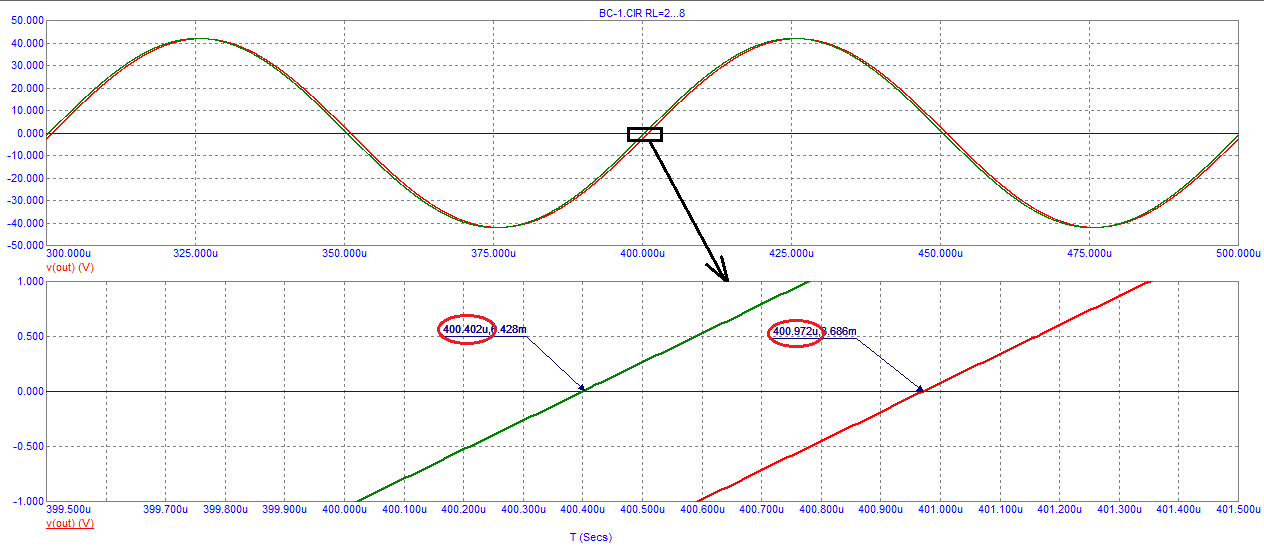

In amplifiers, frequency modulation is also possible as a result of the deviation of the Miller capacitance in the output stage of the VAS under the influence of a change in Ku due to a change in the load impedance. The mechanism of occurrence of frequency modulation was described in one of the articles by Barry Gilbert.
Here is the result of changing the group delay in small-signal mode with the BC-1 amplifier operating at a load of 2 and 8 ohms, as well as changing the signal transit time at a frequency of 10 kHz at the same load.
It can be seen that the group delay deviation is approximately the same in the low-signal mode, which is at full output power and is approximately 570 ns with a signal period of 100 μs.
If we take half of this value, then we can say with confidence that the frequency modulation will be up to 0.25% or more.
