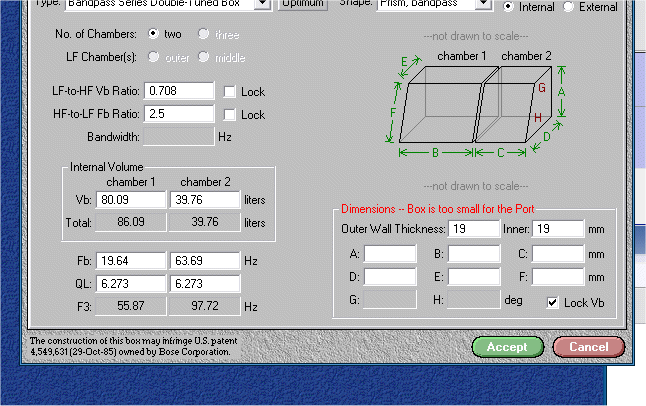

Don't worry , it doesn't work (on that amp).. anyways. The second part of the shown patent does , artu has implemented a varient of it.
I'll do as "bassbox" does with the Bose patent (below) ... "addition of the second capacitor/resistor infringes on US patent # 7652531" ...

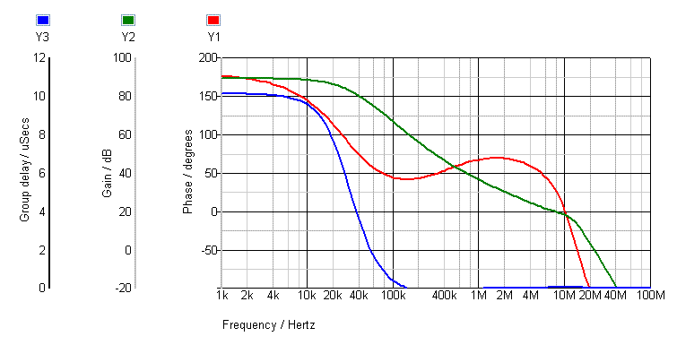

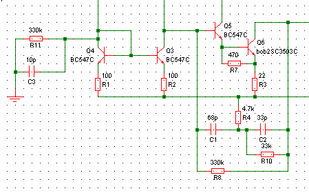

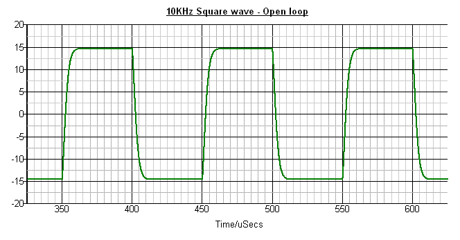

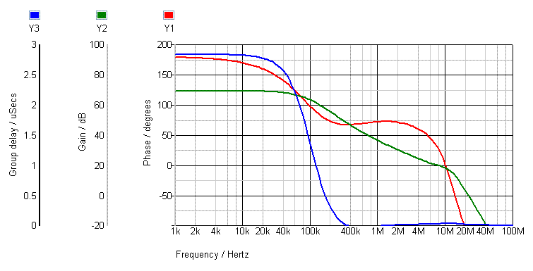

A different approach with TPC/TMC
Hi all
Most of the discussion about TPC and TMC revolves around using these techniques to increase loop gain.
Another way of looking at it is that these techniques can be used to increase open-loop bandwidth for a given amount of loop gain.
E.g. for an amp with 30dB gain, if we want 40dB of global feedback with unity loop gain at 2MHz, we need 70dB open-loop gain and, while CMC would require a first order roll-off at 20KHz, with TPC we can use a second order roll-off at 100KHz instead. The first two pics below show the open-loop response of such an amp, and it's square wave output at 10KHz, open-loop, unfiltered.
With reasonably low open-loop distortion (say 0.1%), I would expect it to sound quite good as is, with no GNFB. With 40dB feedback, distortion drops to about 10PPM, which I think most would consider good enough. Importantly, distortion is reduced equally across the entire audio band.
In the schematic, R8 sets the low frequency gain, C1 and C2 set the unity loop gain frequency, R4 sets the 2'nd order breakpoint to about 500KHz, and R10 damps the 2'nd order roll-off at 100KHz (the same function as the extra capacitor in Bob's BTC scheme). R11 and C3 over on the left repair the damage to DC offset and PSRR caused by the compensation network.
Ahem, to the eagle-eyed: Yes I only realised after doing all the sims and making all the pretty pictures that I goofed a bit with the values. As shown, the second order roll-off is from about 85 to 350KHz. To get 100 to 500 KHz, R4 should be decreased to 3K3 and R10 to 27K. It doesn't make much difference though. With the "correct" values, group delay drops to 2.5uS and the phase margin at 2MHz is about 3 or 4 degrees worse.
Anyway, I'm sure many would want more than 40dB of global feedback, so as a second example, let's assume 60dB is required. While CMC would require a first order roll-off at 2KHz, with TPC we can use a second order roll-off at 30KHz instead - a definite improvement. To get the extra 20dB of loop gain, R8 should be increased ten-fold, and R10 about three-fold. The forth pic below shows the resulting open-loop response.
Cheers - Godfrey
