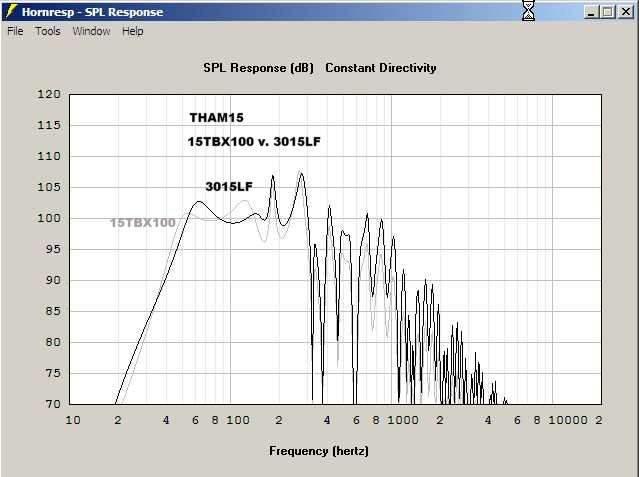

Hi Robin N Zone,
Just a very quick comparison between THAM15 loaded w/ 15TBX100 and 3015LF. If you want to go into that direction it might be worthwhile to take a look at Forsman's THAM-type layout: http://www.diyaudio.com/forums/subwoofers/224160-thorn-f1-learning-experiance-tapped-horn.html . A little longer path, add to that the cone correction......might just work very nicely.
Lots of info to absorb, but worth it.

Hi Robin N Zone,
Oliver, thanks for the comparison! The 3015 doesnt look to bad in the THAM15.

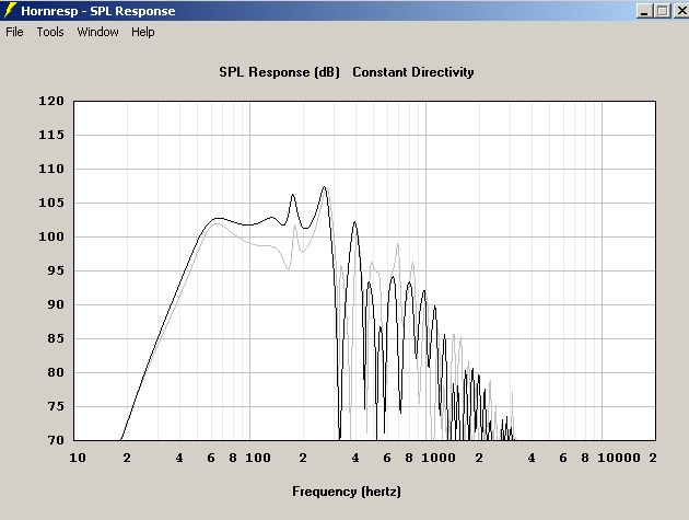

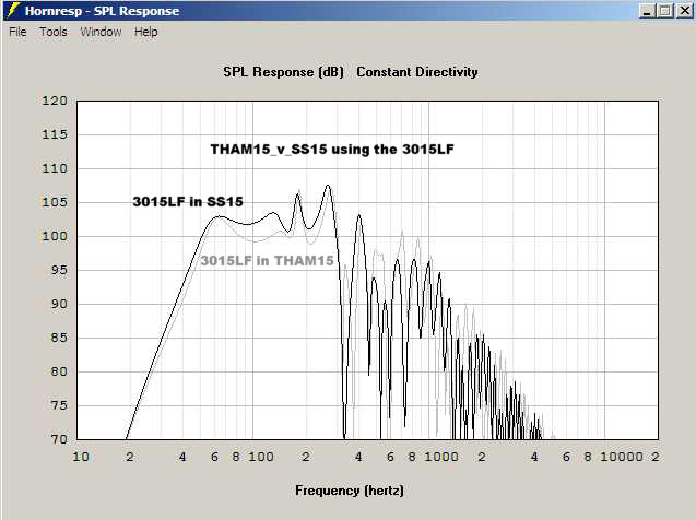

A SS15 has an actual internal volume of 224 litres disregarding the driver.
A Tham 15 has an internal volume of 144.5 litres measured in the same way.
The Tham works as well as it does by having a long path length for its size. It has a path length 75mm shorter than the SS15 when measured in a comparable way. But most of the posted sims for the Tham speakers exaggerate the internal volume by a large amount.
Martinsson defends this by his real world results.
When I compare the Tham 15 and the SS15 together using the 3015LF driver with comparable unfolding geometry and a sim volume within 6 percent of the measured volume, erring in favour of the Tham! I get the following directly comparable result. This is as fair a comparison as I can acheive.
Regards Xoc1
Regards Xoc1
Xoc1 and Otb46, thanks for your graphs, very nice!
I mistakenly thought that the THAM15 was a bigger cab than the SS15, but I see now that is not the case
Xoc1, in your graph, is the black line the SS15 and the grey line the THAM15?
Which version of the SS15 was it? Your mod or the "standard" one?
I do like the folding style and size of the THAM15, but it seems like the SS15 might be a better choice for me, and the SS15 is still only half the size of my current T48s!

Hi Robin
Regarding the sims, the SS15 sim is based on the original Jbell SS15 layout
The Tham sim is the same - but both sims are based on the actual geometry, not posted sim data, so that the 2 are comparable.
The modded SS15 layout has more of the lower frequency bump and a little bit less at 140.
Regards Xoc1
