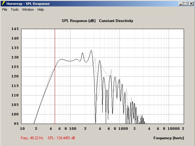

I finally settled on a version of the SS15, I optimised as much as I could for the Kappalite 3015LF drivers I had, which was not the same version of the driver that JBell designed for from the beginning.

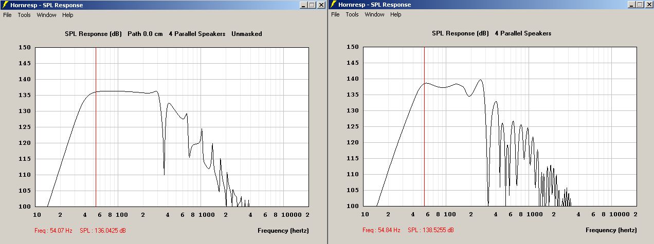

I'd love to hear if anyone's actually tried and measured a 15TBX100 in that design. It's a single sheet design (with a bit to spare) that actually gets below 50 Hz
Check out: http://www.diyaudio.com/forums/subw...rse-engineering-sim-tham15ds.html#post4445680 The PA385 spec's are now considered questionable. The 15TBX100 rocks this however.
In a nutshell, what's the difference between the THAM15DS design, and Anders Martinsson's THAM15 design? There is probably some massive thread that explains it which I haven't read yet
IMO, not much. Seems like every HR update brings the designs closer to each other but when we started with it, it definitely had a lower corner and I think that was Don's goal, to be "in between" the popular smaller and larger TH designs. That said, the DS has a flatter extended response >100hz.
