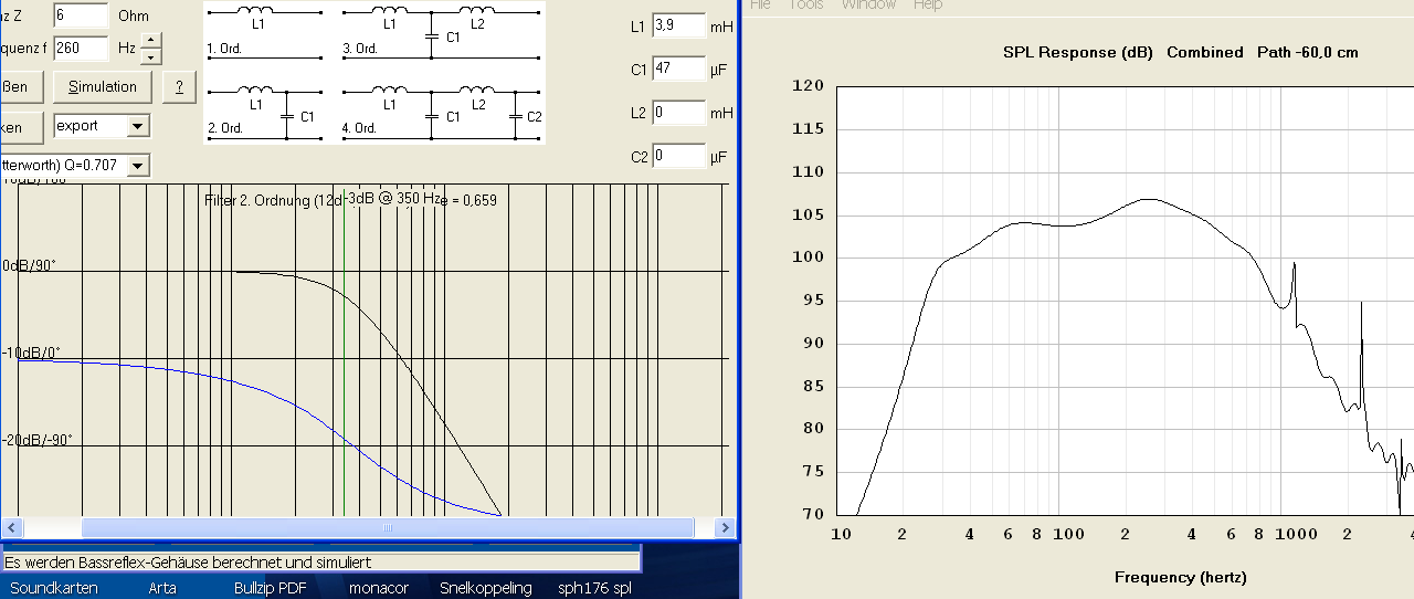

when you apply your selected Pi value to the horn part of your hornBR simulation, the software automatically is adding room gain to the BR section, accordingly to the Pi value you have chosen

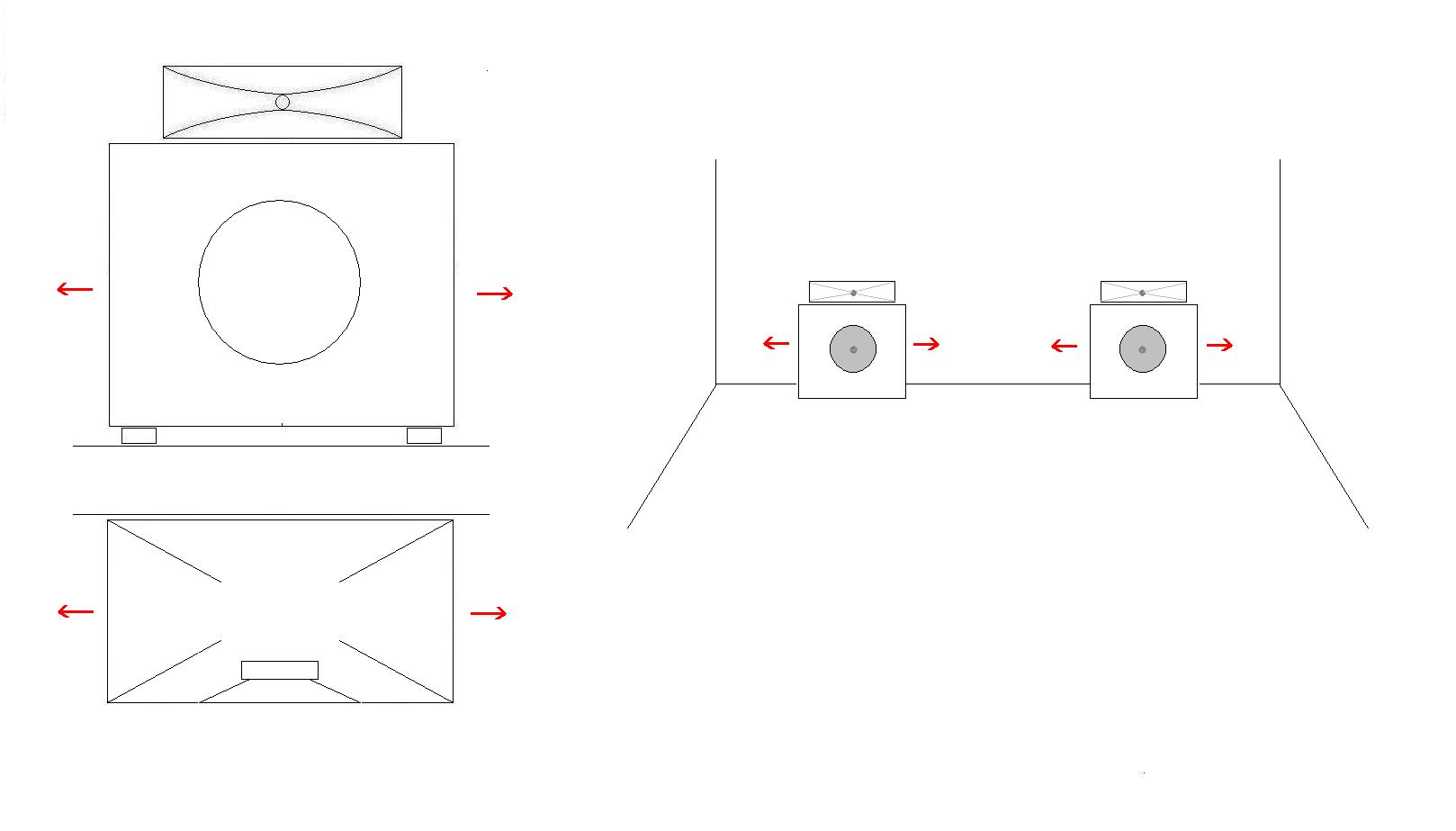

the one I'm working on would look like this
just to show how double sided mouth could work, in a room

Here again the 1phi 133liter tractrix option with the monacor 76euro woofer. With filter added the response will be flat up to 400Hz.
With mine simulated horn it would be smart to make it a triangle shape like the klipsch.
Then it can use room gain as good as it can get placed to a side all or in a corner.
The simulated response is calculating with the BR opening direct under the front horn.

some details missing in my drawing
I will try and show with pictures during build process
its actually folded one time
so total length is about twice the mouth length
if you calculate with the curves, each side of the speaker has a horn that measures 450mm x 700mm x 800mm long
as there's two per speaker that means a mouth area of 900 x 700mm x 800mm length
....of no concern whether the horn mouth is upwards/sideways/whatsoever.

it matters if you place the horn close up against back wall
then you have both floor and wall
that should be 1pi, effectively
with most other horns, only placing close to side wall will give you that
Corner load would take it to the next Pi level, yes
but genuine corner load has several other issues tha I dont like too much

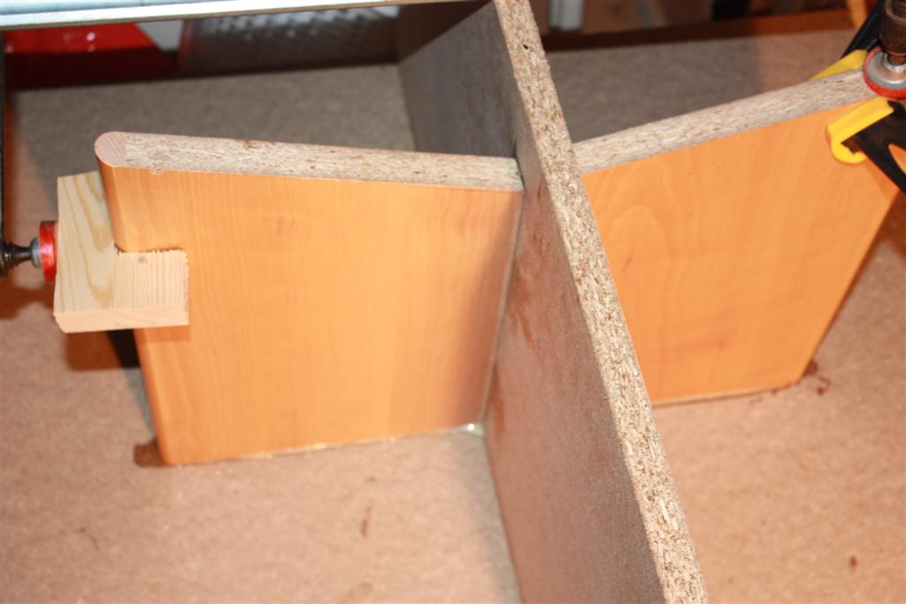

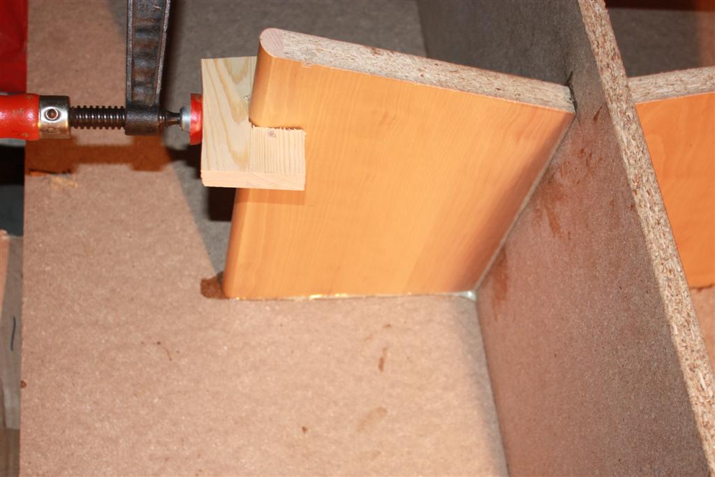

what you see is horn mouth
there will be 4 throaths, one each corner, symmetrically
This is an effort to get big horn mouth, and still with a box only 500mm deep, but quite wide at 800mm
btw, I use a 15" woofer, with highish Qts
not quite sure yet what that will do
whatever, here's what I have managed so far
bloddy hell, I glued some yesterday
but forgot how cold my 'workshop' really is
so today it just fell apart, like nothing
and I had to redo it all today
