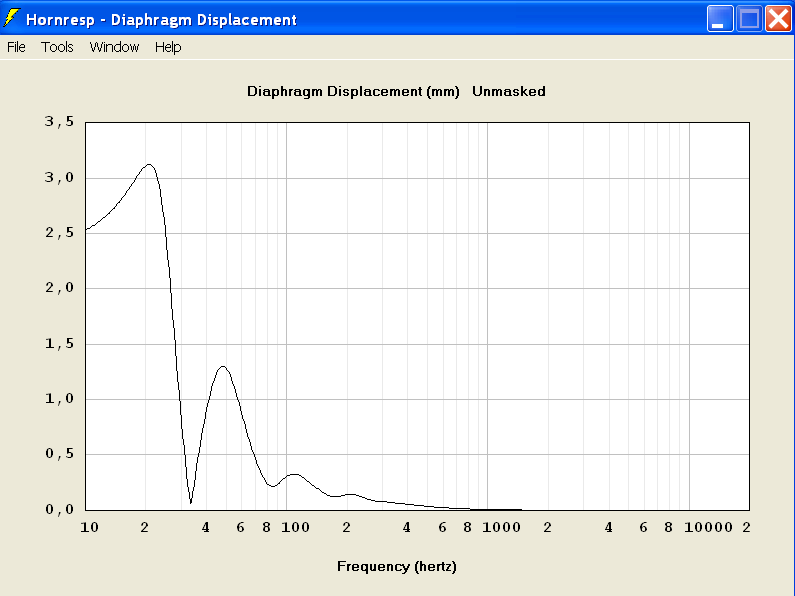

you're making a think fault. This sp12/100pa is the ideal woofer for single ended tube amplifiers.
The think fault you are making is thinking the 2,5mm with 12" and 25Hz isn't enough.
I will explain (extrusion) * (surface Sd) = Soundpressure.
This woofer is a perfect match with single ended tube stages up to 10W. It will operate then up to its limit. See pictures xmax at 25hz with 3.1W and a amazing soundpresuure of 110dB 1mtr.

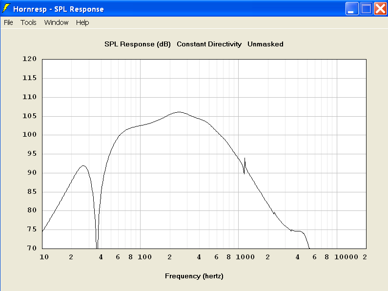

Hey Helmuth,
Go for 1,0xPi instead, when designing. It will be next to impossible/unrealistic to get a perfect corner-placement.
EQ will off course help.
The one I did on your "theme" was just for showing what happened when going another route.
When you go 1,0, you will get shelving, which can be helped by a smaller box. The penalty is higher Fl.
Also you will probably also need a 2-300Hz midhorn.

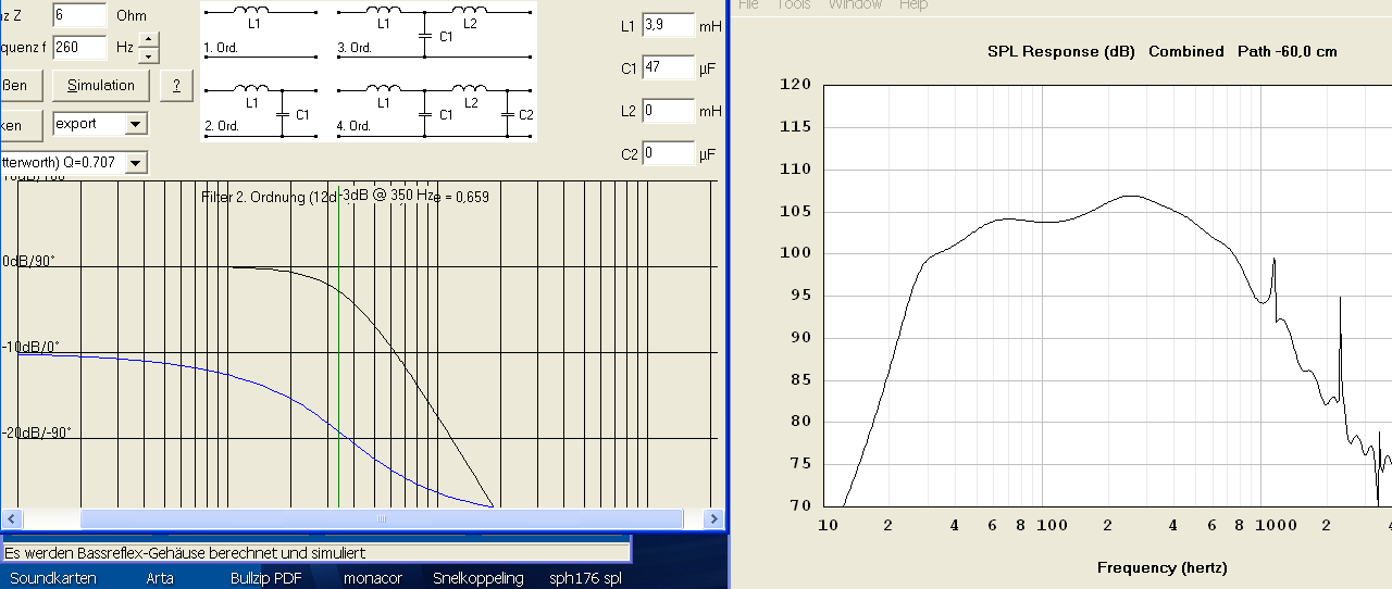

Thats true here a optimized simulation 1phi.Hey Helmuth,

With the low pass filter it will be flat 1phi 40 to 400Hz and 30Hz -4dB still very good value's. I think with a resistance in series with the filter capacitor will stretch high response to 500Hz. that is with a single ended power a reasonable value to cut off with a big mid high horn.

To call this 30Hz -4dB is far to optimistic. But with the help of EQ(active or passive) it might work.
If you want to check frequency response you must use Directivity with your intended listening angle. Unfortunately one cannot use Directivity at the same time as Combined. So you have to do some adding by yourself.

with some passive cross over tricks the response can be stretched up to 500Hz to get a XO point where some 2" drivers still will work properly.To call this 30Hz -4dB is far to optimistic. But with the help of EQ(active or passive) it might work.

Hi Tinitus,

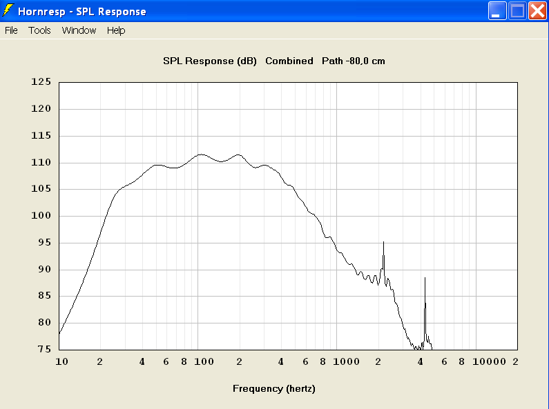

Revintage is right that it isn't realistic to have 100% corner placement and loading. So the 1phi simulation is more practice. The sound pressure reduces to average 104dB at 3W.
Details in the txt file you can import in C:hornresponse.

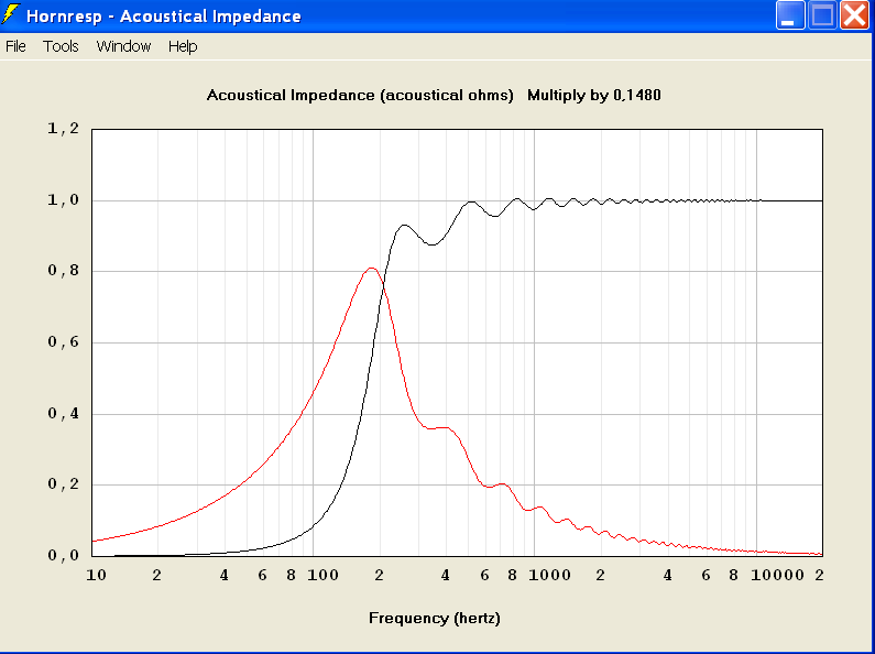

horn loading front horn has effect down to 70Hz than the impedance begins to rise. Then due basreflex loading and floor wall place mant(+6dB) this is the result.

You're not in to horns tinitus. I do not calculate +6dB the simulation program does. And that is better than a simulation with out because we have walls and a floor in our room.
See figure without port reponse it is horn response.
