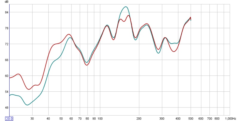

Here the system in stereo measured on listening position it was in fact reasonable flat 30hz -15dB. Only the mid range seemed to change constantly, some day it sounded great and a other day it was not so good any more.

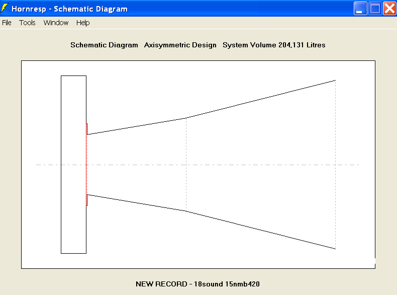

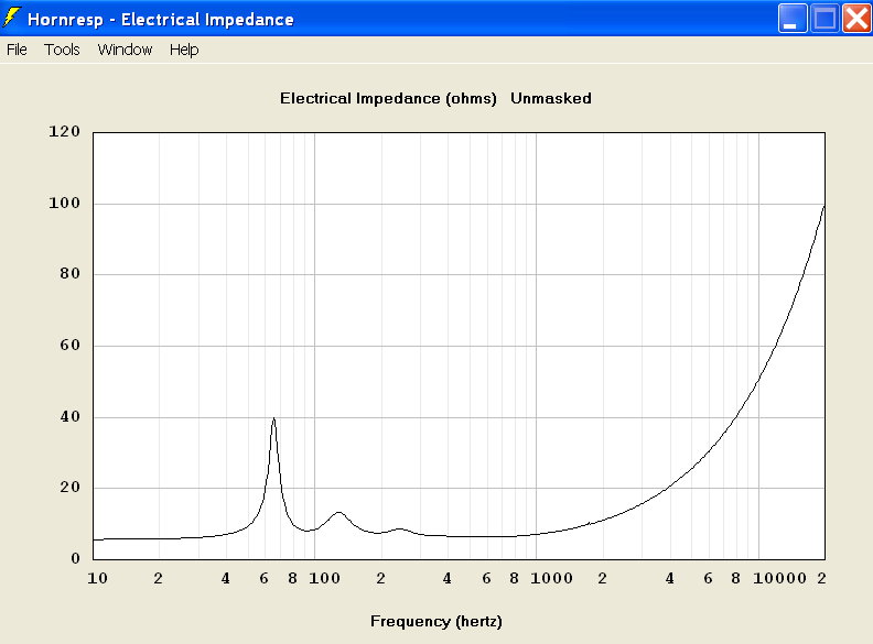

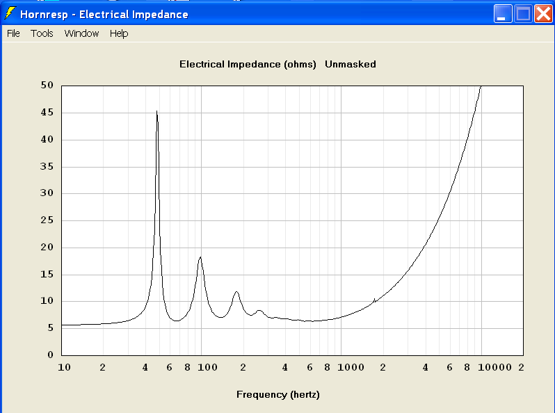

Personaly I would say forget the form of the la scala. and fold it something like this one. This drawing is a cube shape I would make it taler and like this one woofer cone facing the top of the box. And a BR opening in the closed volume.
Impedance (at 1 phi) of the woofer BR tuning of 45 Hz shout be possible. Then it would out perform the klipschhorn.

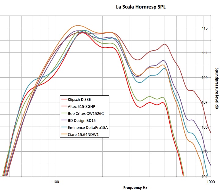

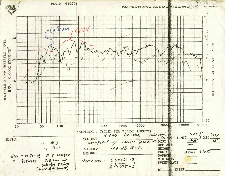

Rummaging through my hard drive, here's a set of curves I've dug up for the various Klipsch basshorns. The first graphic is the Klipschorn, the second is the La Scala, the third is the ported vs sealed La Scala, and the fourth are PWK's measurements of the Klipschorn and La Scala. If I recall right, the Belle Klipsch measures quite similarly to the Klipschorn.
Things don't look good for a 700 Hz crossover with these two horns. 300~400 Hz, sure, if you're willing to live with a rough phase transition between the basshorn and the midhorn. I can see why ALK uses ultra-steep slopes on his aftermarket crossovers for the PWK products.

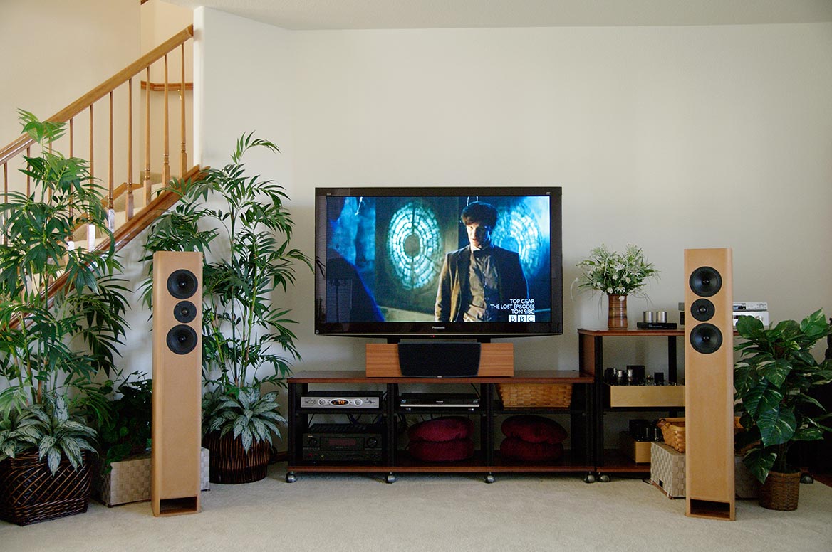

What's available is about the size of the La Scala in overall volume. To give you an idea of the scale, the display is a Panasonic P58VT25 58" television, about 60" wide overall. Yes, I plan to add damping panels on that 45-degree stairway that intrudes on the living-room space.

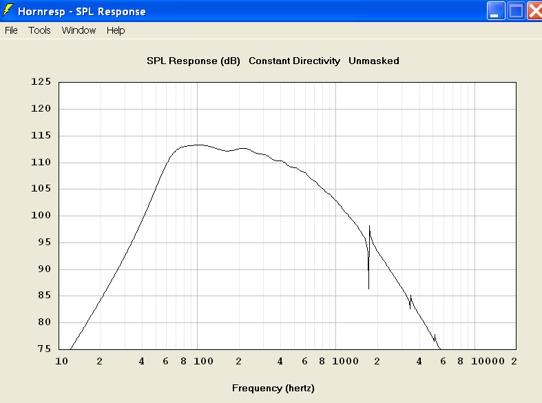

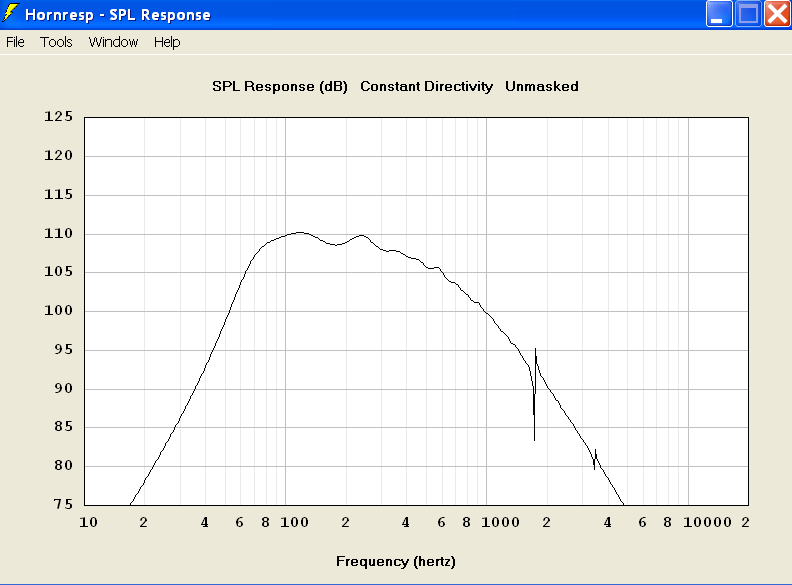

Simulation with the same driver and as the lascala with short 1meter horn. 1phi it will be better the reproduce up to 300Hz 60Hz not bad at all with this short horn.

Forgive me if this is a stupid question, but what about the range below 60-70 Hz? There's music up to at least 40 Hz, if not lower. Is the idea to put a shelf on the horn so that the response meets the efficiency at 40 Hz or so? Wouldn't the horn be unloaded in this region then?
