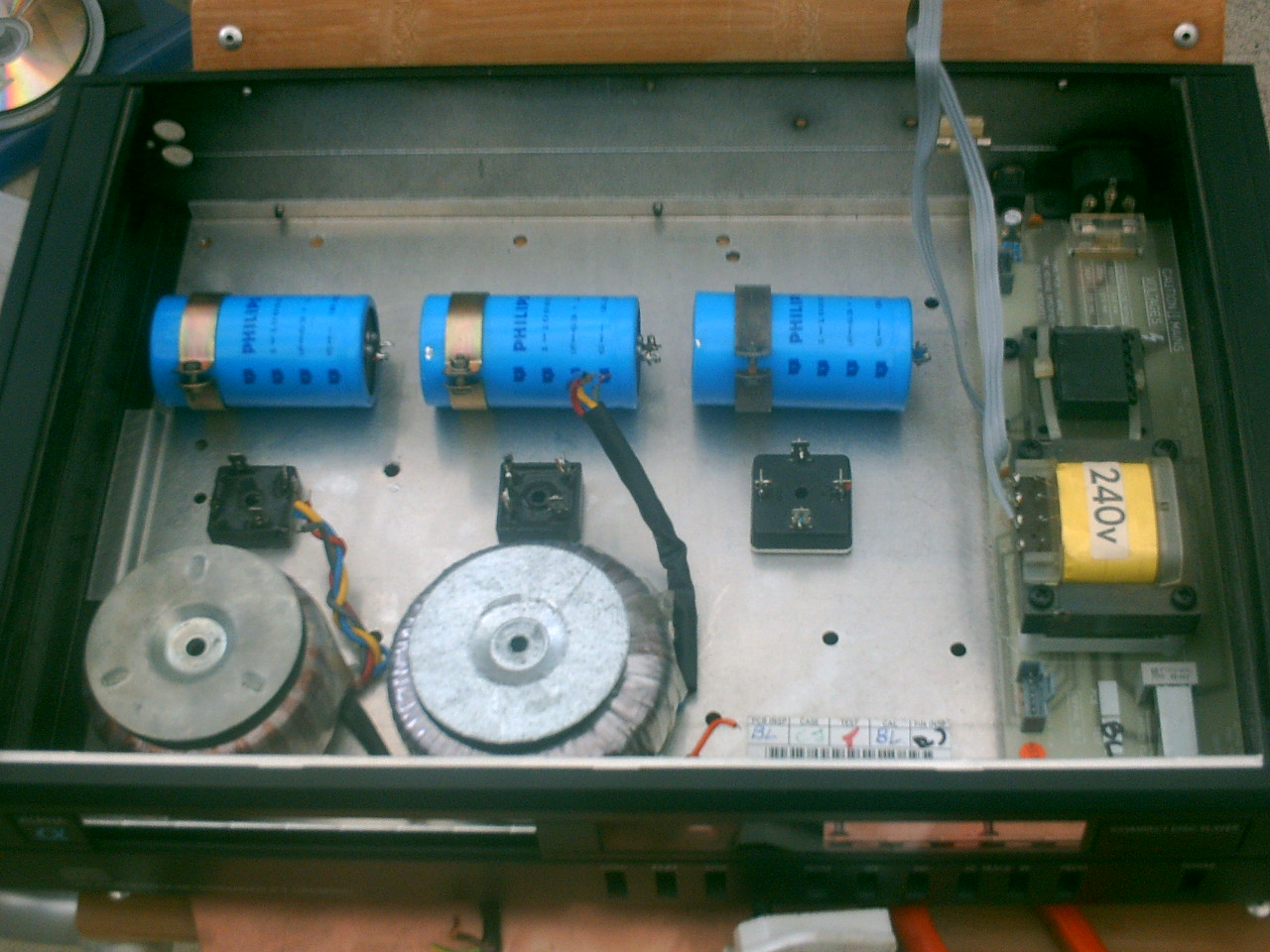

Here's pic of where I was with the offboard ps.
Most of it is bolted down and some wiring is now in - traff's power up and the caps are giving me the DC I need - result.
Just need some military style multi pin sockets and plugs to try it all out.
I guess you can see what I'm planning - powering the whole player from the box you see - which will be underneath the main case.
The player will be switched on / off from this case also.
Have a flat 2mm piece of plastic to fit over the facia hiding the holes left over form the time when it was a CD Player - A bit of acrylic silk black spray paint and you'll never know what it was before - hopefully
The only traff that will remain in the main player will be for the the clock.
It won't be straight forward - nothing is so I'm taking my time and drawing wiring routes and working out how to achieve low impedance at both ends of the cabling - as per AndrewT's explanation in a recently received PM - very helpful man indeed.

Keep the pics coming as it takes shape. I recognize the box from its previous duty as an Arcam CD. Cool idea as it will match the cd player it powers.
You will have room in the box in case you develop an interest in adding chokes to your power supplies.

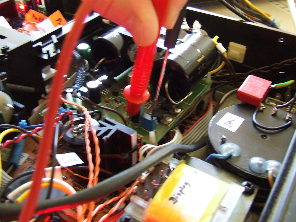

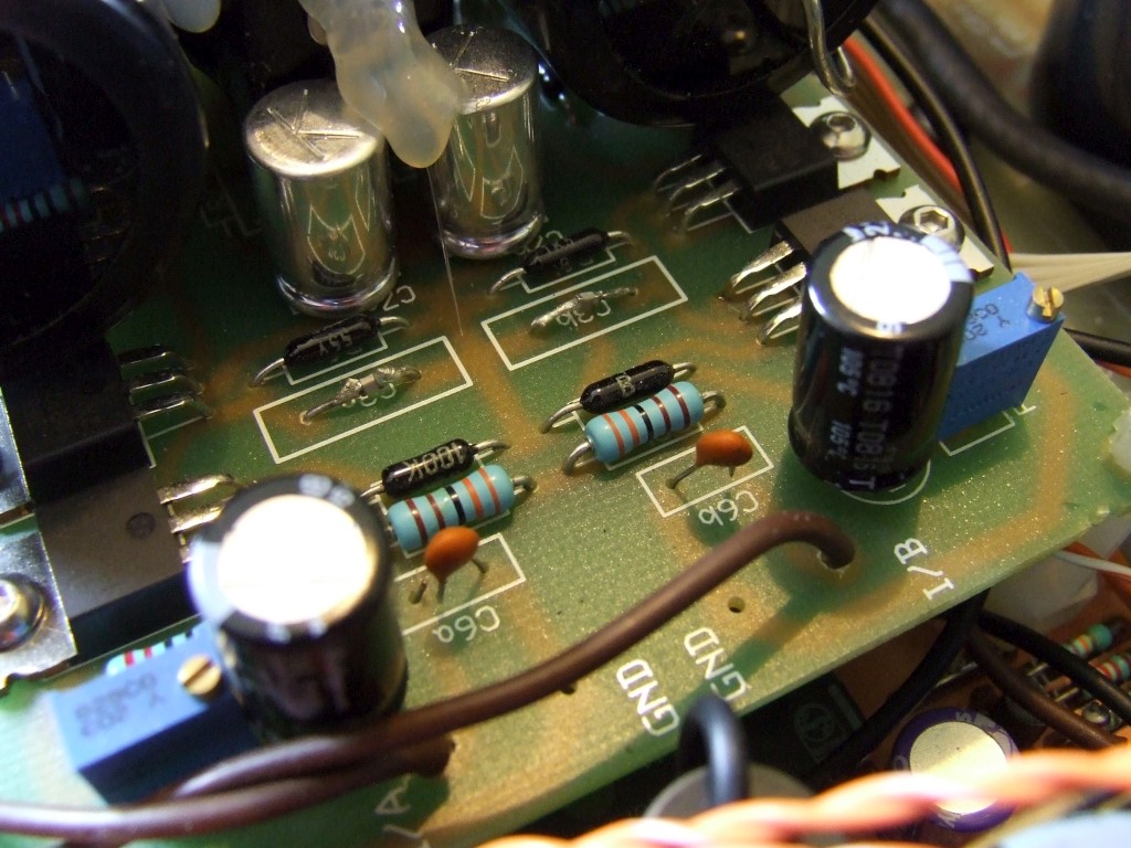

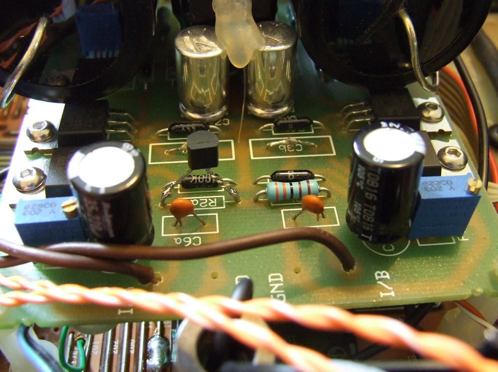

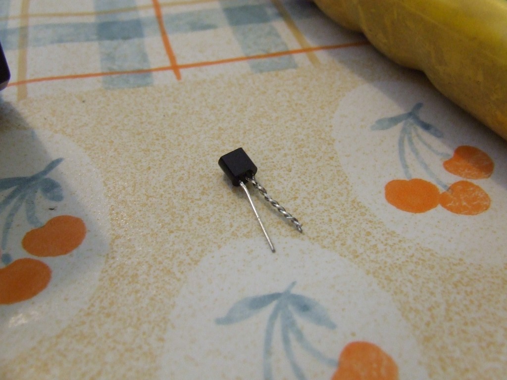

Ok, I did a very nice little tweak today. This one is thanks to Lee (Thomo), who spotted an opportunity to hugely improve the Pass D1 output stage for almost no money. These are the best tweaks: low cost, big gains, quite easy to implement. Lee already tried adding this CCS to the circuit and reported good improvements and even sent me the FETs to do it, so I had to! Basically the FET is dropped in, in place of a resistor that comes off the -30V PSU rail, with two legs (pins 2,3) tied to -30V and pin 1 to the input side of where the resistor was.
The sound is considerably more detailed and pleasant with the Constant Current Source in-circuit. I don't know how it works but Lee tells me it reduces PSU noise on the circuit. This is after a huge CRLC filter and S Power regulation lol. I am very happy with this. More to come soon I hope.
This pic shows adjusting the trimpot to remove DC offset from the circuit's input.

Adding CCS to simple followers like that basically stops the current through the pass device varying with the signal applied to it. This improves distortion performance significantly, and that's why it sounds better - not simply a power supply issue at all!
