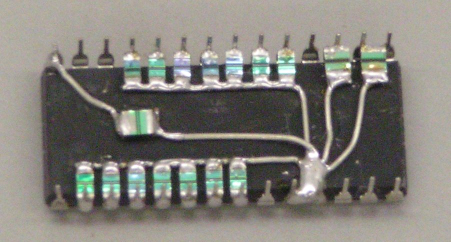

decoupling with surface mount organic polymers
Now this one falls in the land of finishing touches, but its worth noting. Again from the prolific research by EC Design, I was intrigued by his approach to decoupling the tda1541a with surface mount caps. He claims every mm counts and he puts caps directly on pins 7-13 and 18-24.
I picked up some surface mount 8u organic polymers to experiment here. I put one right on the power pin of my clock. Very nice jump in bass, texture etc. (still no super regs so you may have this, but the cap alone worked for me).
So I thought what the heck, lets try the decoupling. I already have BGN on the all important pins 13 and 18, so should already be good, right?. Now under the PCB there is no room with all my DEM stuff. So why not right on the pins as they come from the chip top side. First thing you see is the tip of the soldering iron is way bigger than the cap. And it is already tight with all these caps mounted by Arcam. Never say die.. I put some 20 guage copper wire wrapped around a 60w iron and left a piece sticking out to act as a tiny iron. Put a good sized tin of solder on both the cap and the pin and then with tweezers, a lot of swearing and failed attemps finally got these things to stick on the pins. Then separate wires to ground.
Hooked it up and I must say it is good. At first a little bassy and congested. Of course new wire and new caps always do that. Now with an hour on it, it's opening up really nicely. Nothing of a holly **** you gotta do it, but a nice relaxed polish. Kind of like the clear coat on a Jaguar. Its already got lots of great paint, and its a beauty. But the clear coat just finishes it. Lots of texture. Word that springs to mind is coherent.
It is seriously a pain in the behind to solder. If I ever build a tda1541a dac from scratch, I'm using these caps on the pins. For now, likely just on a couple.
cheers
cheers
I may be sick but...
I had these 14 organic polymer surface mount caps now sitting in the drawer, so rather than sit and enjoy listening to music I was compelled to put them in.
Attached pic for the record shows 6 on each side on the bottom. The first one on each row is above with an even shorter path from pin to cap.
The ground is 24 guage copper in teflon. Each side separately grounded direct to star ground on tube output, so there is no interferance with any other ground.
I hate to say it, but if you ever get in to this area of your machine, its worth considering. It will likely get more open and airy after a few hours on new caps. It is very quiet and easy right now. Well worth the squinting with tweezers to place these little devils without messing up. You can see my poor BGN and Mcap took a beating from getting touched by the hot iron.

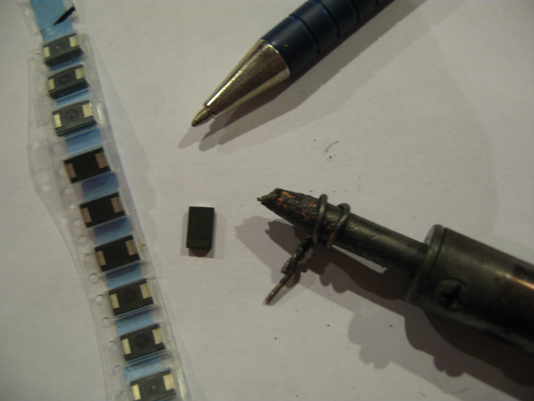

Polymer Aluminum Electrolytic Capacitor
I got them at Future Electronics. $0.59 each. They are:
CORNELL DUBILIER
ESRD Series 7.3 x 4.3 mm 16 V 8.2 uF Polymer Aluminum Electrolytic Capacitor
Mfr Part#: ESRD8R2M16R
Mounting Method: Surface Mount
Packaging: Cut Tape
Walter
Type: Solid Chip
Rated Voltage: 16 V
Capacitance: 8.2 µF
Case Size/Dimension: 7.3 x 4.3 mm
Jon,What are those organic SMT caps - make / series / value ?
CORNELL DUBILIER
Packaging: Cut Tape
Walter
Type: Solid Chip
Rated Voltage: 16 V
Capacitance: 8.2 µF
Thanks Walter, your results are interesting. I'm not sure if anyone has tried such high values on all pins before. I was planning on trying some PPS in the 10-100s nF range when I get the chance. I did try Oscons on the MSB but the leakage is rather high so I went back to film. SMT would be better though.
re leakage
Jon
I'll need to let these fully settle before I comment on the sound. My impression after a couple of hours on the first 2 pins was favorable enough to motivate me to do the rest. I am no expert at critical listening.. One initial impression that ran through my mind after a couple of hours was prior to this change all sounds were somehow linked.. like in a 3d spider web. The impression is the web is now gone and sounds stand on their own with their own texture and harmonic. Not isolated but somehow distinct. I know that sounds wierd but that was the impression. Certainly no 'digital' edge.
What is the audible impact of leakage? The original 220n film are still there technically acting as bypass to the 8.2u organics.
Jon

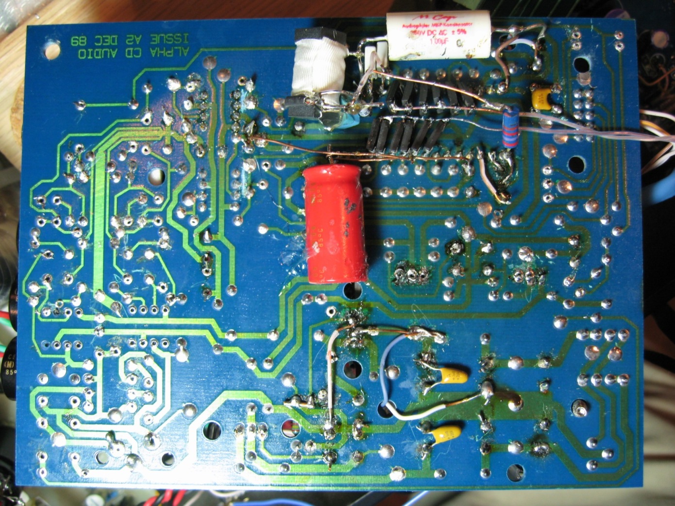

Is this what your referring too Walter ?
I was a bit baffled by this picture attached but see the sense in the way you've done yours with regard grounding to the star elsewhere - might even have a go at this.
If pin 1 is the bottom right on this attachment why is pin 4 ( Data R ) and 5 ( Analogue Ground ) shorted ?
I've got a clock feed going to pin 4 so this has completely thrown me
Not questioning ecdesigns - just my own grasp of it all
Andrew
Andrew
Hi Walter, sorry I hadn't appreciated that the original caps were still there, that makes a difference !
Regarding the leakage 4mA is the DACs full scale current so divide that by 65536 and you get 61nA so a cap with a leakage current of up to 3uA is significant. You'd should expect to hear the difference in quiet passages where the signal is only using the lower bits.
Andrew
The key to the use of pin 4 is actually pin 27. It sets the mode the 1541 expects on input. pin 27 is set to +5v by jumping 27 to 28. This sets the input mode to "time MUX TWC". In this case L&R channel signals come in multiplexed on pin 3. Pin 4 is not used. Looking closely at the pic of my board, you will see pin 4 is shorted to ground. I have reinforced it by running a copper wire from pin 4 over to output ground. I connect to analogue ground en route with the big BGN cap.

I stand corrected..
I took another look at the ARCAM service manual. They have 27 set to +5v meaning 4 is not used. They have a jumper from 2 to 4 so they are both tied to clock.
EcDesigns has wired 4 to ground. Since it is not used, I guess it's 2 different ways of dealing with it by 2 different engineers.
I need to think some more then - completely bamboozled
