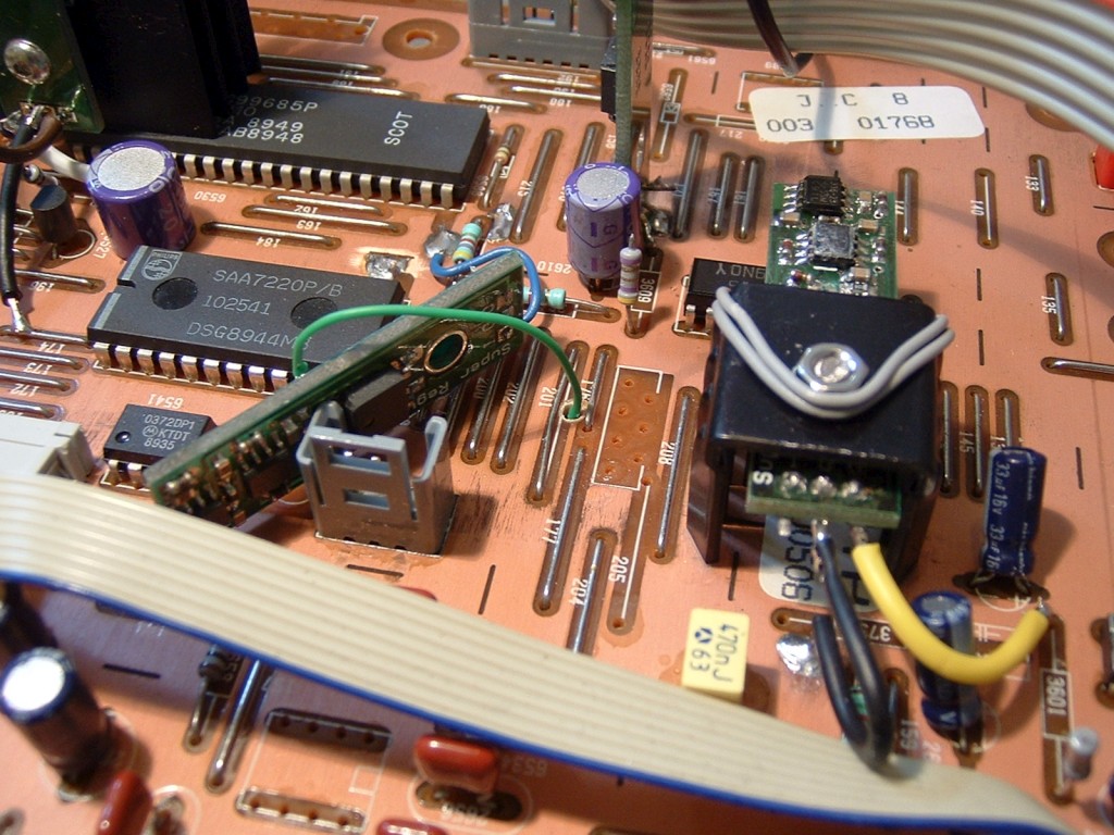

I changed most of the caps on the main board, and on the audio board. I changed the PSU diodes on the audio board only (schottky types). I used S Power regulation for the +5V and -15V rails for the DAC (-5V to follow). I used some old Audiocom Super Regs I had to power the RAM, digital filter, decoder and my clock, which is an Audioupgrades C1.
I used basic Sanyo os-cons for most digital decoupling, and os-con SEPC around the DAC. On the -15V rail I used Rubycon ZA.

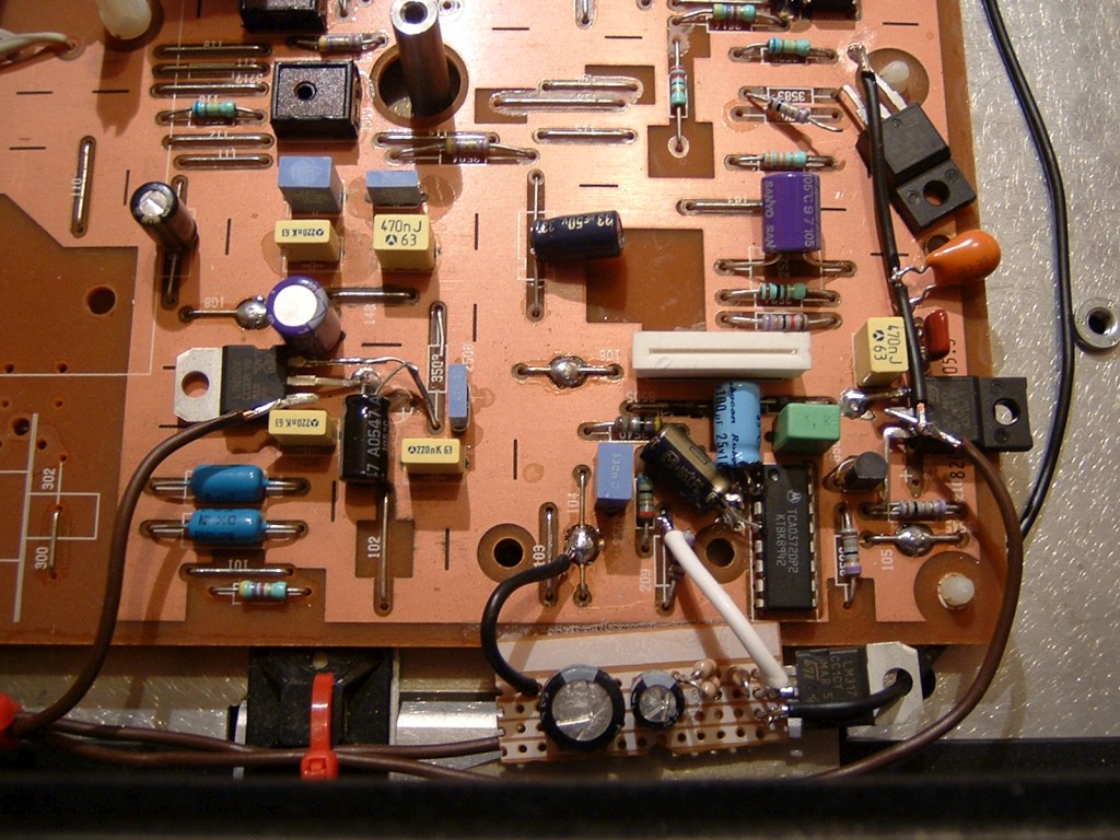

On the servo I added 78/7912 regulators (installed flat for CDM clearance) to power the motor drive op-amp. I installed a 7912 and LM317 (configured for +12V) to power the TCA0372 (Focus drive and Radial drive op-amp). I installed a dedicated 7805 for the TDA8808/8809. I also installed decoupling caps where there were unused spaces on the PCB. Everything in this are must be quite flat to avoid fouling the mounting parts or swing-arm of the mech. See picture attached for example.

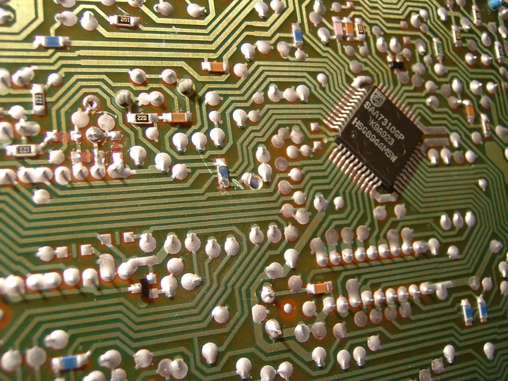

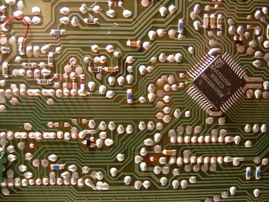

I fed my new clock signal directly to the SAA7220 where the original xtal went. I the drilled a hole through the PCB to get a short wire through for the decoder, SAA7310. The blue zero-ohm resistor in the middle of the first picture below is where the original "Xsys" clock feed comes via from the 7220. I cut the trace after that and fed my new wire in.
A decent craft knife, 1-2mm drill bit and glue-gun should be recommended. You don't want to be going back under there too often to fix it if the wire breaks.
ps - you can't see the C1 clock because it's so closely mated to the super reg.

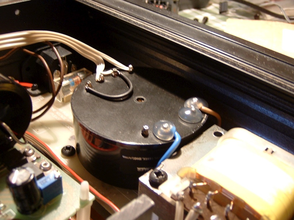

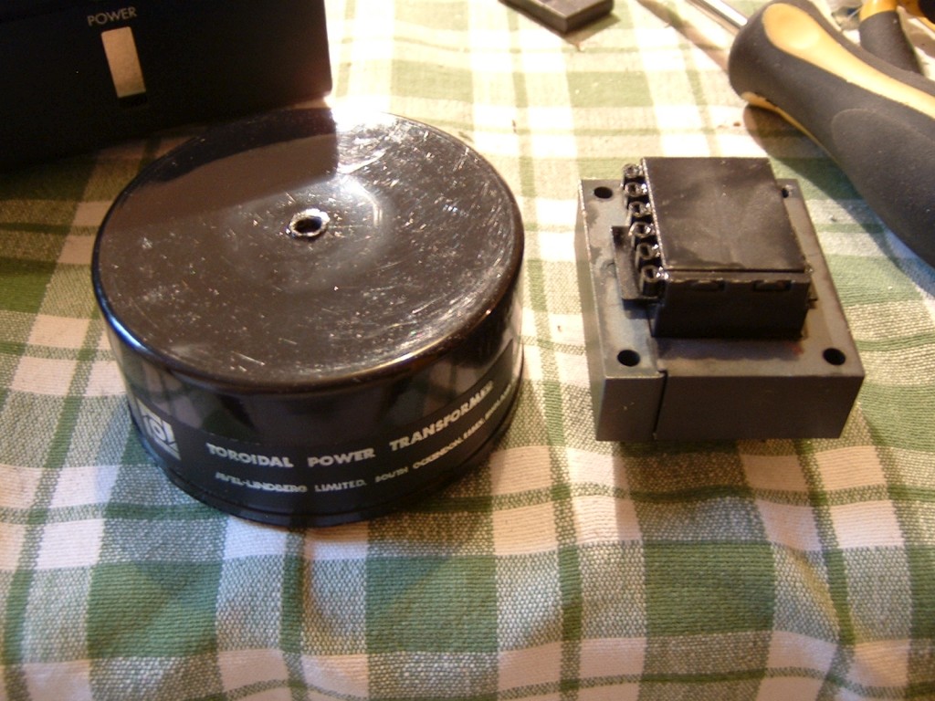

Audio tx upgrade
I chucked out the old buzzing audio section transformer, and installed a much larger potted Avel Lindberg toroid in its place. Luckily it was an easy straight swap and this alone made quite a large difference to sound quality. It gives that cleaner "toroidey" sort of sound (you could say slightly anaemic by comparison), but with welcome increased dynamic snap.

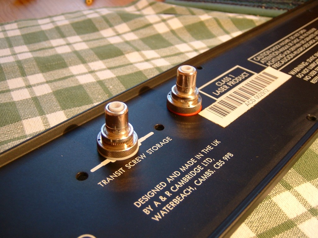

The output section will be replaced by my Pass-designed "D1" stage, which uses quite nice parts. I somehow broke one of my S Power regulators, however, so need to fix that before I can use it. It runs of +-30V. I used this stage in my old Philips CD650 and absolutely loved it! The new output sockets are CMC silver over copper. About as good as they come and well worth the money.

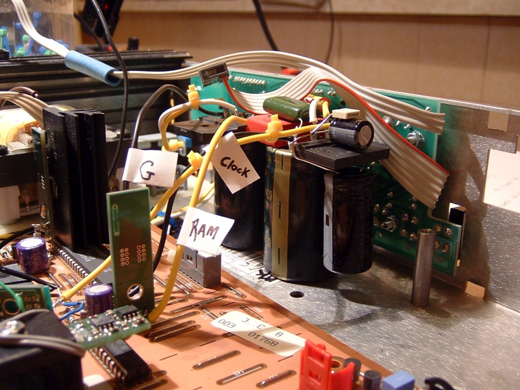

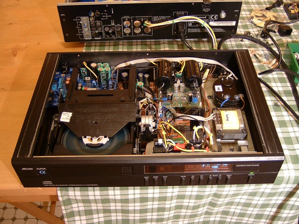

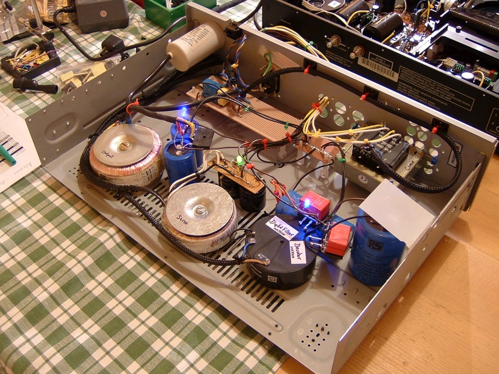

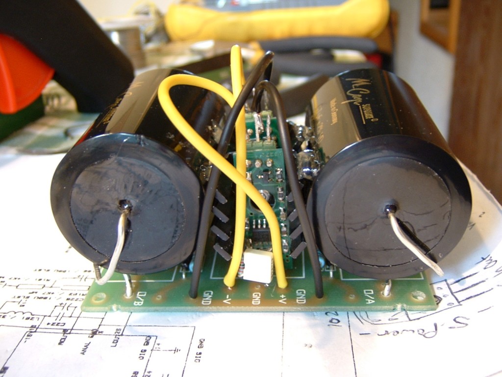

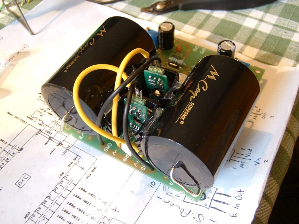

I've attached a recent picture of the player. The output stage, servo section, digital filter and decoder all have off-board supplies. The clock and RAM use new supplies in-player but with an off-board transformer. Past experience tells me there's something not right about using an off-board supply to power a clock. I had spurious noises in a previous player doing this :eek:
There's about 400VA of transformers (4 toroids and 2 frame type) and maybe 120,000uF of smoothing powering the player now.
The clock psu is a bit of fun. I thought I'd bypass the 10,000uF smoothing cap and went overboard with: 4700uF, 330uF, 2.2uF, 330nF and 82nF. The sound did improve when I implemented this and the RAM psu so I can't say it doesn't work to some degree!
