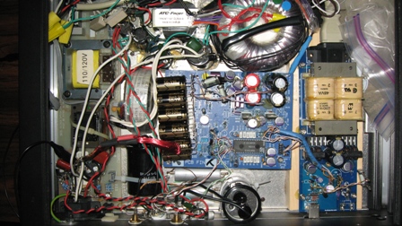

Wiring tweak pictures for your amusement.
No amusement - I like seeing inside your machine and oh.. those lovely open frame capacitors - I like them - kind of military looking.
Did you have some spike issue to get rid of or is this a result of the Radio thing ?
In fact, have you cured all that interference / crosstalk stuff ?
Hope so.
Have you now decided on a new layout for the offboard ps too ?
I will be loading my spare case with traff's this weekend and this issue could not have come up at a better time.
Can we just fire in clean smoothed DC via an umbilical to the player ?
Or would these DC lines be susceptible to interference too ?
The 4.7 or 10 ohm resistor trick - would they go on the secondry AC lines prior to rectification and smoothing ?

AndrewGM;2647619... is that 5 traff's in there under the stuff ? Andrew[/QUOTE said:
There are transformers for the clock, the PCM2706 (usb to Is2), the arcam board, the valve b+ and the filaments. One toroid on its side is actually employed as a choke on the B+. The toroids are all Plitrons that I got at surplus stores for under $10 ea. There are a couple trans not active from their former cd duties.
It looks like a birds nest, but I actually did put some thought into the path everything takes. The signal comes in the usb, hits the 2706 -> the 1541 and out via PIO/teflon caps to outboard tubes. Nothing else in the path and pretty much a straight line and well away from everything else which is basically power supply. Transformers, rectifiers and first filters all clumped and then feed DC to consumers which have final filters. Seems to work well because it is dead quiet on similarly simple path to tweeter. Only 2 more resistors (passive attenuator) from the tubes to drivers without cross over. (One more BG on the tweeter). I find everything that gets in the way somehow removes something. The PC is equally critical. I use CICS/CMP2 (another great story) and devoted to simplicity.
I doubt the BGs are worth it. I figured I was building it and there were a few available at reasonable price so almost for the nostalgia sake I grabbed them and put them in. They certianly don't hurt, and since your DEM change I am getting tons of texture. I must say it is the oscon sep caps that made the most impressive gain on sound quality.
