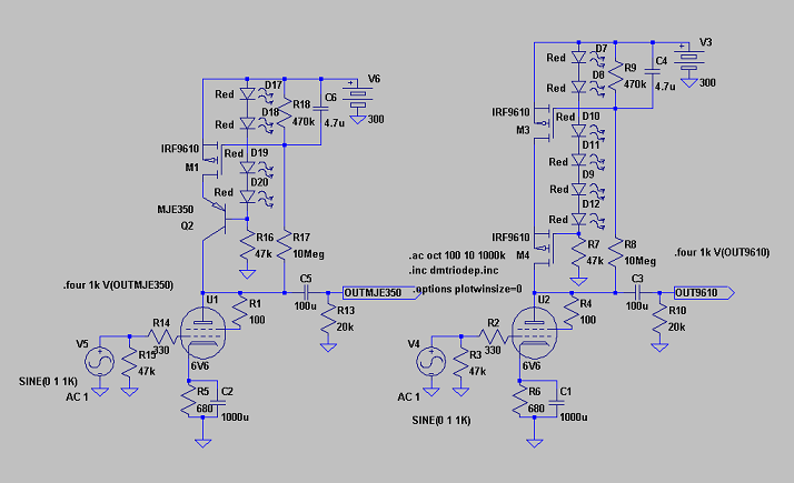

These are the circuits.
The recommended BJT has a tad higher THD but more important, it has LOWER 3rd and uneven harmonics.

SY said:
Longer tube life? Do you mean because of the inability of the bias voltage to adjust itself as the tube ages and starts getting gassier?
Yes, I mean that negative feedback on DC that we loose stabilizing an absolute value of a bias voltage.
I missed this thread before, sorry. Otherwise I would have commented on your very clever circuit. That's an interesting variation on a CCS. I use gyrators for active crossovers, but never have as a plate load. Excellent idea!
Thanks! It was a logical evolution of this servo (a first, I decided to load the tube on a CCS, and then decided to shorten the servo path so it's impact on the signal will be less audible):
As I mentioned earlier you must use the Ua/Ia-curves to decide workingpoint.
With 6V6-trioded, B+ 300V , Ia 20mA, load above 10k and the BJT/Mosfet version, we can swing between 65-70V and 290V. This means the workingpoint should be choosen at ca 180V. This is where you will get symmetric clipping and max output.
For valves with a lot of voltage swing, such as your examples, I guess you would need to drop quite a bit of B+ across the transistors, but what about a preamp with only a few volts swing?
In post 55, Revintage quotes an equivalence to about a 60H choke. One of the great advantages of loading an anode with inductance is that it allows you to run off a lower B+ while still maintaining your voltage swing. Does this not also apply with this circuit?
No, it is not a real coil that saves an energy in a magnetic field, it is an electronic simulation of a coil that spends an extra energy to work. But it dissipates much less of an energy than a plain resistor would do for the same results.
