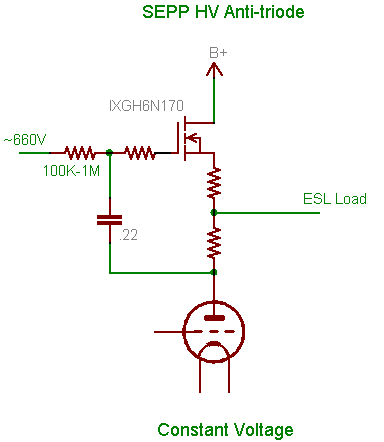

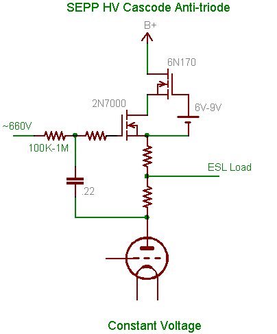

kenpeter said:Yeah, AC like what Michael was saying. But DC to center on 660V
no matter how the tube(s) age. Just like Wavebourn's Gyrator.
Just need a slick way to do both in one circuit what don't splodie.
This should do the trick. Constant anode voltage, no matter
what. Still sources up to 2X Iq and reduces Zo by 2X as in
the constant Iq version.
This circuit is also very nice as a fixed bias driver.
Lars, here's a low capacitance MOSFET - 2N7000 -
but it's bootstrapped by the source resistor anyway.
Michael

revintage said:Hi Michael,
The 60V 2N7000 is N-channel and will not work in Wavebourns circuit. Any P-channel suggestions?
How about the Vishay TP0610K? I'm looking at this one for use as the
constant voltage device in a cascode active-loaded "ultra" cathode
follower:
http://www.datasheetcatalog.org/datasheet/vishay/71411.pdf
Michael

kenpeter said:Michael, I don't see why bother with a two device cascode?
Don't you have a handful of those 1700V IGBT's to burn?
IXGH10N170 - I think it was???
I don't think either the gate or the miller on those is big
enough to necessitate a cascode to divide those chores.
6,300,000uMho's transconductance doesn't need much
drive signal into the gate to swing the anti-triode, even
if that gate is 700pF. Reverse transfer is still only 14pF.
And enhancement mode no problem in this context.
I believe you're right, there might only be minor differences in the
operating point and slight nonlinearity of the current mirror action
between a cascode and the single device. And I think in this circuit
Ciss is bootstrapped; Crss and Coss are not big problems.
It's a plate voltage regulator and a ripple filter and a power
doubler and a plate resistance divider.

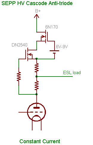

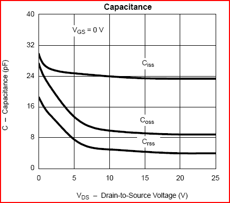

MJK, do you have any ideas of what value the two "source" resistors in the triode-antitriode configuration ideally should be? Reread the thread and found you presented the constantvoltage version already at page one.
My main concern is if the internal caps of the DN2540 really shows up on the sims? I use the Supertex Spice model.
But at the moment my own interest is to find an "el cheapo" sand-replacement for an anodechoke.

You can fake a depletion mode device in any of several ways....
And in the process, buffer out any excessive gate capacitance.
Especially effective when gate drive is bootstrapped to present
a very high pull-up impedance.
All MOSFETS (or IGBTs) shown are Enhancement types.
Didn't bother to draw a simple battery biased MOSFET,
but should be considered alongside these other choices.
I think Michael's latest anti-triode eliminates the need for
depletion mode anyway.

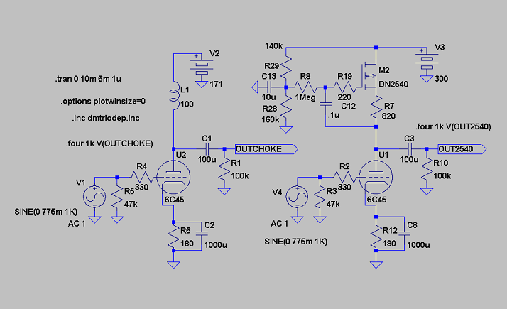

Hey kenpeter,
Whats wrong with an actual depletion mosfet? DN2540 is reliable and easy to deal with.
Did a few sims with the single DN2540 circuit of my last schematic and triode anti-triode with 2*390ohm and the only difference where that it added slightly more 3rd order distortion. Think it might only work when connected as CCS.
Well, driving a 100K load I wouldn't expect that much difference...
Driving a difficult load might be something else. Anti-triode helps
flatten the loadline seen by the plate (by half) for sure...
Gate capacitance might be ignored when the channel current is
constant. But its a factor for a load expected to be an active one.
