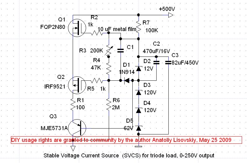

But, in the circuit I built, the bootstrap cap RC cut off seems related to the plate resistance. I say this because the required cap value makes sense referenced to the plate resistance, but makes no sense related to the voltage reference resistor. And Lar's comments seem to suggest this ("seem to suggest" - I certainly could be interpreting it wrong).
Another tidbit that may or may not shed light on the matter: I measure the voltage (80V) on the input side of the 1meg voltage reference resistor. I measure about 74V on the gate side. However, if I measure across the resistor, I get a couple of mV. I just assumed that the apparent drop with the first measurement was due to the meter error, related to the high impedance of the resistor interacting with the cap and the meter circuitry. Remember the circuit works and all the other values I've measured make sense (voltage on the output, g/s voltage for the FET's, etc.).

Ah, it is not about time constant in gyrator; it is about quasi-inductive load of triode, so frequency response depends on inductive resistance and internal resistance of triode that due to feedback by current increases on Rk * (mu+1) value.
Thanks.
In the above case, the internal resistance is about 9k bypassed, and about 22k unbypassed. The F3's appear proportional to the internal resistance, but certainly not derived from plugging the internal R and bootstrap C into the usual formula. How do I account for the inductive resistance?
Practically, it's easy to just try a couple of cap values to get the needed bandwidth. I'm just curious as to how this works.

AFAIR, it is close to time constant multiplied by resistance of the resistor from source to output, if transconductance is infinite.
Here is what works like a charm; actually it is a gyrator. You may use MOSFETs here, or at least one on top to increase voltage divider's resistance and decrease capacitance needed.
It does not provide a constant current on DC. Actually, on DC it provides a constant voltage, but on AC it's dynamic resistance is huge.

Even though I've used the higher voltage version of this circuit as a straight drop in several times (with great results) I still don't really get it. I see the base of Q2 staying at a fixed voltage and having the Vout adjusted by changing the operation of Q1 - but how does it work?. Would anyone be so Kind as to explain it?
[/QUOTE
I'll try. Start with Q1, R1, R2, and R3. Connect R3 to ground. With that you have a basic current source, as the voltage drop across R1 is kept constant (subject to the power supply ripple).
Add C1 and connect R3 to the plate. Now you have a basic gyrator. The voltage divider now is referenced to the plate for DC, but C1 keeps the voltage across R2 constant for AC changes at the plate.
Add Q2, D and R4. Now you have isolated the drain of Q1 from variations at the plate. This makes the basic gyrator into a high performance gyrator.
