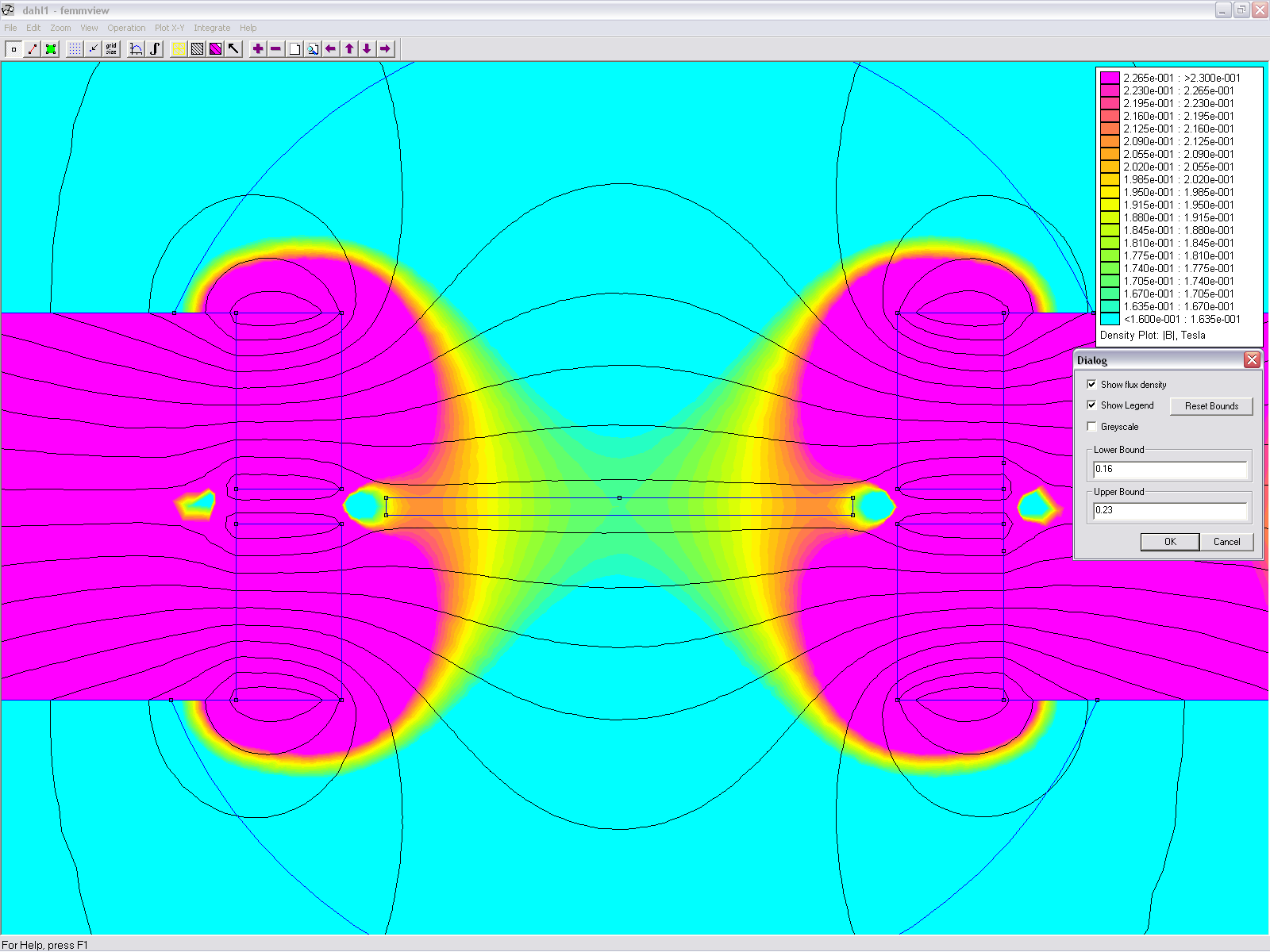

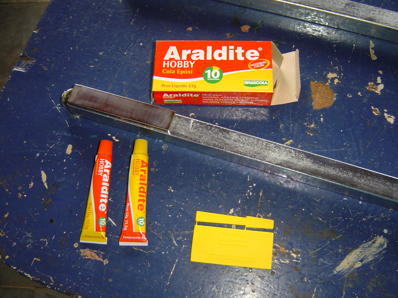

The magnet force direction (N to S) is actually the main force and direction.
Otherwise the speaker would not work.
You are however right in the sense that magnets will repel just by sitting side by side but that is just a small force compared to the force between N and S pole.
If You had been more precise in the force arrows, then they would be facing diagonally as they are very much affected by the other pole bar.

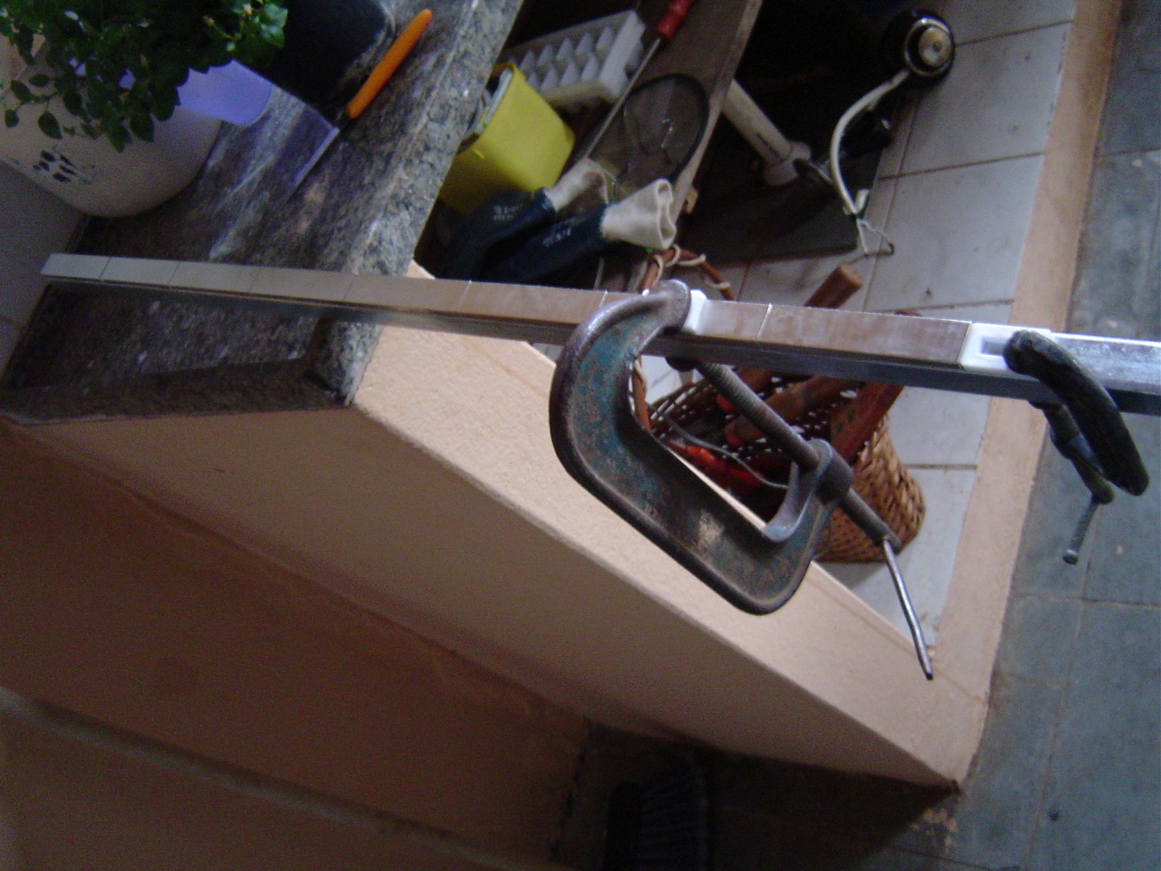

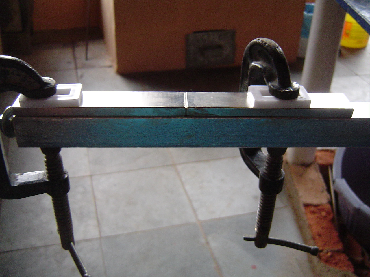

Even with glue, ultil it was dry, i needed to place a holder when i was assembling my tweeter. So i can affirm that you need alot of strength to place they touching each other on the steel bar. It's hard but not impossible! :D
Now, i took off all magnets from the steel bar, broke off some magnets (i have some spares) and now i'm making a new enclosure :p
PS: Femmview is from Dahlberg site.

The FEMM-picture is from Dahlbergs own design with 2 rows of magnets side by side with a few mm spacing between each row.
This is to get a more even/straight flux field for the ribbon that You don't get with single row.

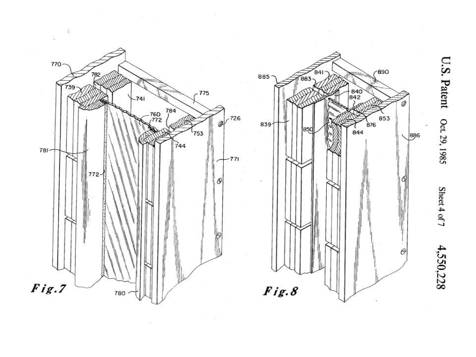

I attached one image of the midrange ribbon structure used in the 1984 Apogee Fullrange Speaker. As you can see Apogee also used two rows of magnets with a small gap between, and describes in the patent how this provides both an improved uniformity magnet field and also an improved self centering capabilty. This 2" wide, 84" long midrange ribbon is crossed with 1st order slopes at 360hz and 10kHz. Bass is provided by a large planar woofer panel with a single sided magnet motor. Treble is provided by a 0.5" wide x 84" long "dual sided" ribbon ... a front and rear ribbon separated by 0.5" in the same field gap. The longer tweeter ribbon provides enough ohms of resistance to not require a step-up transformer.
Personally, I have gotten the best results using a single wider magnet.

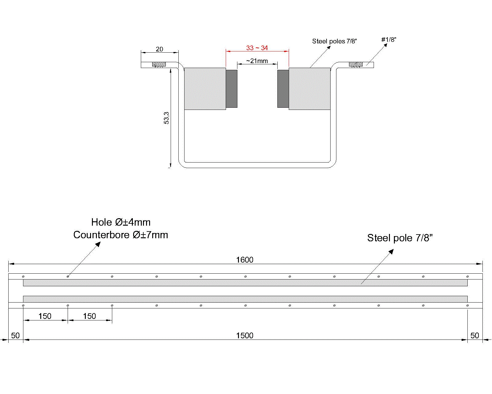

I'm not an artist when drawing, but i drew this layout for my ribbon tweeter shield (and magnetic field "amplifier" :p), i did the thickest i can (hydraulic bender is limited 90° edge in #1/8 plate).

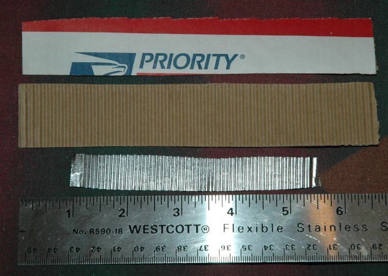

Ribbon Pleating Tool
Here is a pleating tool that is totally FREE! get a USPS Priority mail box like the 12 1/16 X 2 11/16 X 13 7/16 size. Cut off pieces carefully of the size needed for ribbon length. Wet them until the brown side comes off easily. After drying, ready to use. These make about 7 total pleats per inch, 14 angles.
