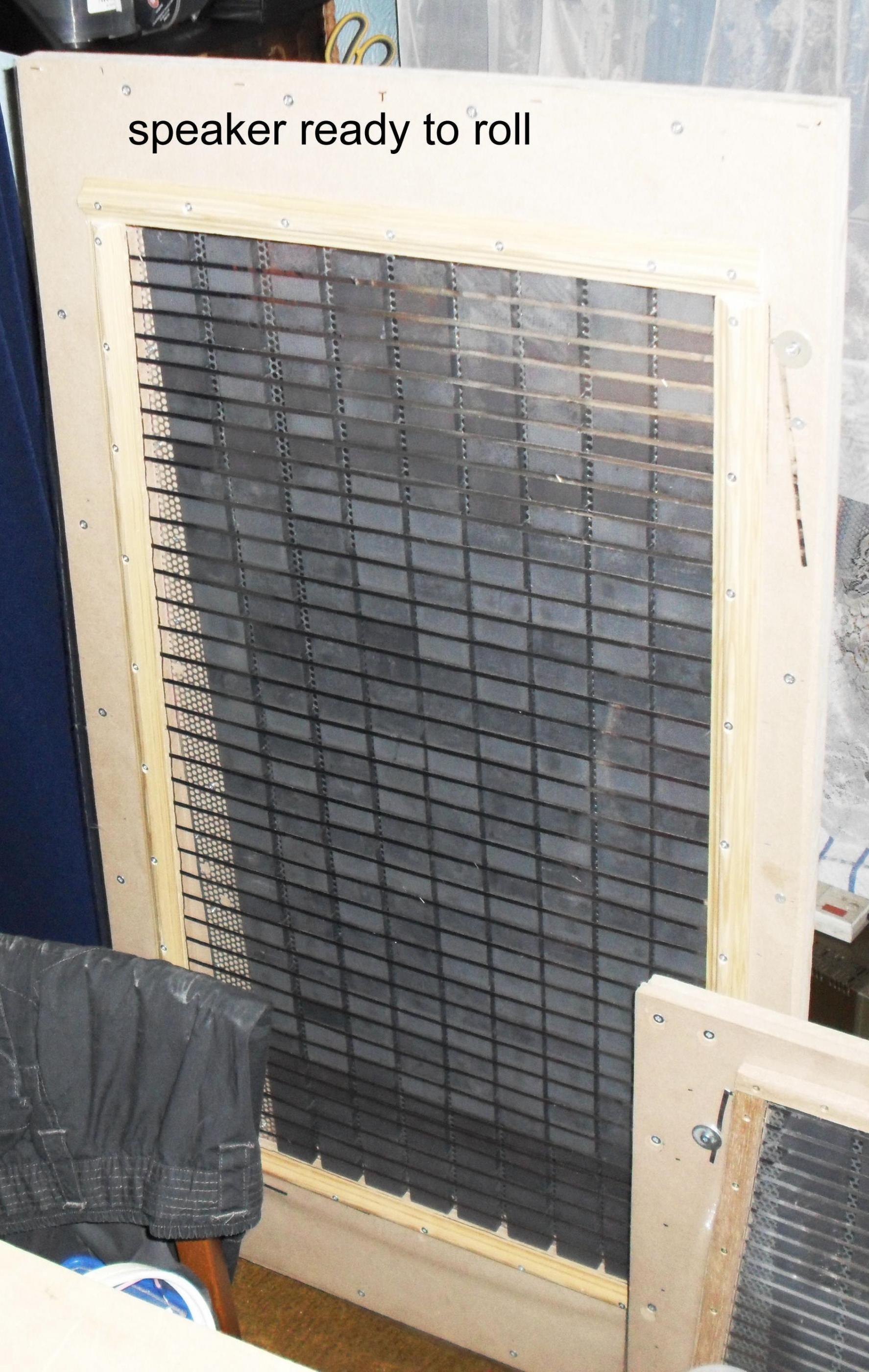

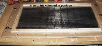

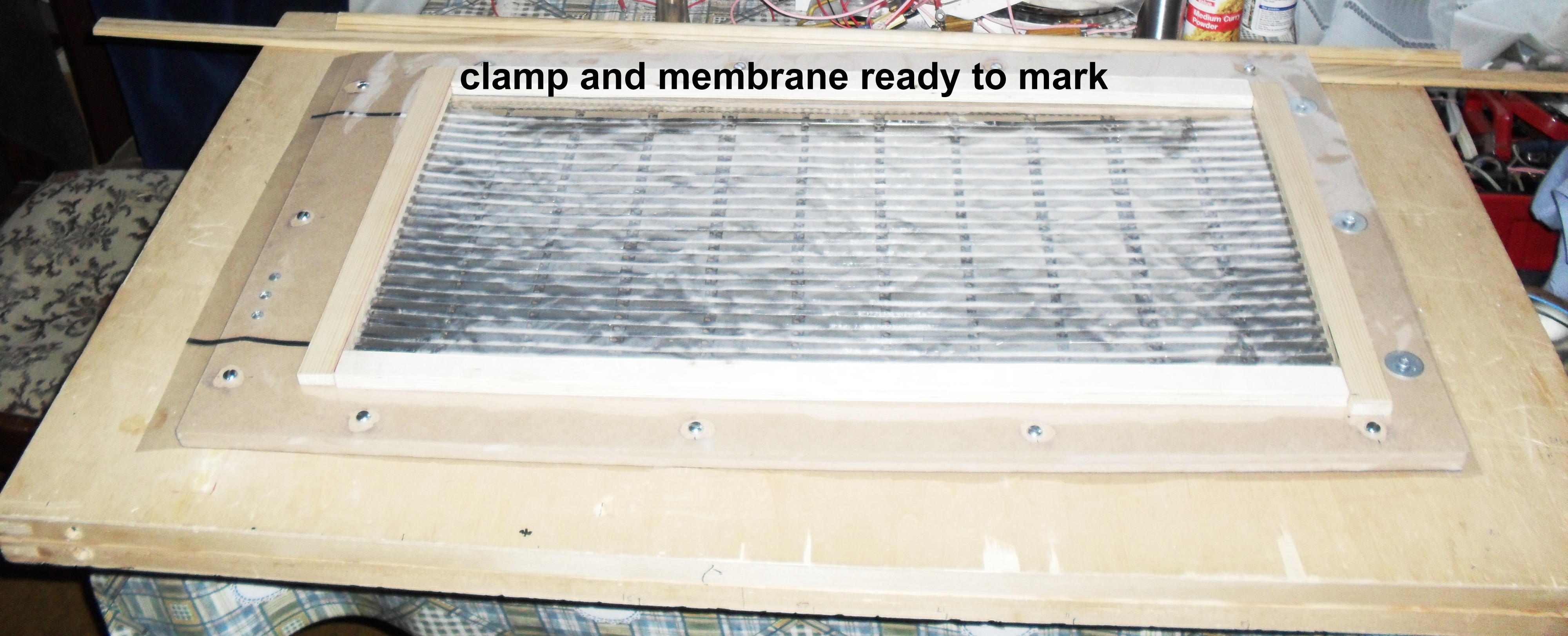

Some more pics

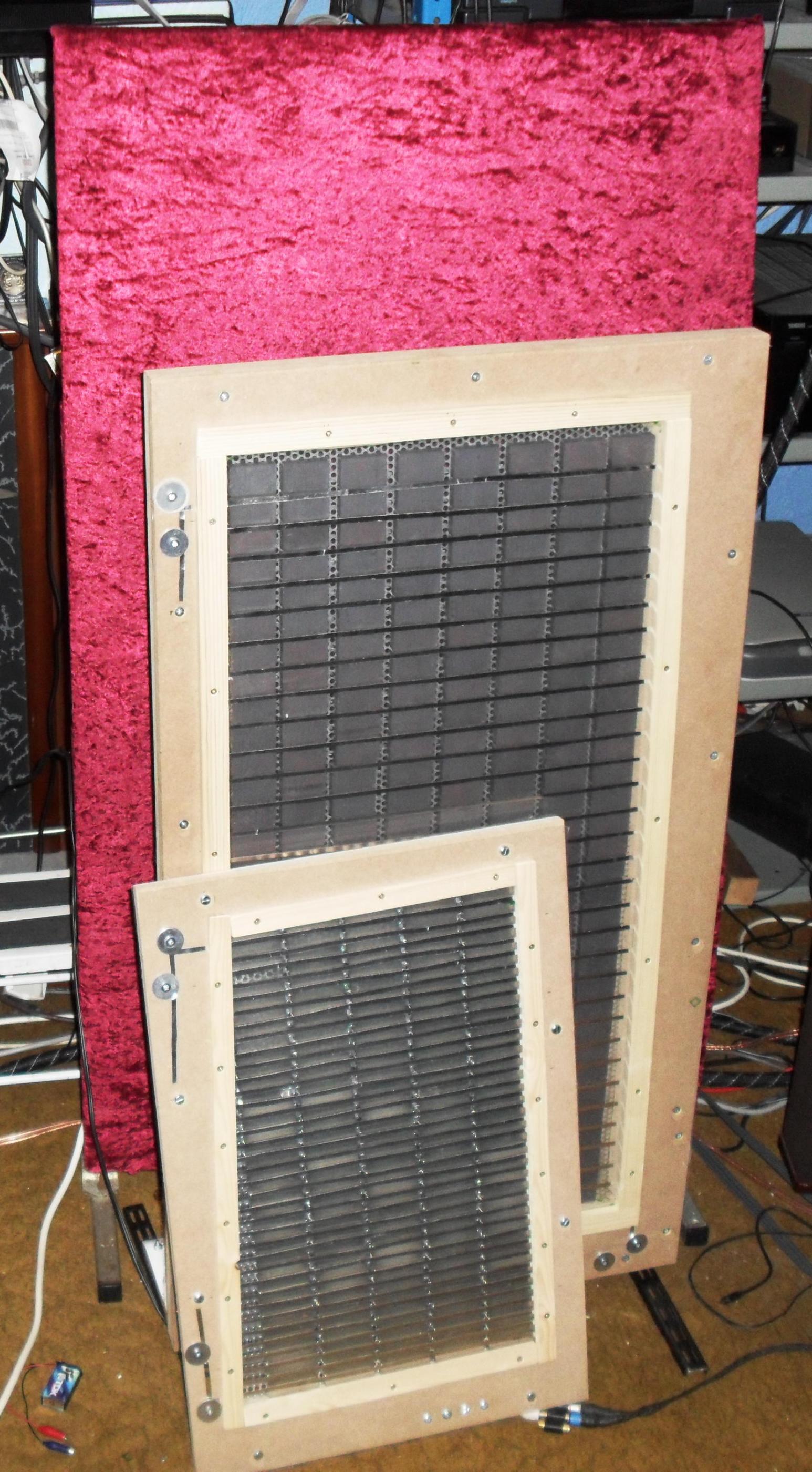

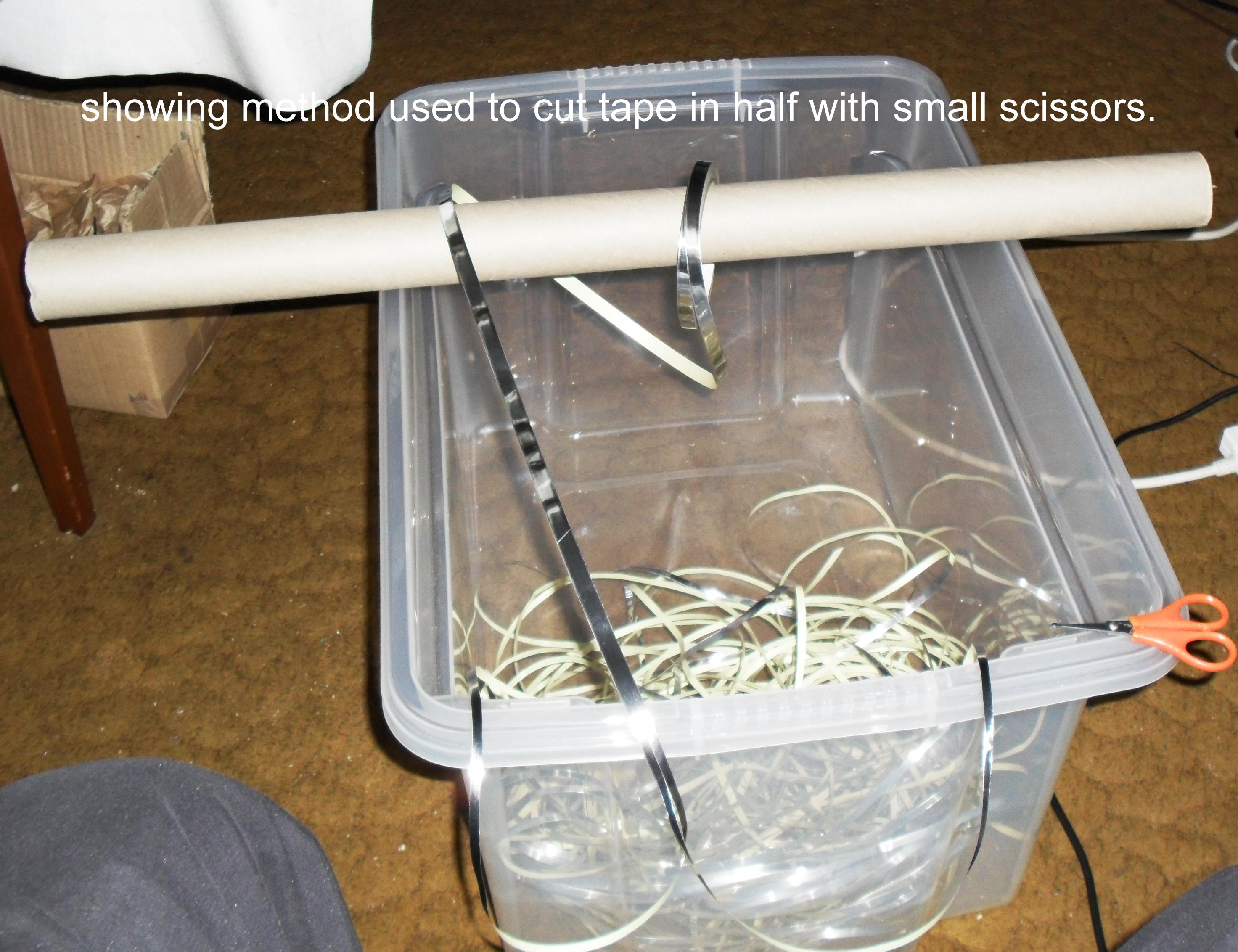

Some more pics to help any body contemplating building FRP.

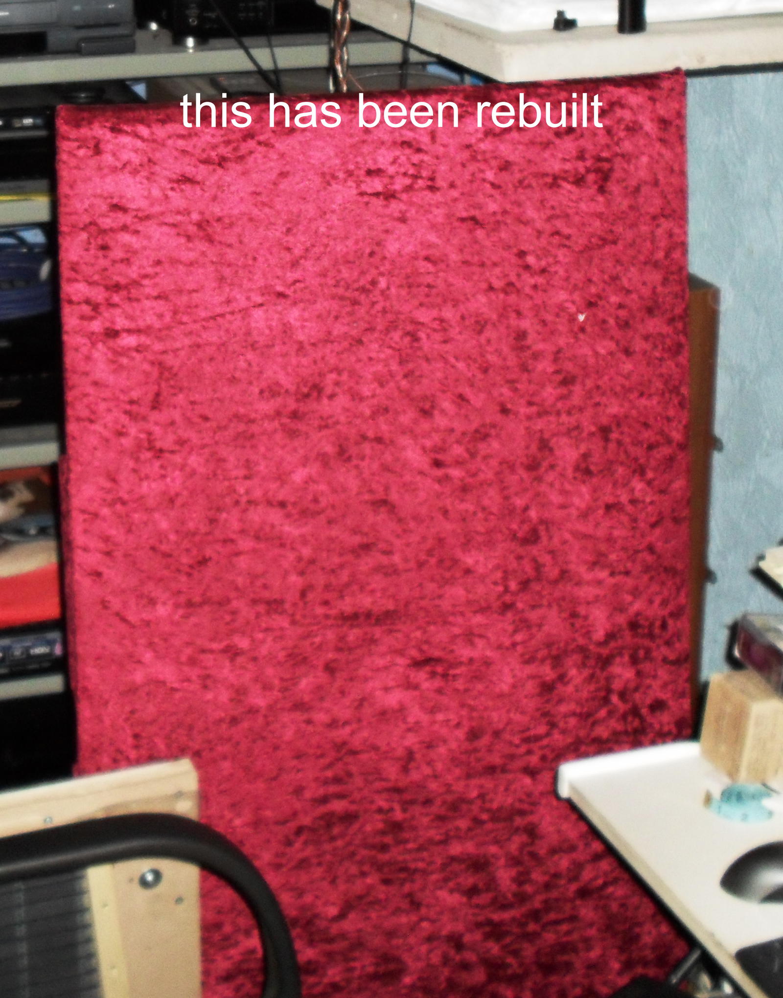

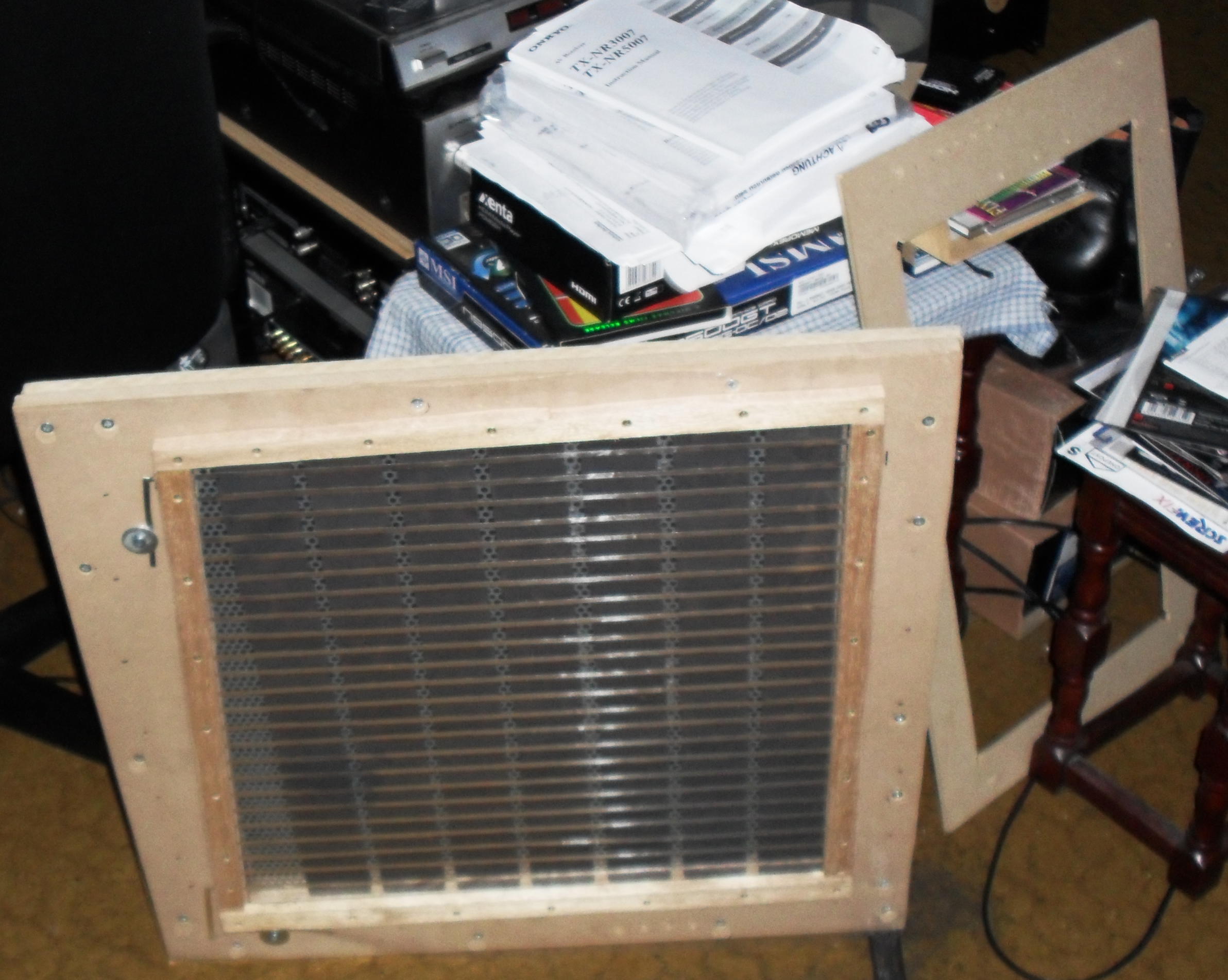

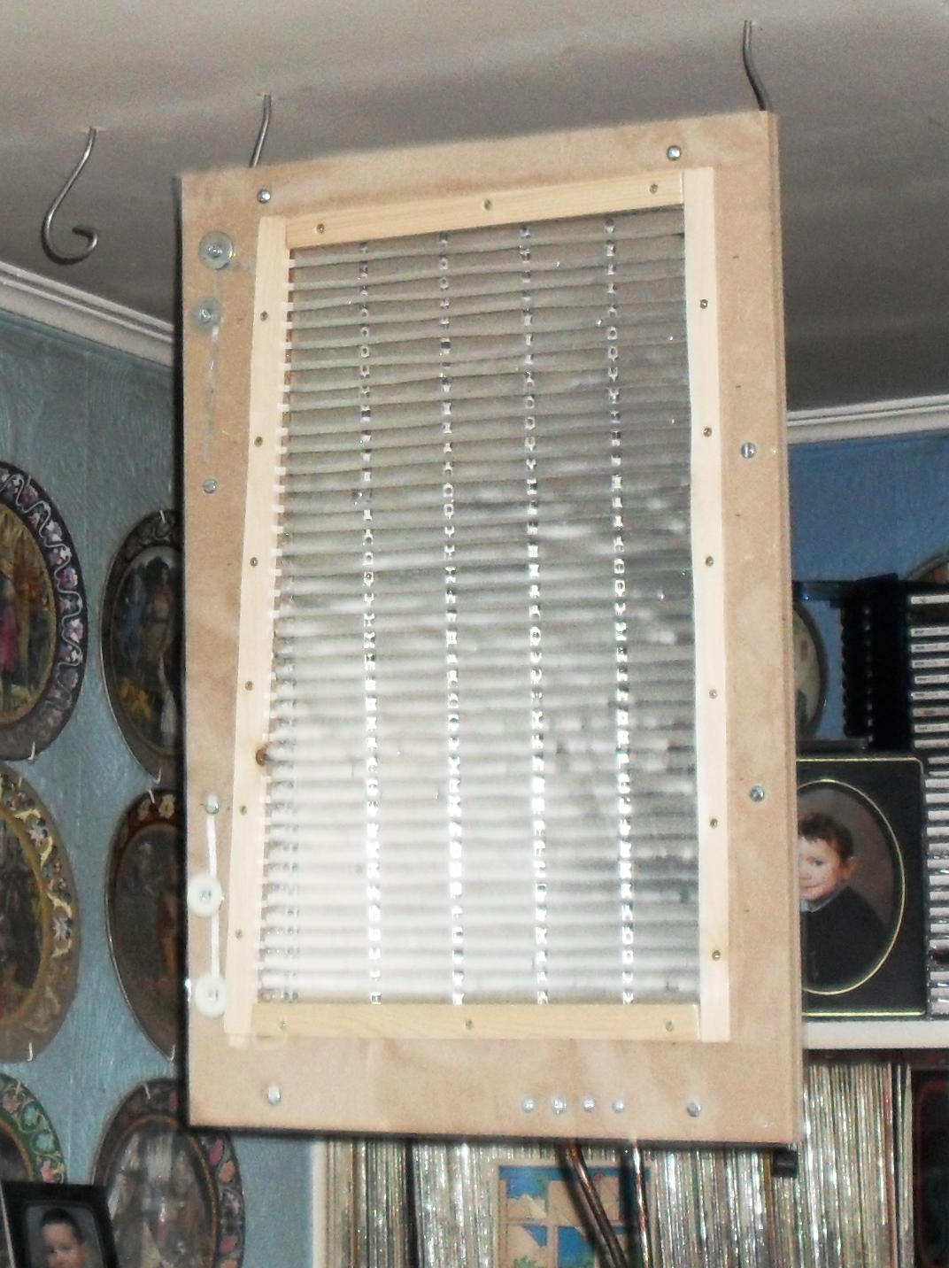

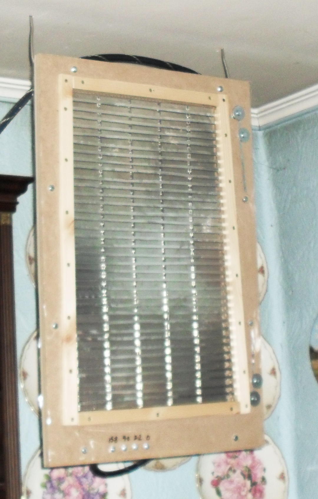

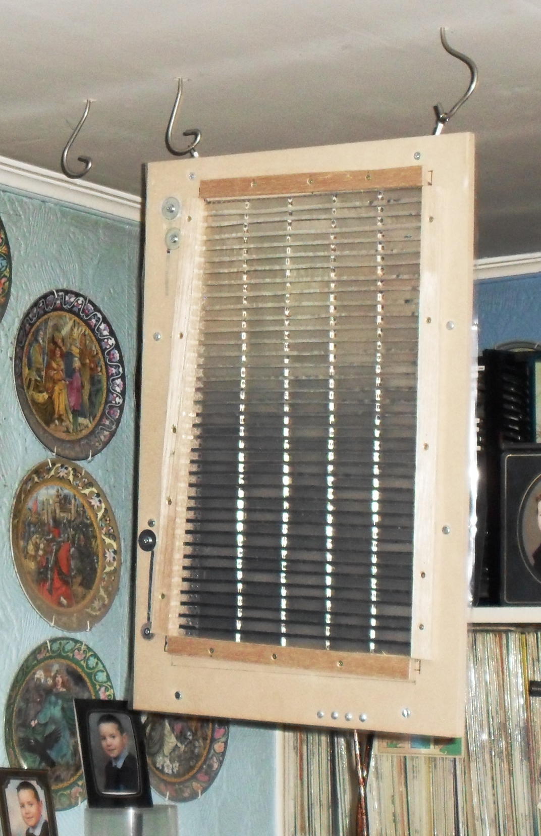

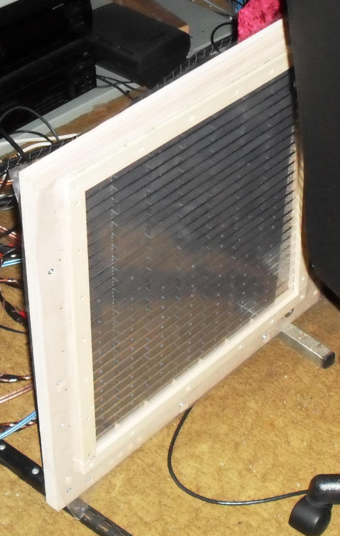

Some more pictures of my work.
Here we go again there will be more pictures when I can reduce the sizes

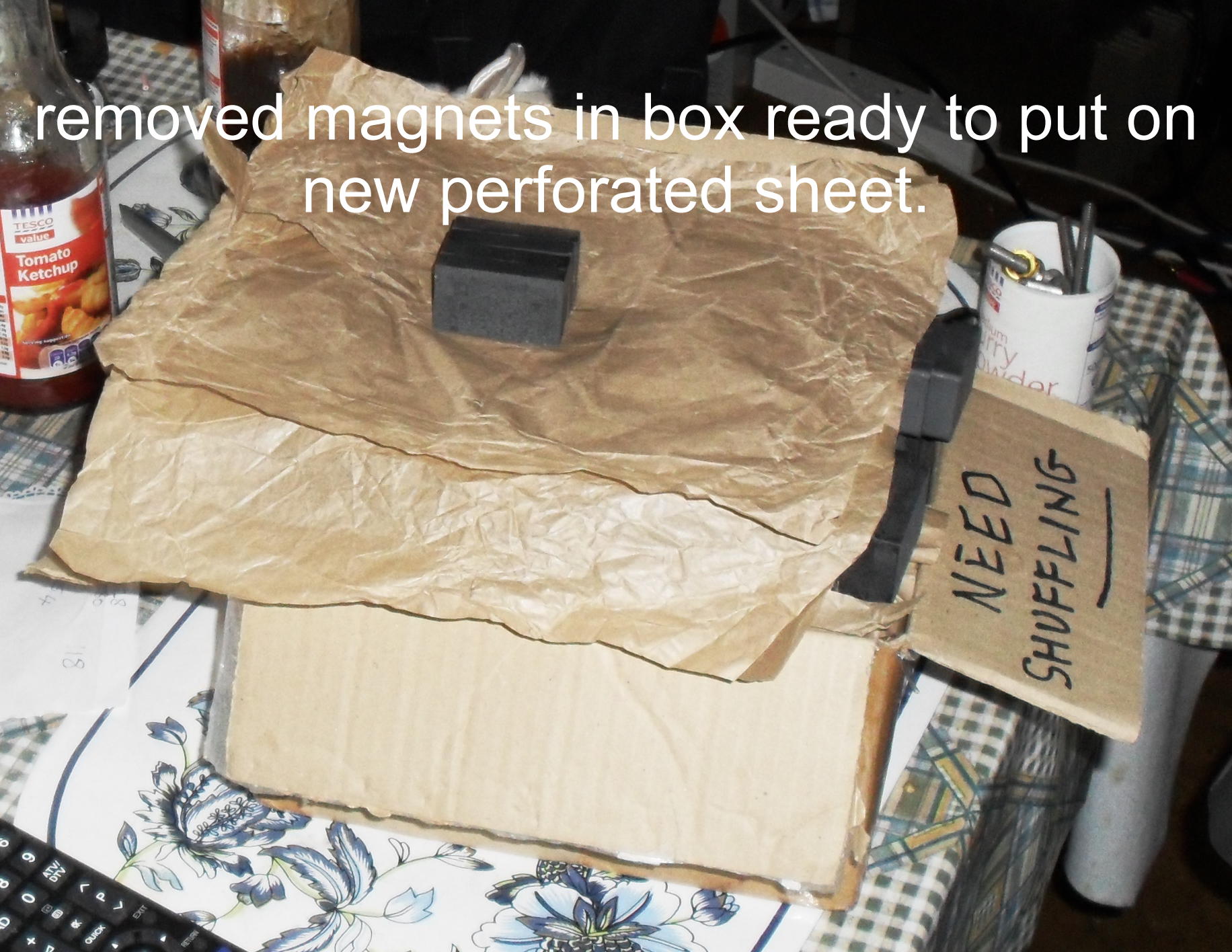

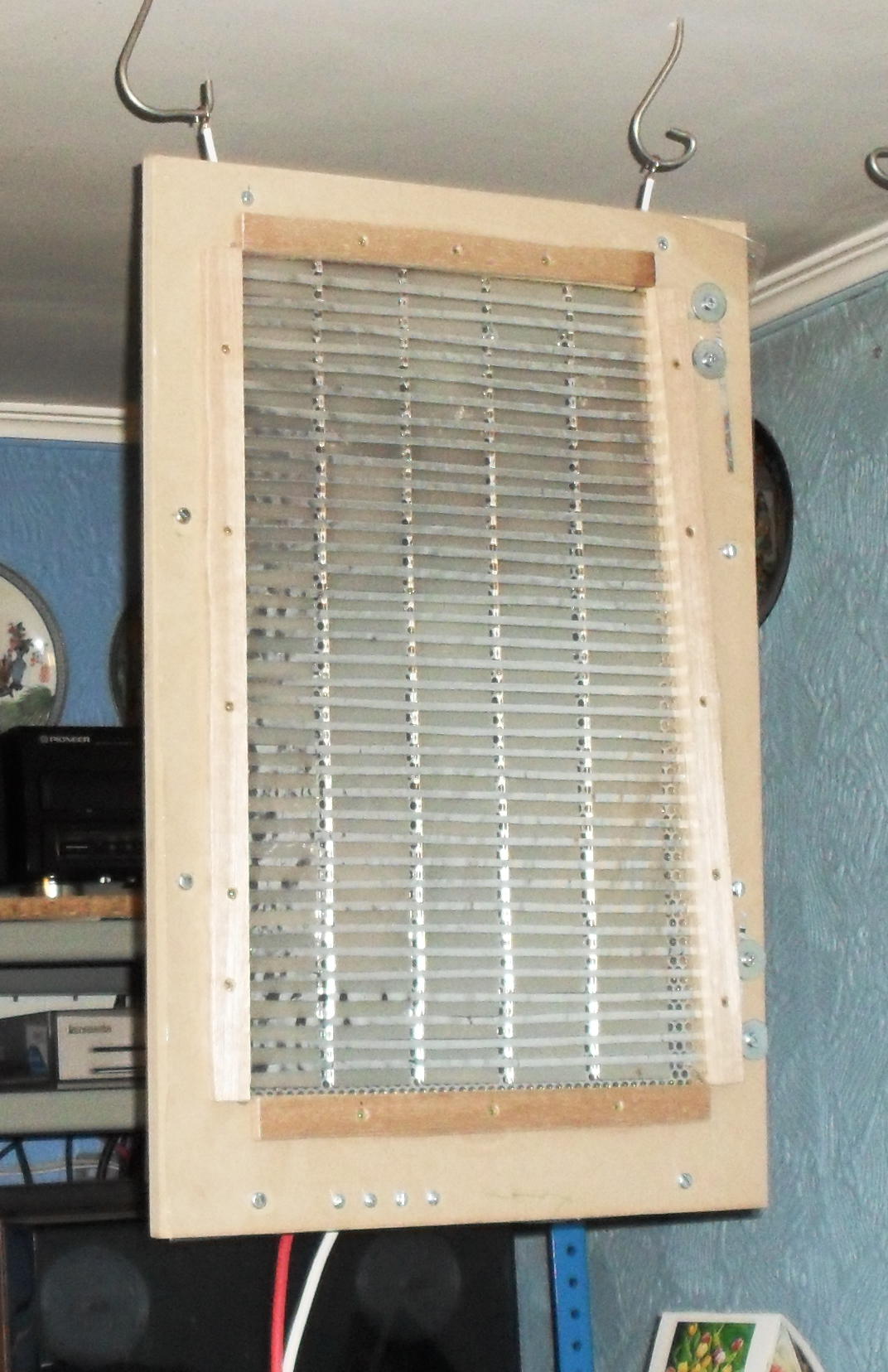

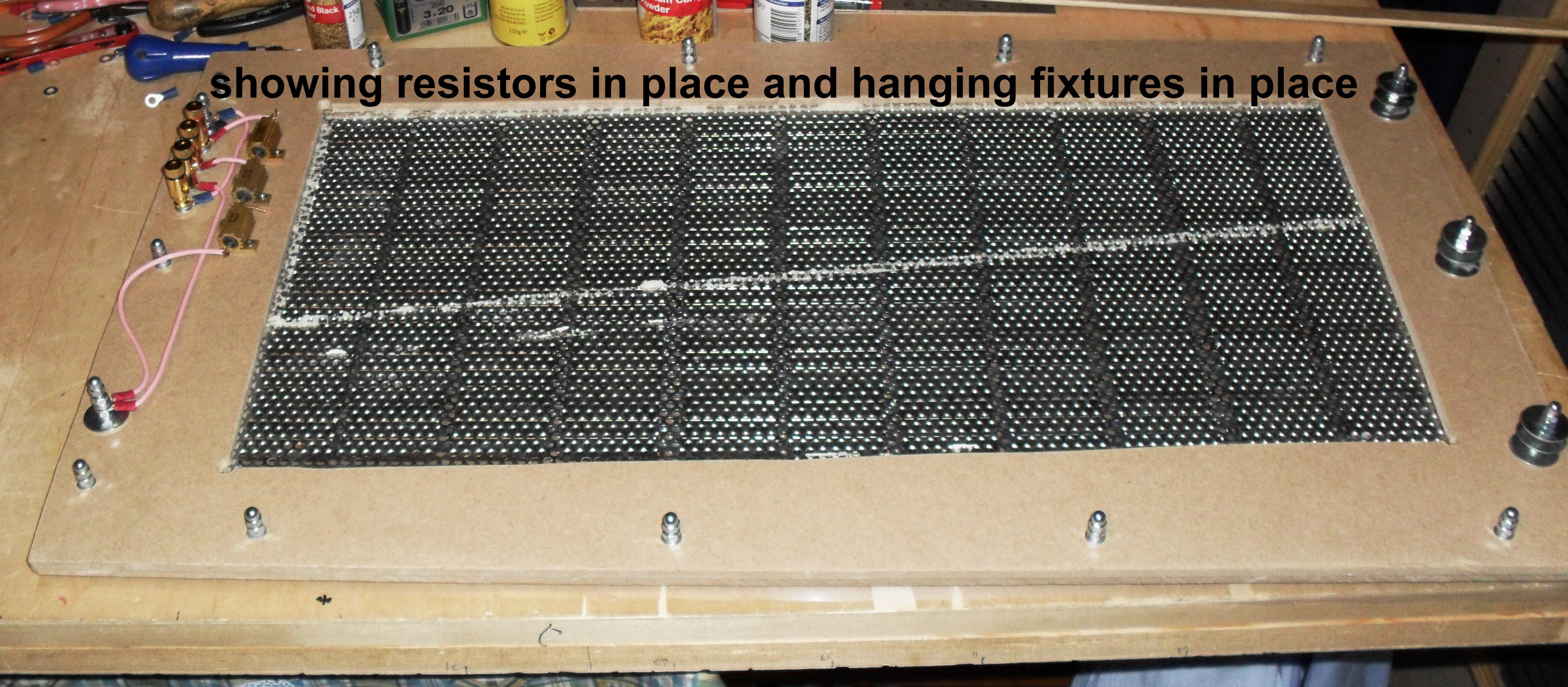

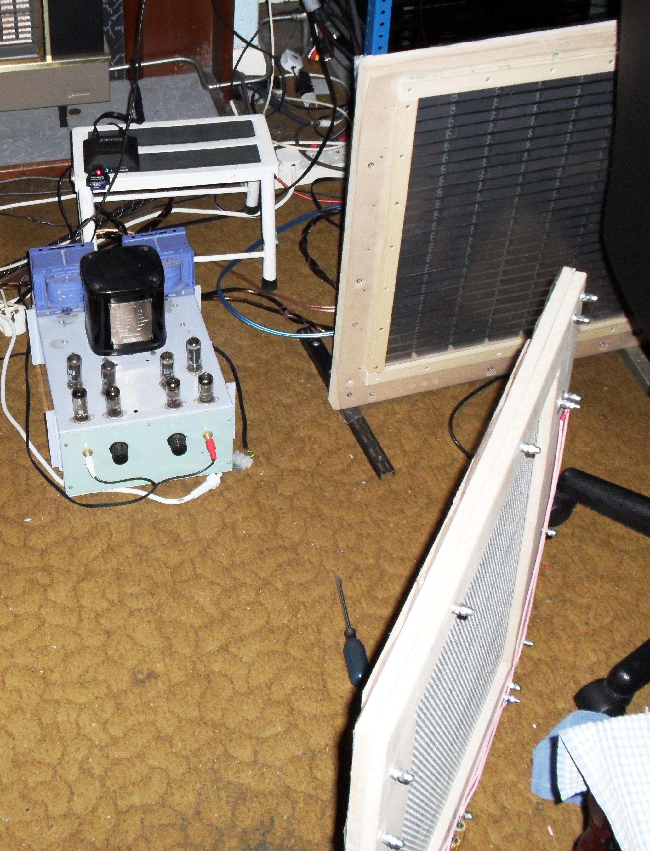

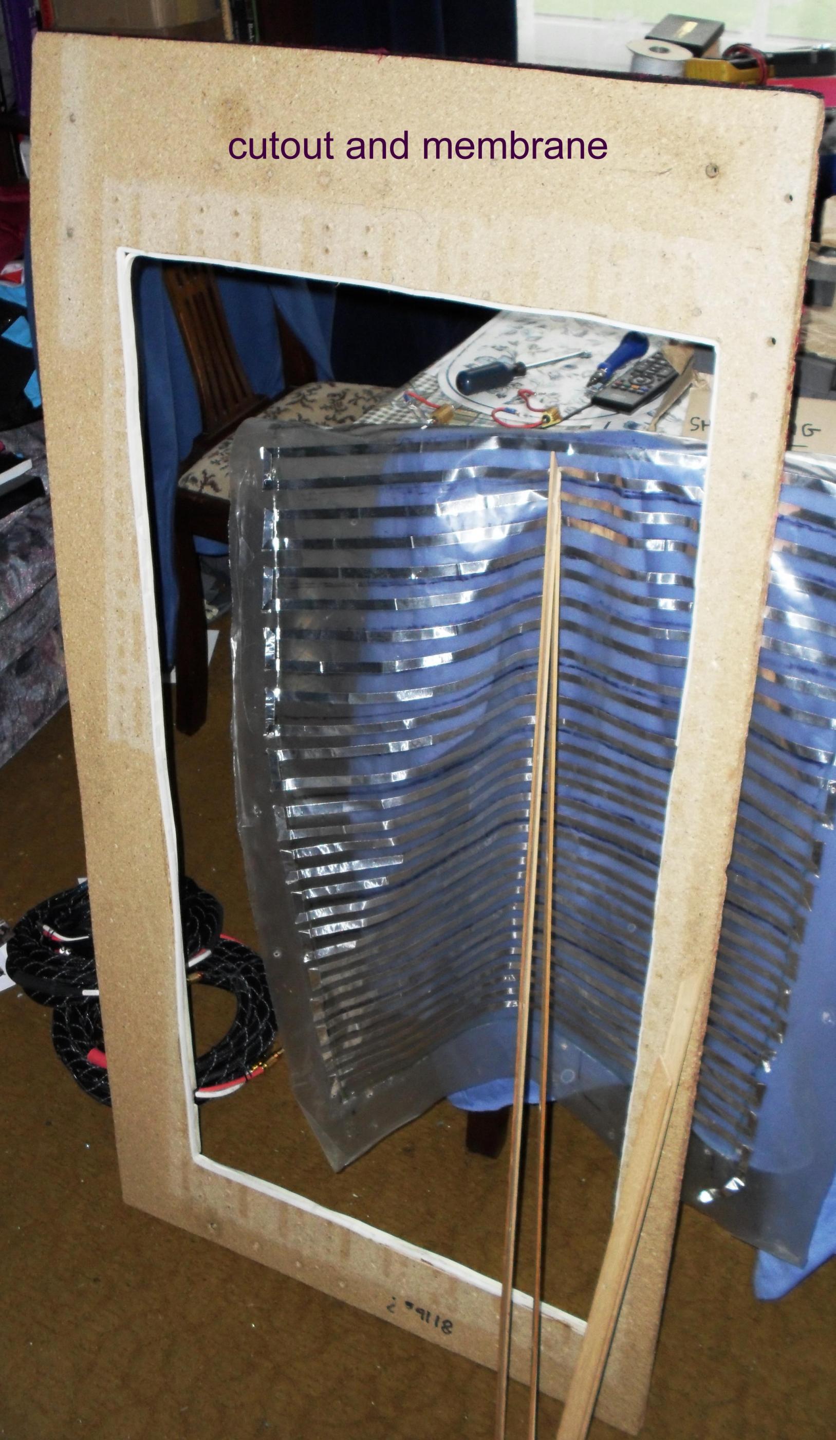

tinitus - Good advice on the magnets. The site lists them as having nearly 55 lbs of pulling force. I'm able to get them apart by sliding them apart and twisting the magnet so it is at a 90 degree angle to it's neighbor. Then I can pull them apart.
FYI, the ribbon is basically the same as my original prototype (attached) except the magnets are twice the thickness and the frame is also bigger stock.
BTW: I got my ferrite toroids today but I just found out the steel is back ordered so I don't know how much longer it will be. I won't be making much progress until it gets here.

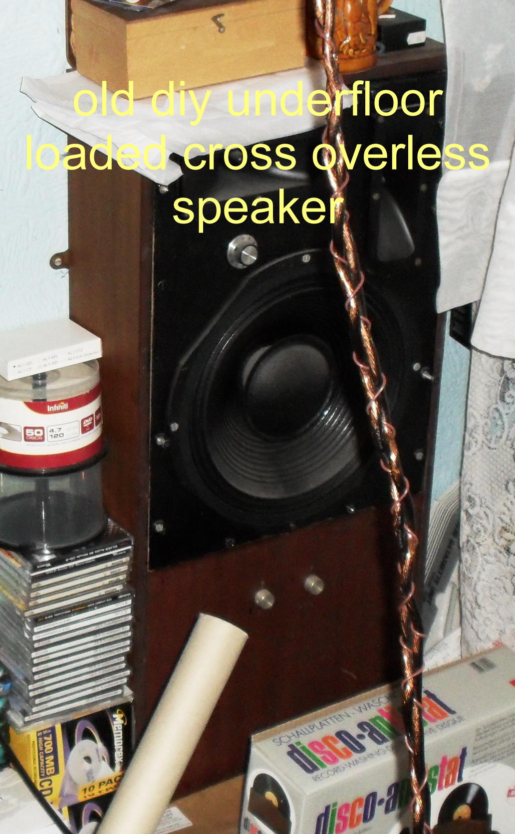

Hi everibody, I´m new in the forum.... I dont konw how to do for some help with my DIY loudspeaker project.....
I just made a pair of 60cms. ribbon´s tweetters; that´s appear in this danish website
Byggbeskrivning för den neodymiumbestyckade band (realy good tutorial)
the ribbon cut of 400hz (works in meddle a high freqency) and the sound is amazing!!
but, Now I want to do a woofer that works good with the ribbons and down of the 400hz!!!, ......cut you please give me a hand with it, some alternatives? ...wich kind (close, open box, TL)??... frequency crossover?? 6,5 or 8"?? realy i dont know

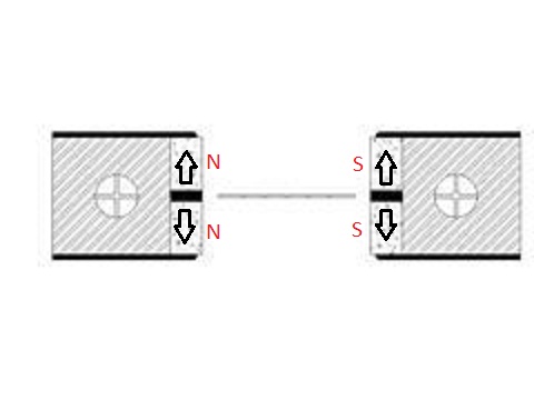

They are facing each other. In other words all the magnets on one side (one bar) are facing the same way and that is towards the other bar of magnets.
As You can see, each bar holds 2 rows of magnets. These rows are just sitting side by side and facing the same way regarding magnet flux.
Otherwise it would not work too well. hehe
