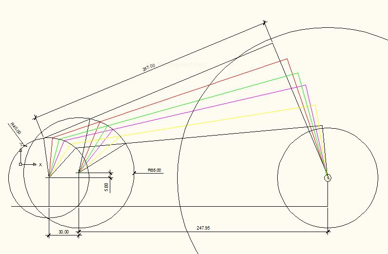

Update:
Its snowing outside, so the things I had planned to do today has to suffer. Another autocad hour has been rewarding. I dont think we have to implement elipses to this idea. There are so many parameters to "relocate" and I believe that playing around with armlength and pivot placing could bring us extreemly close to 100% tangential. Doug, I think you'r on to something:)
Steen
edit.: Center of 40mm radius circle is alligned with center spindle

Wow, thanks for the measurements. Interestingly, the thing I rigged up by eye has the following measurements. Small circle 40mm, big circle 56mm, between centres 40mm and the arm 500mm. So near as dammit and it certainly looks good by eye.

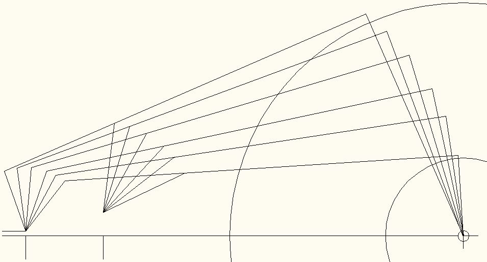

Fooled around today with some needles and cardbard, and found out that if you get it marginally wrong, it has a bad effect on tangens at the stylus point. By increasing the length of all four sides of the "square", this error becomes much easier to avoid. The new measurements I have come up with, are extremly close to 90 degrees all the way across the record.

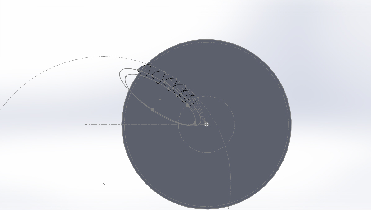

What I meant was I have a full computer aided design suite (solidworks) with FEA (finite element analysis) it also includes a motion analys for interrogating motions and angular descrepancies. The edrawing is a way for others with out the cad software to get a 3D model that can be measured etc

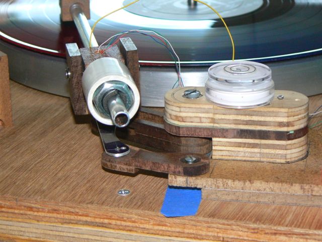

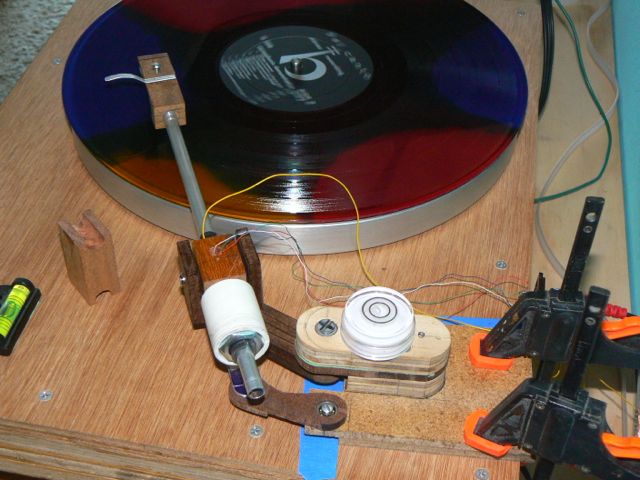

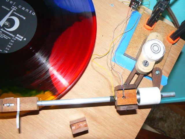

First Sound
I got this finished up last night and put it in the system with an AT95E at the business end.
It works. No stylus hunting, no skipping or mistracking.
There's more to do, but it has the crystalline quality I associate with LTs.

A good sign - usually at this stage of the game, I'm caught up in technical listening, but this arm/cart combination pull me away from that and into just enjoying the music. There's a lot of detail and it so revealing it showed up the inadequacies of the DIY rim drive I put it on.

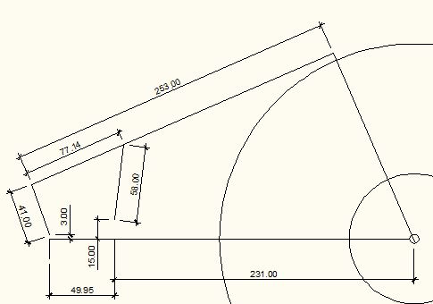

2wice - I hope you're still working on your project. I noticed in the drawing you posted at #903 that the centers of the two circles align horizontally. In my design and Steen's drawings the centers are offset. Am I seeing your drawing correctly?
Gus - yes, get to work. For checking alignment, a strip of graph paper or calendar page, anything with a series of perpendicular lines is convenient. Just punch a hole in one end for the spindle and rotate it as you move the arm. Or you can just attach something like a kabob skewer perpendicular to the headshell directly above the stylus position. If the other end stays centered on the spindle, you're good.
Steen - thanks. I've been at this long enough that there is reusable junk all over my shop. I used the measurements from the drawing in the post showing my model. Your drawings are excellent and I hope to see them converted to a working arm. Could you expand on what you mean by the "square" in #912? Your measurements in your second drawing are very similar to the ones in the arm I built.

canyoncruz - that's a very interesting drawing. I envy you guys who can do that kind of work. I wonder if that drawing shows geometry that applies more to something like the Burne Jones arm DD posted than to the Thales Birch geometry. It's very likely I'm missing something. What kind of information would you need for an edrawing? Would Steen's be sufficient?
