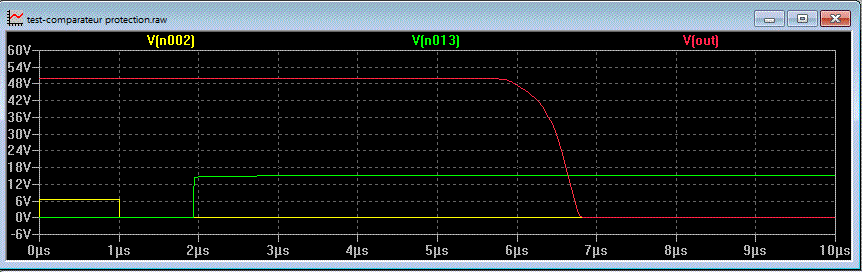

Any error signal of a duration >= 1µs will fire the mosfet in a delay of 7µs for complete cut (from the start point of the error, with a transition time <1µs and a duration of 5sec.

I'm not very satisfied by the response at very high frequencies (> 10Mhz). This is due to the response time of the LM339.
