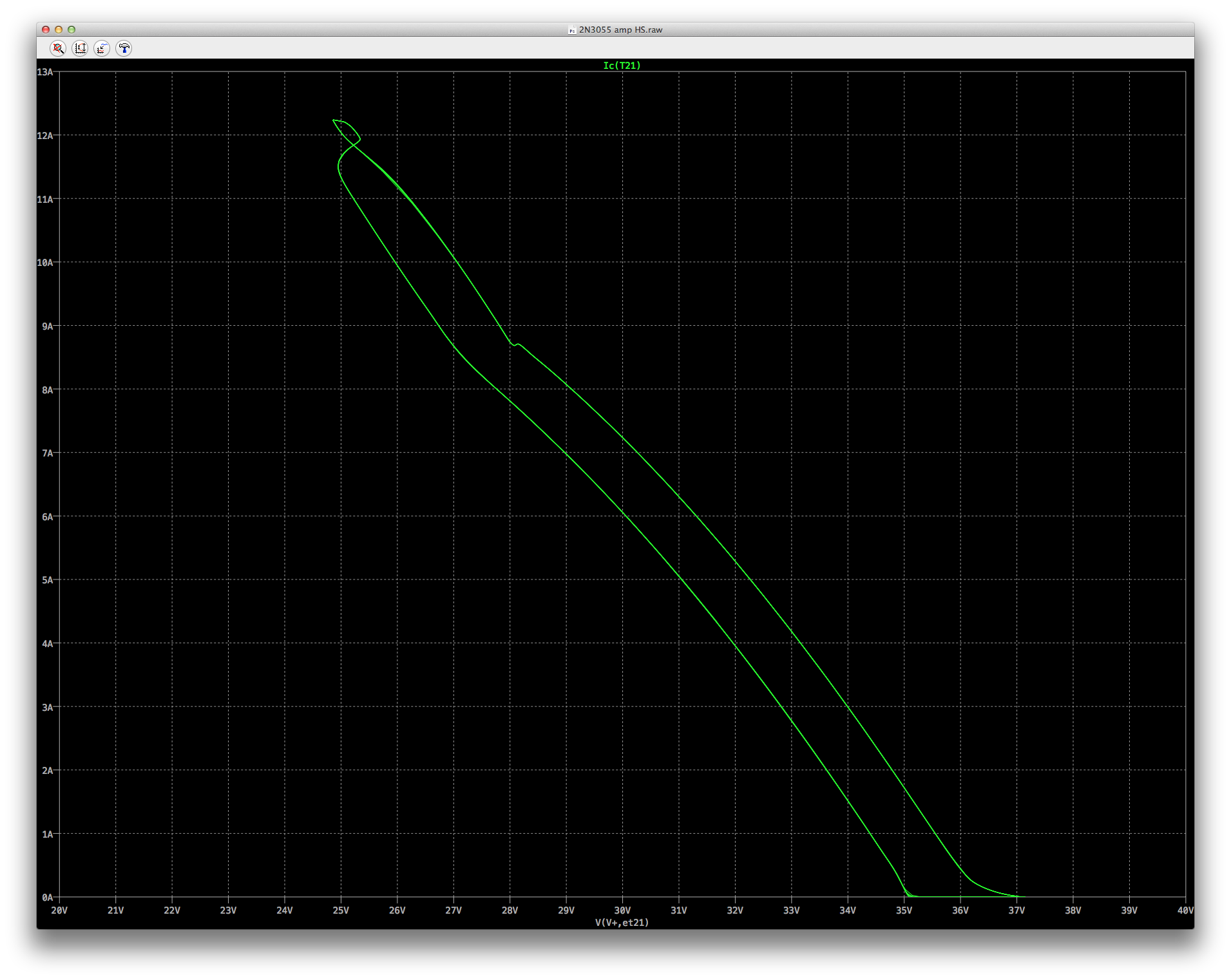

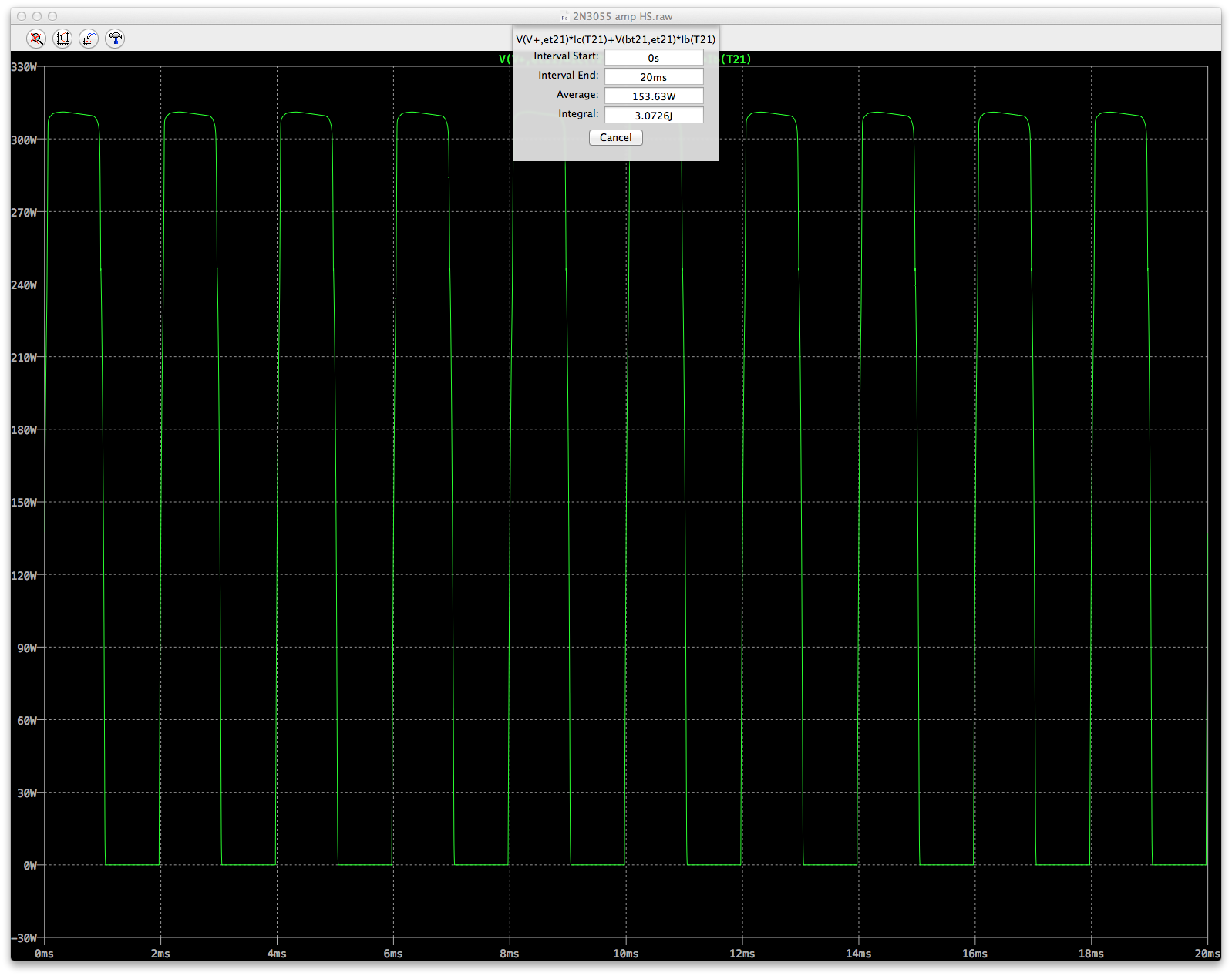

I plotted the soa on one of the transistors (attached) and took a power measurement on it (attached as well), which shows an average power dissipation above 150W and the peaks at more than twice that much.
There is action from the limiter but not enough. I believe this would not protect against a short and many parts would blow.
I measured almost 44A peak in the 50mohms resistor, so we have nearly 2.2V of drop on it, which definitely turns on the protection transistor.

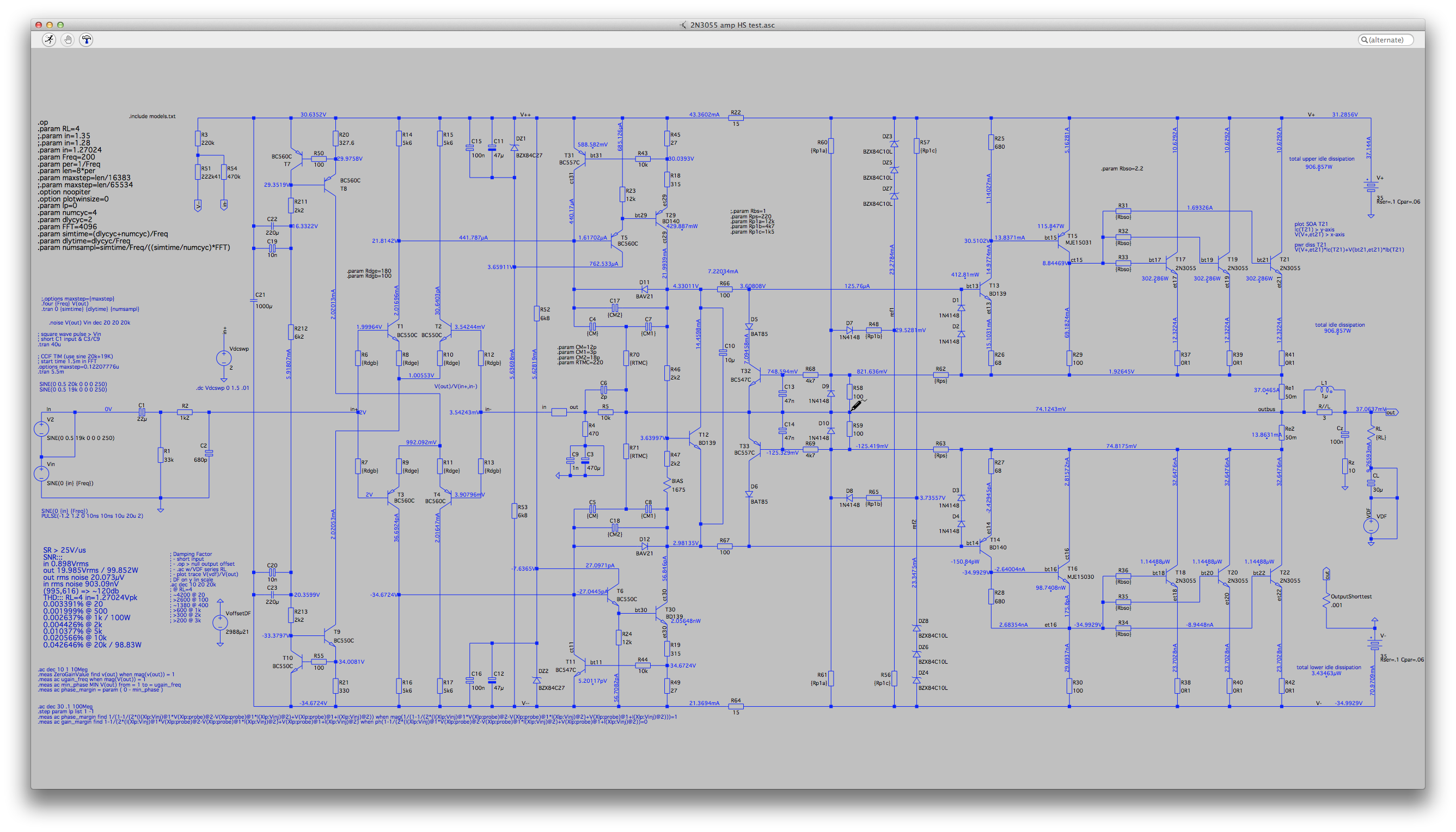

I can see the current in R26 going up to some 30mA, while the protection transistor acts, so T13 is still conducting much more than it should if a limiting action was effective.
I'm thinking that it could be because this quasi topology with the "stacked" emitter resistors presents that drop right below R26, and that this may be why T13 still conducts so much while the protection transistor has tried to short its base. I could be wrong about this, but in any case, whatever locus we calculate for, we're not going to get the exact effect wanted.
I haven't tried that stuff yet on the john ellis bridge, which likely won't react the same because of the complementary topo difference.
It's important obviously that the actual result matches the goal calculated, otherwise it's useless.
Is there something to change to make this behave as expected?

Have you tried Schottky diodes e.g. BAT85 for D5/D6? Or even short them out. This should turn off T13/T14 better under overload conditions.
I thought about testing with germanium diodes, but I haven't found models yet.
I'll look for models of those, and if I can find any, I'll try that. However if works better without diodes but not with the other types, I'm wondering what the solution will be, unless germanium types work any better, as we do need diodes there.
Wouldn't C10 10uF be better across T12 c/e? Not sure why but it doesn't seem right somehow.
That's where I had it before, but then I noticed how the THD was lower on that side, so I left it there. Any specific reason to put it back?
Turns out there was a BAT85 model in cordell's models, so I tried that and it hardly changes anything, there is a noticeable difference, but very tiny and in the end the power dissipated in the same transistor hasn't changed.
Shorting the diodes makes for a higher voltage drop on R26, but hardly changes the output and the dissipation is at least 1W higher in the same output transistor, so that's not going to do it.

What you've done so far ought to work on the face of it, just looking in the T32/T13 general region. However, I think we're forgetting there's huge DC feedback around the whole amp, so anything T32 does will be nulled out to a large extent by T29 trying to pump even more current into T13. Therefore, I think you have to limit the maximum current delivery capability of T29 (and T30 for -ve swings) so that T32 can do its work as intended. i.e. pretend T29 c/e is shorted on a +ve input and follow the current.
It really should, but there are "forces" at work that prevent getting the effect expected.
That is what the extra protection transistor T31 on the vas is there for. We don't want it to act on legit signals either, so the way it is set now with 12 ohms to sense on and an idle current close to 12mA in the vas, it has some 150mV of vbe at idle and should act roughly on 4 times the idle current.

I raised R45 from 12ohms to 27, so the vas current now limits lower to about 22mA. I replaced the bc546b by the bc547c for a little higher gain for t31, so it acts a little more strongly to limit current.
There is a little more than 7mA now flowing through r66 and the bulk of it is sunk by t32 as it should.
However this still leaves some 125uA going to t13's base, which is enough to drive t15 and the outputs to overload. So we end up with some 37A through Re1 and the dissipation in the driver and outputs is very high.
This isn't enough for a proper limiting action to stick with the locus intended action.

On the bridge, with 3 pairs, I see we don't have much headroom and setting the locus to hug the soa (DC) doesn't leave much room below for legit signals where the second breakdown is most critical. I've been plotting a 3ohms / 50 degrees load line, which does fit in the soa for 3 pairs and below the locus, but not by much, so if the impendance drops a little below 3ohms and reactance is over 50 degrees, then we have limiter action on legit signal on part of the signal.
125-ish-watt one pair class H finished. I had a proto working for that, too.
Is that one 3055 based? That would also be interesting.
I was even thinking about a leach double barreled with 3055s, how kool would that be?
- Amplifier based on 2N3055
