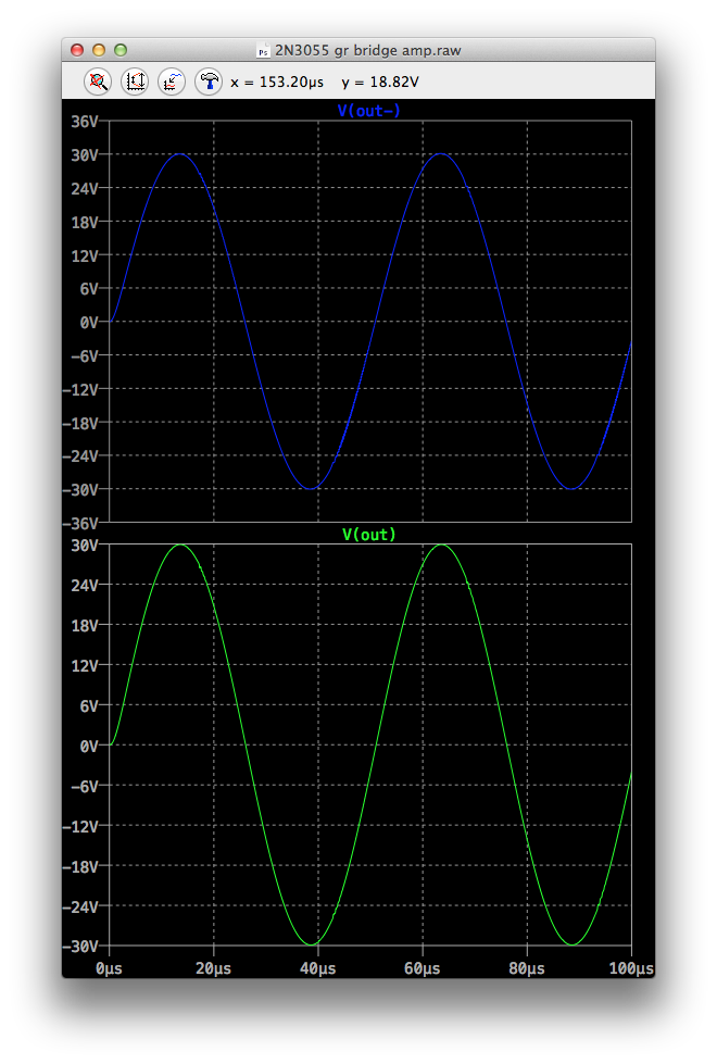

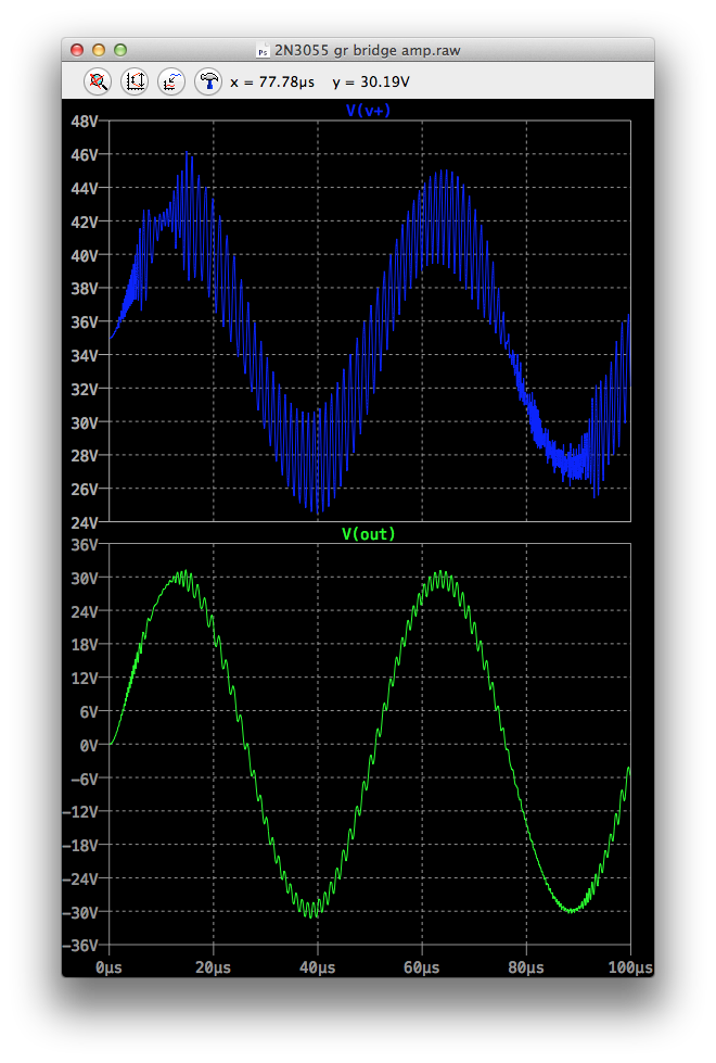

I was trying again to get the elektor based bridge to work, but this is just not happening.
If I power both sides normally with a dual supply but keep them uncoupled, with the low side input(s) taken straight from the high side, they are in phase and both working properly.
Once coupled and with the single supply, there are wild oscillations on the rails and that makes the high side oscillate too.
I tried changing the ratio on the coupling network that takes the feedback signal to match the feedback network on the high side, but that doesn't change anything, it won't work as a bridge.
I made sure I disabled completely the protection circuitry that was there before, so no interference can come from that.
Weirdly, when coupled, the output is at the same level as when not coupled, about 30V peak.
I'm not sure what the 3k56 role in the coupling network is, perhaps it requires adjustment. It seems to me the 33k /3k3 ratio, taking the high side's feedback signal, isn't working for this set up, which is why I figured I'd try matching that to the high side's feedback ratio.
The vi limiter that I'm working on (kiwanuka's fig 41) should be suitable for either the elektor or the "john ellis" version with the same values. I would like to test/simulate it on both bridges, but for now, when it's finally calculated, I'll only be able to test it on john's bridge.
Can someone think of how this bridge can be made to work right? There is no point in making a prototype if it doesn't even work in simulations.

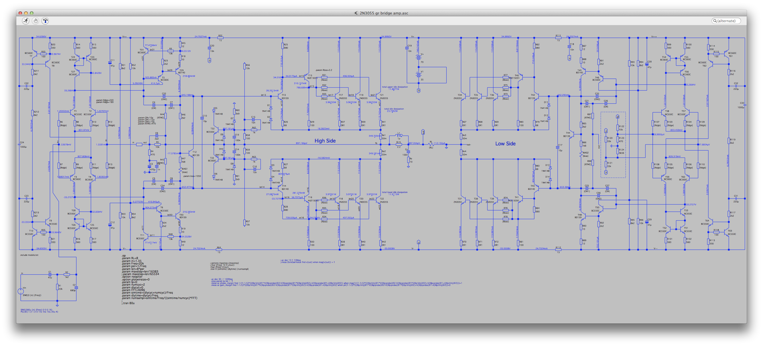

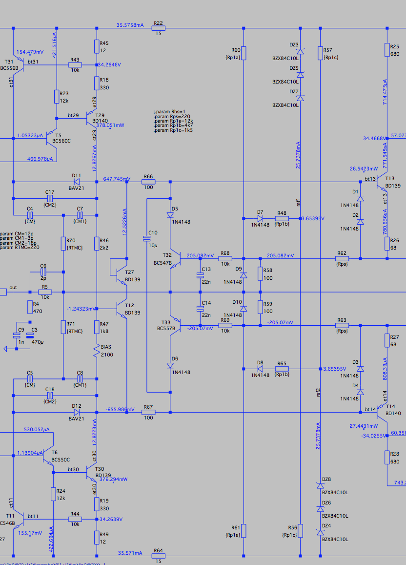

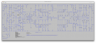

Here is The limiter installed into john's bridge. I picked arbitrary zeners, because I don't know yet what voltage they need to be. I put values to try out, but until properly calculated, I can't be sure it'll work right.
I haven't yet been able to plot the soa, load line and protection locus, so I can't even try to calculate anything. I've been trying to plot things in mathcad, but couldn't do it any better than with excel. I've never done any graphs with excel, so I need help figuring that out.

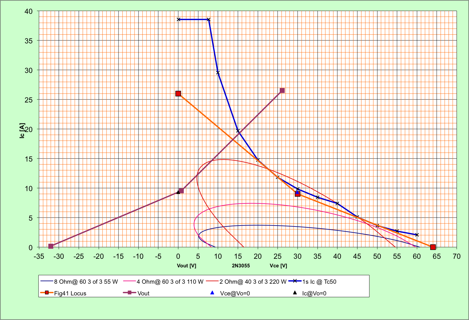

I'm still wrestling with excel's chart feature and it's really not as easy as it should be. Not intuitive and looking for tutorial or explanations that pertain exactly to what I need has not been fruitful. The tutorials that I found don't show what I need and couldn't find the answers to my questions.
Anyway, after a lot of poking around and trying things, I managed to go around the error from a missing macro and use pingrs's chart to make a new one simplified for clarity (attached).

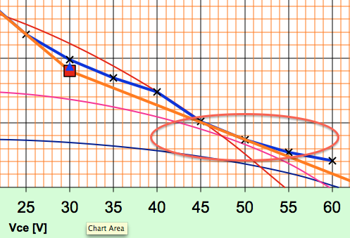

Having read in M. Kiwanuka's paper that the Ic=0 point on the locus, which intercepts the Vce axis, should be above 2Vcc to prevent premature limiting. This puts that point well above the 60V Vce0 of the 3055, but we've been planning for rails at 35V anyway, which obviates screening the 3055s for higher second breakdown.
I tried placing that point at 74V, and it brings up the locus well into the "scary" area of second breakdown. So that brings the question, of how much that area would move up when choosing the higher breakdown parts.
I brought it back down to 64V on that plot attached, so it's just grazing the limit, however that may not be the way to go because of the mentioned premature limiting.
Having the soa, the load lines and the locus on the same chart also shows that the high current area of the soa is never even used, while the knee point in the locus is in a "tight" spot, which not only is close to the soa limit, but more importantly is rather close to the load line for 4 ohms as well.
We must disregard the load line for 8homs, as that will never be the case, being bridged and each side always seeing 4ohms. The 4ohms load line, although plotted for 60 degrees reactive, is well within the soa and protection locus, however that doesn't account for the lower speaker impedance encountered in reality, as it could drop to some 2 ohms, possibly lower at certain frequencies.
It doesn't take much to see that the 2 ohms load line that is plotted, at 40 degrees only, is going out not only of the soa, but also above the protection locus, so that would mean a "normal" 4ohms load, if it is reactive enough, when its impedance drops at its lowest, will surely trigger the limiter, no matter how high we place that "point A" (where it's not used).
This also obviously means that if the bridge is loaded at 2ohms, it would certainly trigger the protection well before reaching full power.
Logically, if the limiter does limit the dissipation as it's supposed to, and sticks to the locus as we calculate, the amp should survive any abuse, either from a short or overload by over-driving or over-loading.
I made a closer snapshot of the area on the plot where I have concerns (area circled), where the locus is so close above the 4ohms @ 60 load line and also grazing the soa (blue curve).
I think its' quite possible that due to this tight arrangement, when the 4ohms load actually drops some, if it is reactive enough, there could be limiter action, which would be in the "normal" use of the amp.
I tried the 4ohms @ 45 load line, which drops quite a bit and leaves more headroom, but since it won't always be 4ohms and above, it will be a matter of how reactive the load is if the protection triggers or not. This would be at full power anyway, so of course at lower power it should be fine.

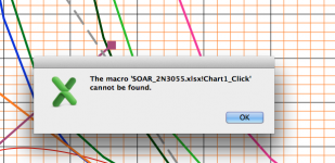

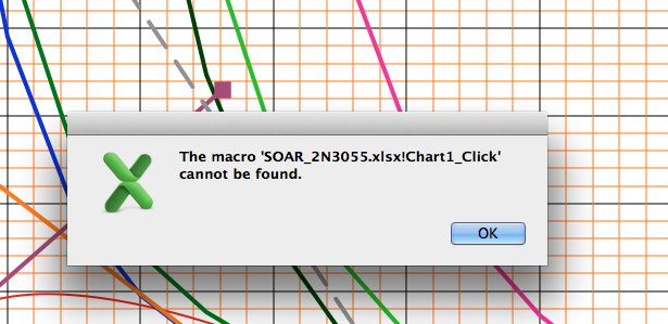

What macro do you mean? There is no missing macro,as far as I am aware. All the data you need is there.
Attaching a snapshot of the error popup.

I see your error message, thanks, but it doesn't appear in the original on my P.C.,nor does it happen on another P.C. I copied it to. Has it anything to do with using a Mac? Also, if you can't edit any component values, there is something seriously amiss. I haven't locked any of the macro.
Anyway, I'll attach the original, maybe others can elucidate.
I don't think it would be a mac related issue. I would lean more in the direction of something that you have, external to the sheet and that gets called without you knowing it because it's there and I don't have it on my end. If you pass that same file along to other machines without any other related file and it works there, then perhaps it's something that's present among those machines but not on mine. Then if that is actually the case, then it may be that there are some resources present in office on windows but not on the mac.
Would be good to find out.
The thing is, the component values are in yellow bg cells and they're values and not formulas, so I can change them, but they're not calculated automatically.
Something isn't right there maybe.

This latest sheet is giving me the same missing macro error, so then it may be that something present on the windows based office may not be present with the mac version.

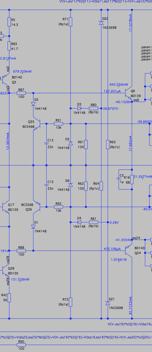

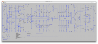

I put that fig 41 limiter in place in the simulation, although not all the values are calculated yet, at least the zeners and their biasing should be ok, unless the 30V needs to change, but it seems unlikely.
There is one thing that I've been wondering though. About the bias spreader, which should be thermally coupled with the pre-drivers only. Having tried a few implementations and with the issue of the lowish (~400mV) Vbe of the BD139/40, there are arrangements to avoid, as they don't "pinch" the spread enough to lower the bias in a suitable range. I tried keeping 2 transistors in the spreader in view of coupling them by pairs with the pre-drivers, but this may not even be needed.
Here's my idea: Why not making the bias spreader with a single BD139 and couple it with both pre-drivers, with the bias spreader transistor in sandwich between the 2 pre-drivers? one single screw could hold all 3 parts together, and we can put the plastic sides of the pre-drivers on the inside, touching the spreader, so no isolation would be needed, and a little thermal paste would be a good thing...
Does this sound ok?
