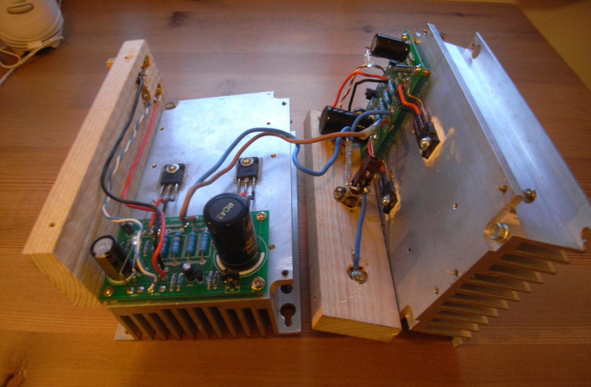

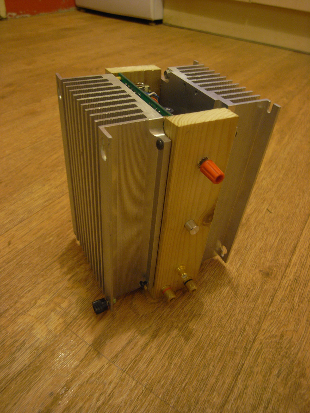

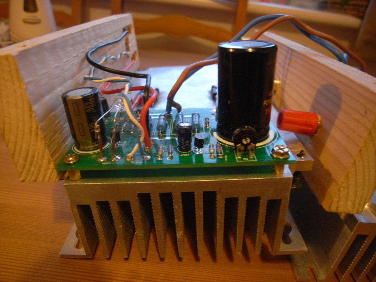

Here Is my almost completed amp camp amp :)
I used some old heatsinks I had, Ive tried it from a 19v laptop charger, sounds good.
Now trying it from a car battery stepped up to 24v using another car amps power supply. sounds good but something missing.
Next im going to try 12v from the battery direct, but I doubt ill get enough Bias.
Interesting though and does sound good :)
Cheers
Riki
