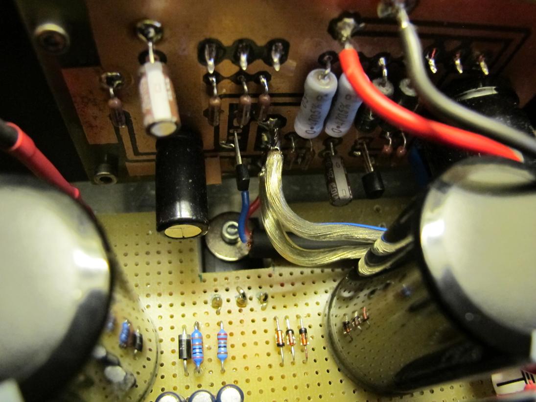

what with Zen Art.3 regulated psu.
I`ve done it this way.
22000µF - regulator - 22000µF for me that worked fine
not the cheapest but regulated:D

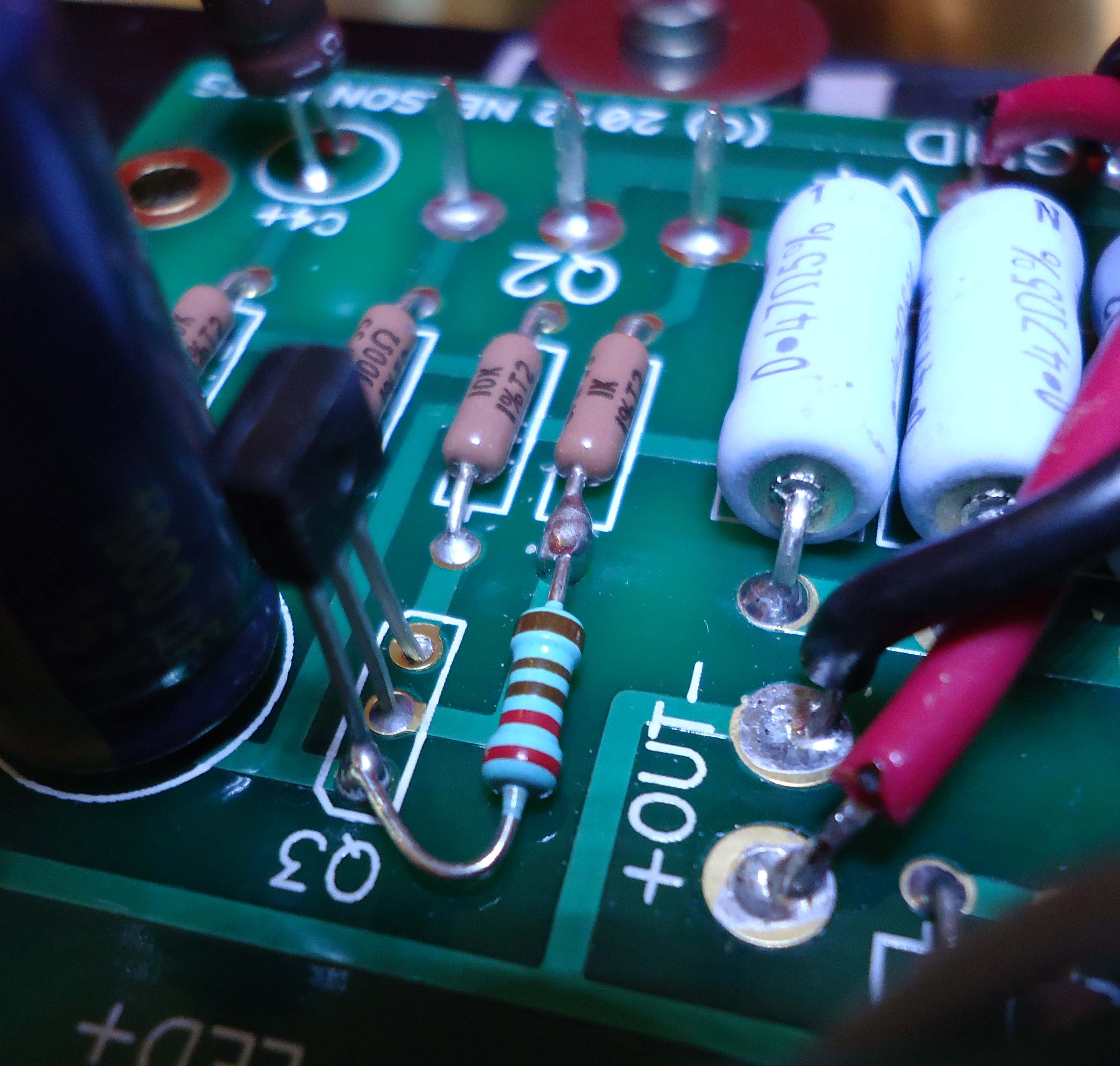

val
It looks like all the transistors are functioning correctly. The problem must be that one or more of R1, R2, R3, R4 are not the correct value, or current is flowing through C1 to the speaker.
The voltage from the Drain of Q1 to the plus side of C1 should be 0.366V and 0.253V from the plus side of C1 to the Source of Q2. A low voltage on one side points to which side has too low a resistance. If the sum of the voltages is not 0.62V, some current is flowing in C1 or somewhere else.
With no signal, the DC voltage at the speaker (-Out on the schematic) should be very close to zero volts. Verify that the polarity of the capacitor is correct. I made a mistake on one of my builds. I connected the +Out to +19V instead of ground. :eek:
Note that it's a good idea to mount transistors low on the heatsink for best cooling efficiency. The top of a heat sink is usually several degrees warmer. I suggest about 1/3 the length from the bottom.
