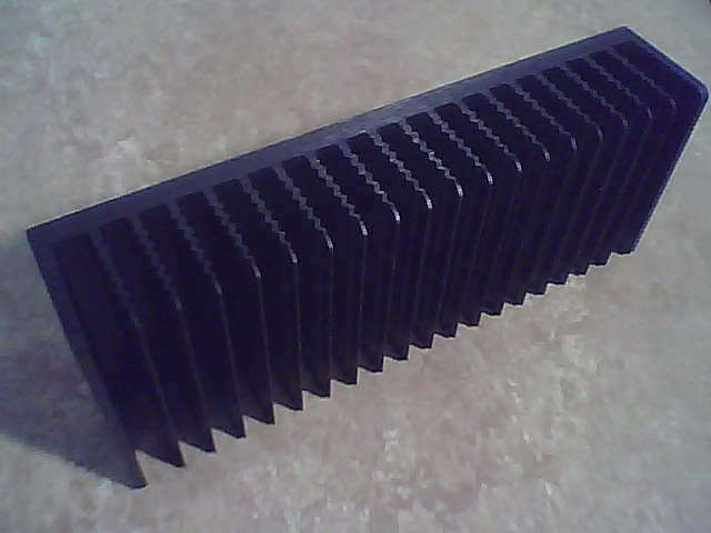

Agree. The ACA kit heatsink is only slightly larger at 40x80x200mm (pic). Both heatsinks have 20 fins. Yours might run a degree or so warmer.

I'm new to amp builing and have just took delivery of my ACA kit. owing to a p&p cost of $90 i decided just to buy the components/connectors and supply my own chassis and heatsinks. I think I will be going for one of the chassis from ebay previously mentioned.
Anyway... my question is to do with the thermal paste and the.mica pads. I've done some searching and found some goo at maplins for a good price however are there any specs I should be looking for; thermal conductivity values for example? The same question goes for mica pads except I'm still looking for somewhere to buy them in the UK. (mica pads just look acetate sheets to me)
