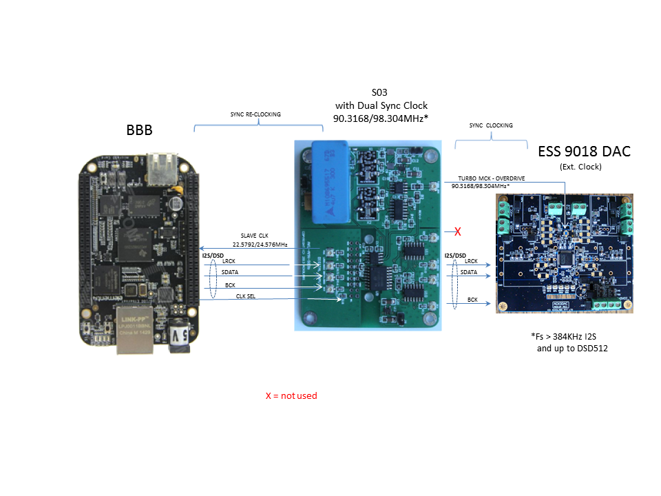

BBB- ESS DAC in Overdrive Mode
Full Sync capability, I2S and DSD
From previous posts, 45.xx/49.xxMHz clocks are enough for perfect synchronous re-clocking up to 384KHz Fs and this applies to ESS DACs also.
So why have some designs used 98.xxx/90.xxMhz clocks even though the re-clocking outcome remains unchanged?:
1. ESS DAC also connected to spdif direct. This is ASync operation and requires ~80Mhz clocks to handle up to 192KHz Fs. So 98.xxx/90.xxx handles this nicely. (only one clock needed)
2. Higher Fs beyond 384KHz?
3. The jitter reduction mechanism in ESS DACs works better at higher clock frequencies, obviously computations can be completed faster.
Assuming we ignore #1 and #2 or spdif not needed then we are left with just the prospect of better performance with this overdrive mode.
But there are issues to consider:
1. phase noise performance for typical 98.x/90.xx oscillators are generally not as good as the 45.xx/49.xx types from most crystal manufacturers. So whilst jitter reduction in the DAC yields higher apparent resolution this can be negated by the phase noise of the clocks- some reports have already indicated this effect, like sounding a bit bright, "musical", etc.
2. board, components and power supplies are stressed more at higher frequencies, plus EMI
May have to consider more expensive OCXO types and premium grade board material/parts if this type of operation is desired.

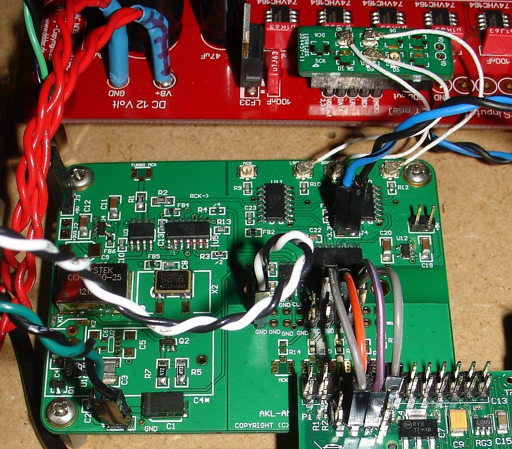

I'm using the raspberry pi and multi-purposing the S03 (which BTW, is a very flexible design, thanks Acko) with Doede's dac.....
Acko's support, as always, is outstanding... ;)
Hi Palmito,
In reference to your photo as per attached, I see the little PBC board used as input into DDDAC's I2S. Would you please direct me to where to source one? Anyone? :confused:

That PCB(BIII adaptor) is from Ian's FIFO GB. I have one and used it on my DAC project as well. Many ppl don't release how useful it is. Its so useful I think I gonna buy a few when the next GB is on.
2nd picture
http://www.diyaudio.com/forums/grou...-pdif-fifo-kit-group-buy-136.html#post3662746
