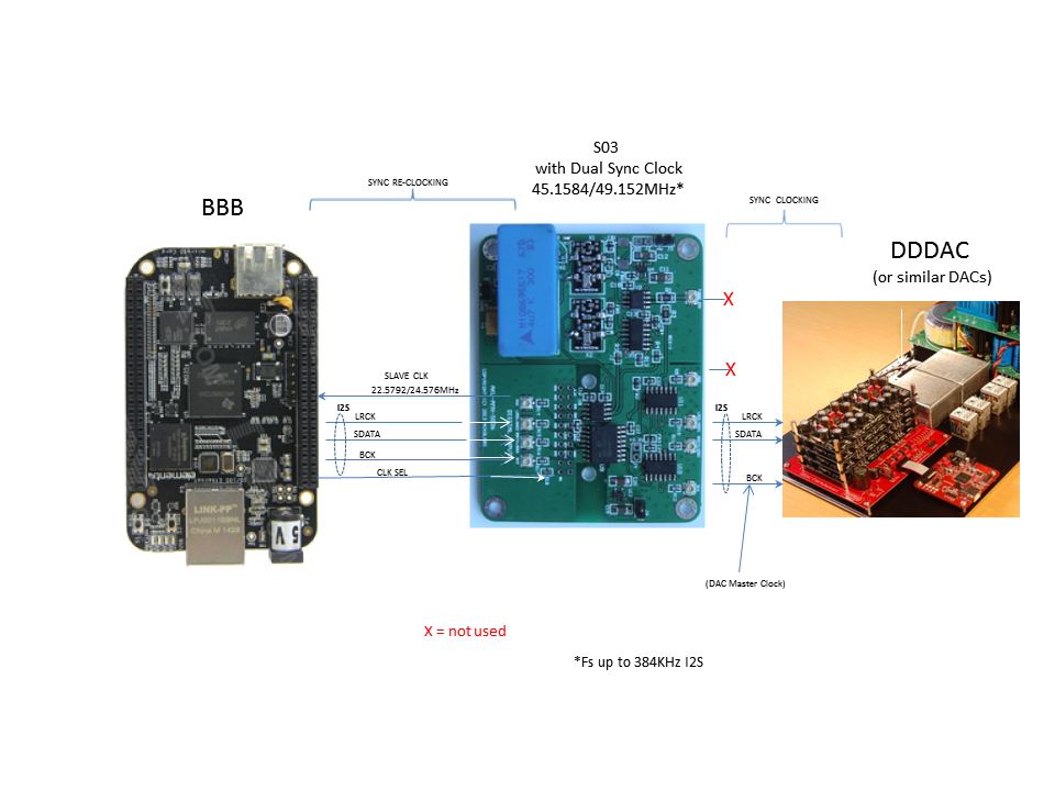

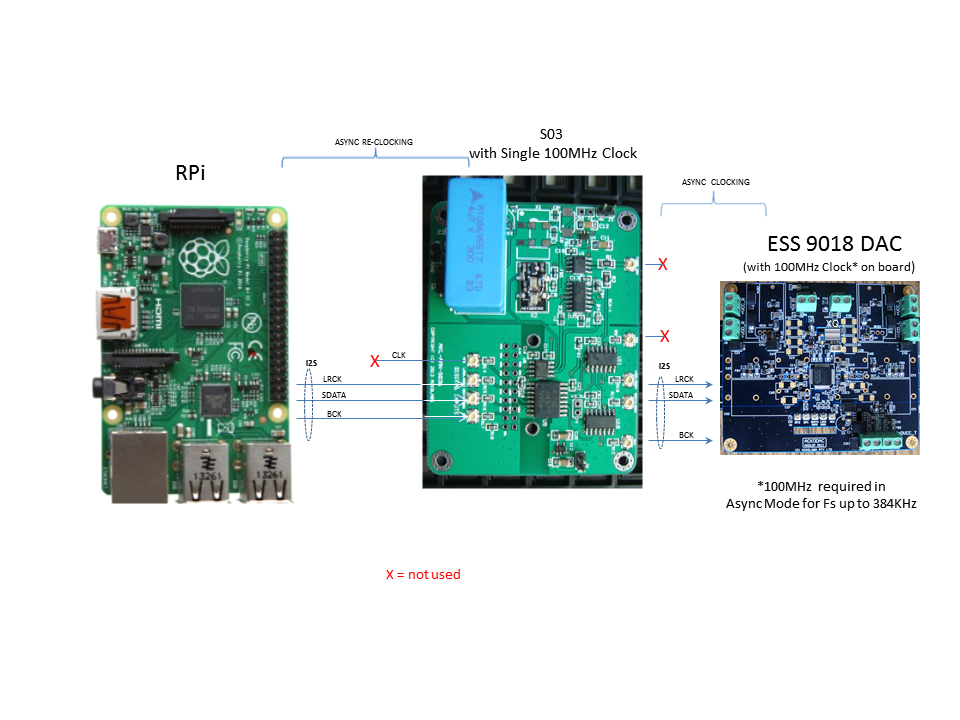

I am assuming this arrangement is with the RPi that does not take external clock. So after isolation ASync re-clocking is the only option and as I have indicated this will introduce 'pulse modulation" errors. But this get reduced at higher re-clocking frequencies. I believe Palmito has already experimented with 50MHz clocks and 100MHz clocks and reported improvement in SQ at 100Mhz - so this proves the point. Theoretically further improvement with even higher clock frequencies so long as phase noise is comparably low - otherwise it will negate the benefits above
Yes, BCK signals become the MCK for DDDAC or simlar DACs but BCK is referenced to the main clock used on the S03 so its jitter performance is obviously dependent on this Clock. So again you will need to pay attention to the phase noise of the clocks used. Re: results from Palmito, changing Si590 to CCHD950-100MHz improved the sound because CCHD950 has lower phase noise than Si590. The 98.304MHz to 100MHz is not too much (I think) for this contribution

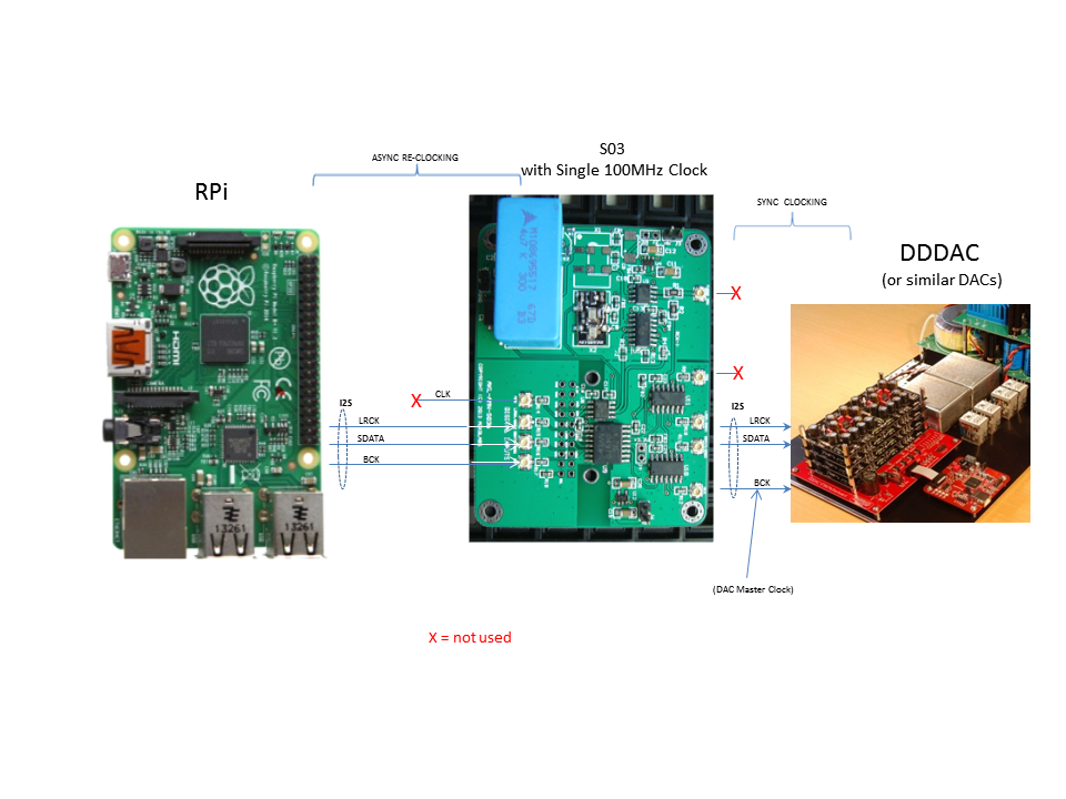

Async w.r.t to RPi but Full Sync drive of DDDAC
