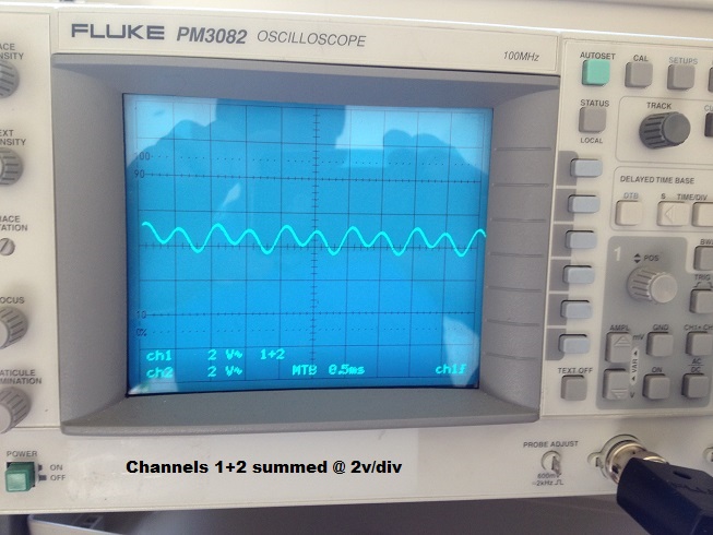

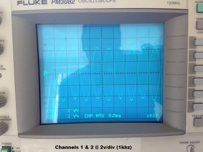

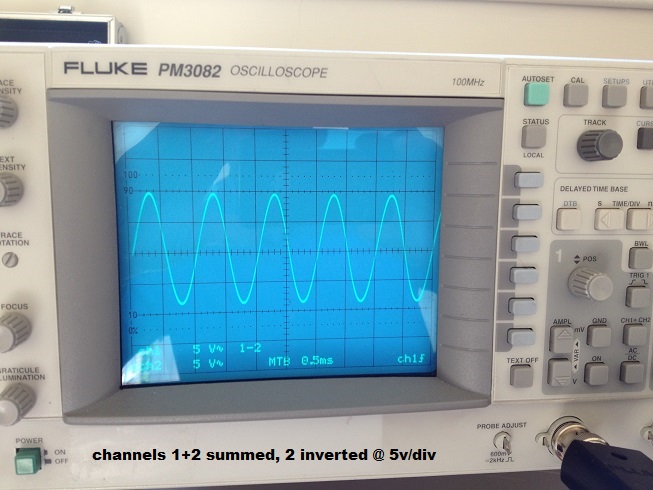

Sorry - it's not possible to show the dial settings, everything is digital and on screen. Pictures aren't great, but you get the idea...

Yes, Pic 2 is channel 1 + channel 2, you can see "1+2" on the screen (and that is indeed my "M" wave), pic 3 is with channel 2 inverted, i.e. channel 1 - channel 2, you can see "1-2" on the screen.
I don't know if my output is OK or not and don't understand why I have to invert channel 2 to get a decent looking output waveform.
Jason, Your 1st scope shot shows you what you need in order to understand. The first scope shot shows that when the output of channel1 is +5V, the op of channel 2 is -5V. This is as it should be.
If you sum +5V and -5V you get zero (well not quite due to imperfections in the amp so the voltages are not precisely equal). This is what your Pic 2 is showing.
If you invert one of the channels to do the scope math you get 10V. Again what it should be.
Many thanks for your explanation - seems that everything is in order and I was just being thick! (sorry).
The second picture with the summed outputs that should be zero are 1v pk-pk, that's quite a significant amount of voltage difference error. Is that something that can (or should be) improved (better matching of the two halves of the amplifier) or not to worry about it?

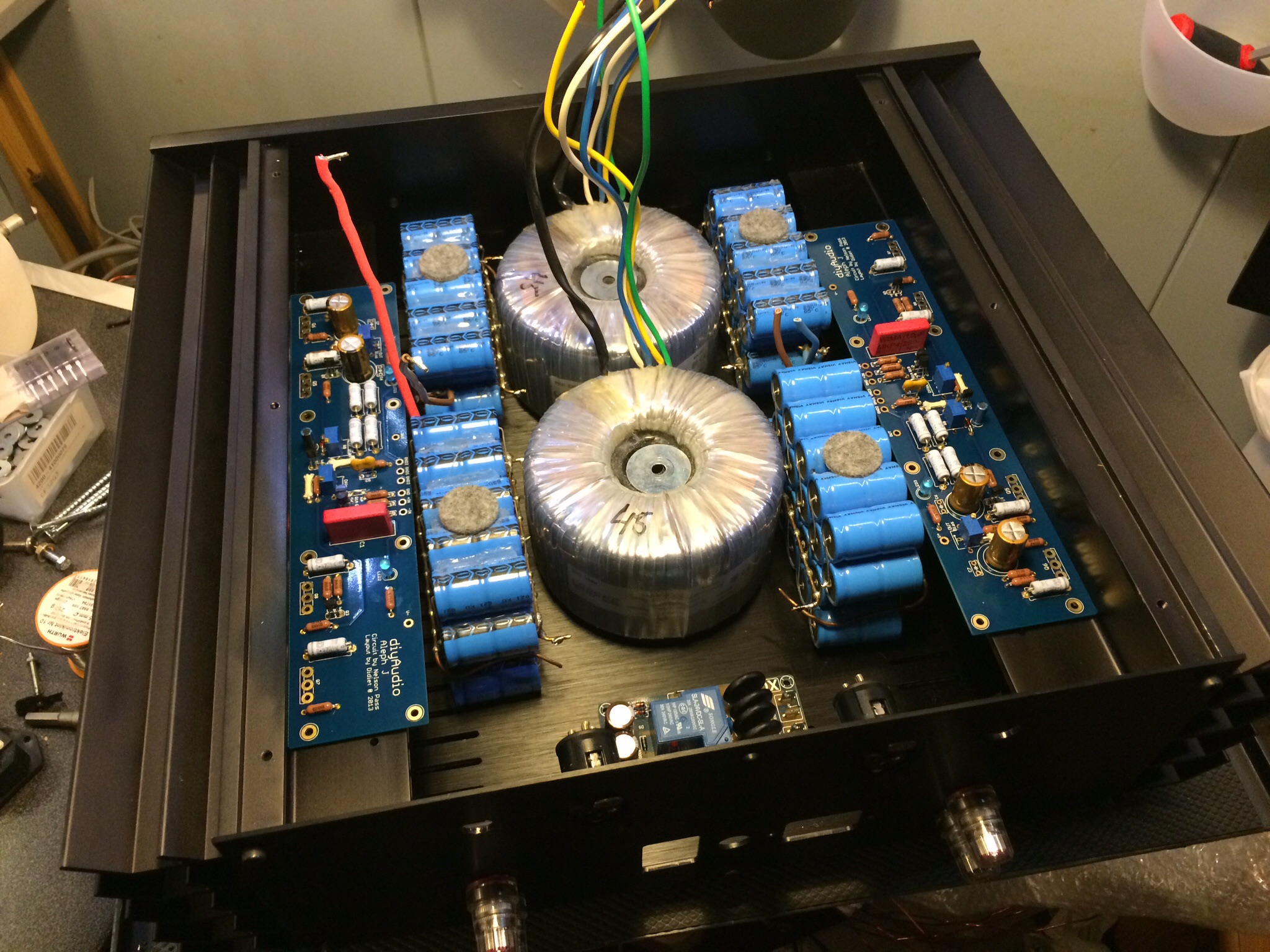

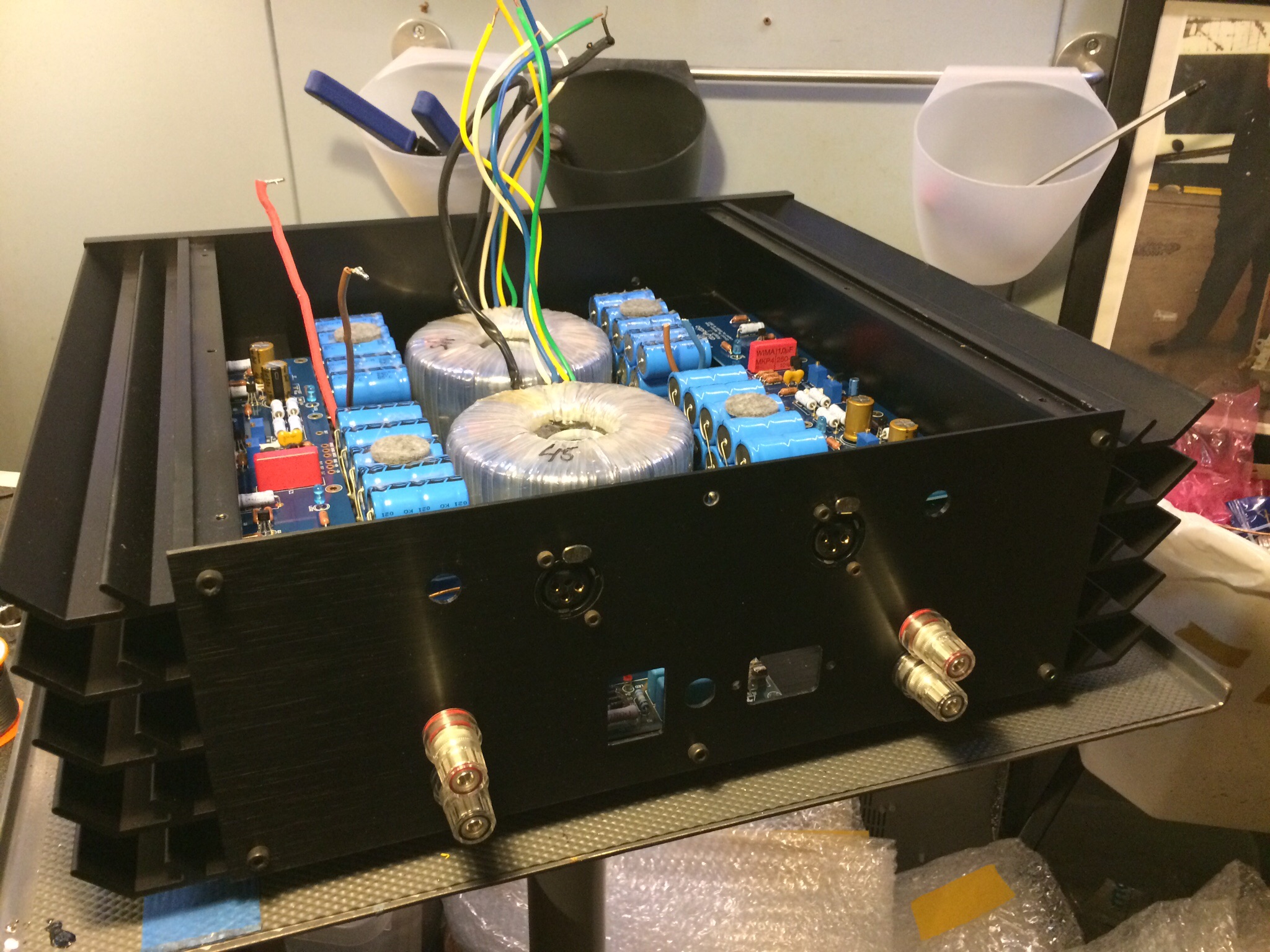

Very nice Leikis! I'm thinking of fixing the trannies like you did here. How many watts can your amp deliver to the loudspeaker? Your heatsink looks small.
Thanks.
The toroids is 18v, so i suppose its around 25w ?
The heatsinks have big finns so lets hope its enough :)
88000uF for eatch channel, and one 400VA for eatch channel.
