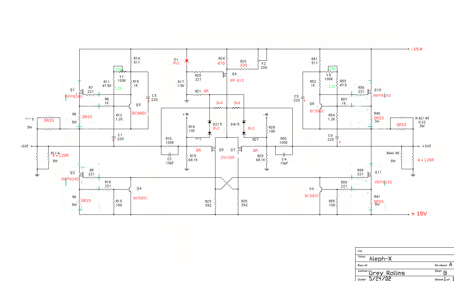

Noise?
I built one in reverse mode (2SK389 as input, BC560 and IRFP9240 [single], +-15 V). One channel is working, but on the other I have problems:
I get sound, trying with speaker between OUT and ground, one half sounds fine, but on the other there is white noise, weak sound and the offset is different from the other half. On this half the offset starts with +7V and only after 3-5 seconds suddenly goes down to about zero. Any guess about a reason? I exchanged all power FETs and PNPs, can't find a difference to other half/channel ...
Zeners? Capacitors?
Zeners? Capacitors?
This is the schematic. Red my changes. Green is "power saving mode" which I adjust to 0.9 V across R6 and R41.
In this mode the "good" half starts at 0.5 V output vs. ground and "switches" to -0.5 V after about 5 seconds, "bad" half starts at 2.1 V and goes down to -0.9 V. "Good" half sounds ok vs. ground, "bad" half has noise and bad sound.
Voltages with both inputs at ground.
I have the same problems in high power mode so I wanted to test like this, I don't have to mount/unmount from heat sink every time.
Also I have big hum at the output if I don't connect the input's ground, which I don't have on the other channel
-- OK! I have a big difference in input resistance to ground 40k vs 18k

My first thought after reading your description of the sonic differences between the channels is that you have a ground loop. I noticed that you removed R21. That resistor is typically used to damp ground currents between the channels. This can in turn lead to oscillations, usually stronger in one channel IME.

Glad you sorted it out. Jfets have the same input capacitance/trace inductance potential problems as mosfets. The DIYAudio store AJ boards have provisions for gate stoppers, but most leave them out. If you are oscillating, you can add gate stoppers.
