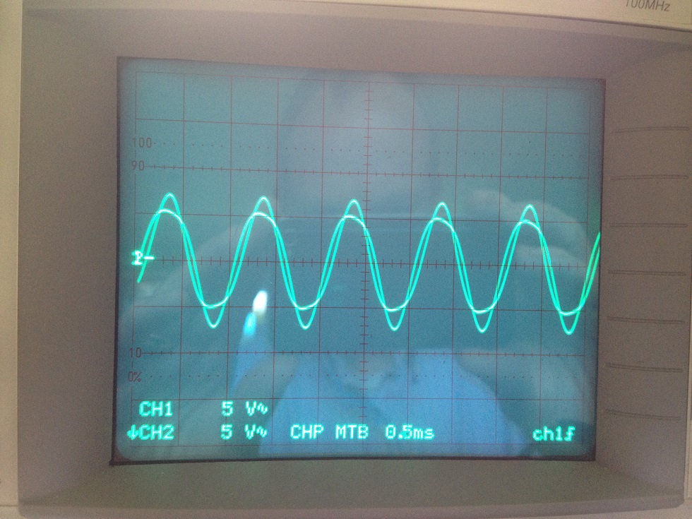

Hi William,
"Another suggestion was to raise the value of the "Macmillan" resistors (mine were 4.7K so I increased them to 10k) - that has made no difference to the relative amplitudes (but has affected the output waveform, was a sinewave, now a sinewave with a dip at the top (looks like an M) instead of peaking properly"
The two output waveforms look correct (different amplitutde but both clean sine waves), it's only the sum of the outputs that looks like an M. Was Ok before increasing the Macmillan resistors to 10k.
I worked late last night and couldn't get to my test bench, but i'll have a go at resetting the trimmers to see if that helps.

I have swapped a couple of the output FETs over and re-adjusted the trimmers. The output waveform is back to being a sine again but the non-symmetrical amplitude still prevails (and the relative offset has increased from 80 to 230mv.
I measured the gate voltages - the lower FETs have just over 12v on them, the current sources have about 5v on them.
I'll go back and try matching the output FETs again.

OK - I have had the soldering iron and scope out and started playing again.
I added a 200 ohm trimmer in series with R25 and adjusted until I had matching amplitude on the two halves of the circuit. Adjusting the trimmer either matches the amplitude or trims the relative offset to zero but not both. Can anyone offer any advice on how to get this better for both?
I replaced R24 with a pair of KTY81/110 in parallel mounted to the Q1 heatsink with superglue - the pair didn't do the trick but adding a third pretty much did. I might try adding a 2k trimmer to the third PTC to see if I can get it any better (it seems to drift +/- 100mv).
I realised that I do still have the M in the sine wave (from the sum of the outputs), however if I invert the second channel on the scope everything comes back to how it should be - Can changing the Macmillans cause phase shift?

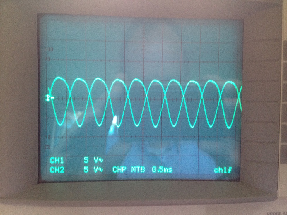

Taming the beast
OK Soldering iron out again and more tweaking.
I have 10K trimmers over R23 and R25 - I can trim out most of the relative DC offset (20mv remaining) but still have issues with differences in the amplitude (and shape) of the waveforms on the outputs, also the two output waveforms don't cross over at the middle - I expected that they would (and should). I can adjust these factors a little by adjusting the 10K's over the top of R23/R25 but what you see on the scope traces is the best I have achieved so far.
If I invert channel 2 then the output looks like a clean sine wave, without the inversion it looks like a lower amplitude "M" - I can't recall when that came about - might have been when I increased the value of the McMillan resistors - I might have to go to back to a lower value (currently 20K).

and don´t worry about absolute DC offset, your speakers won´t see it!
As I see you are measuring near clipping level? Try something near 1 or 2V to start with.
And have a look at the current limiters on the negative halves, it could be that they are already working (Q4, Q9 and resistors 10,13,35,39. Maybe you have to change those to change the limit.

Does your scope have a Vert Diff position? A-B? Ch1-Ch2? Connecting scope probe Gnd to your Gnd will be fine. Your measurement will be between two Channels of the scope. 1 Channel will be inverted in typical operation.
I always have the Gnd lifted on my scope AC input but that is not something I'd recommend.
Hi flg,
I have dual channels and channels 1 & 2 are both grounded to the central grounding point with one scope probe on each output. I expect one output to be swinging negative whilst the other swings positive, the sum ( ie channels 1 & 2 combined) should be a nice healthy sine wave but instead I see a wobbly m wave as the output. If I invert one of the channels then the resulting waveform is the large bridged sine wave output that I expected in the first place. I just don't understand why I need to invert one scope channel in order to see it how it should be.
