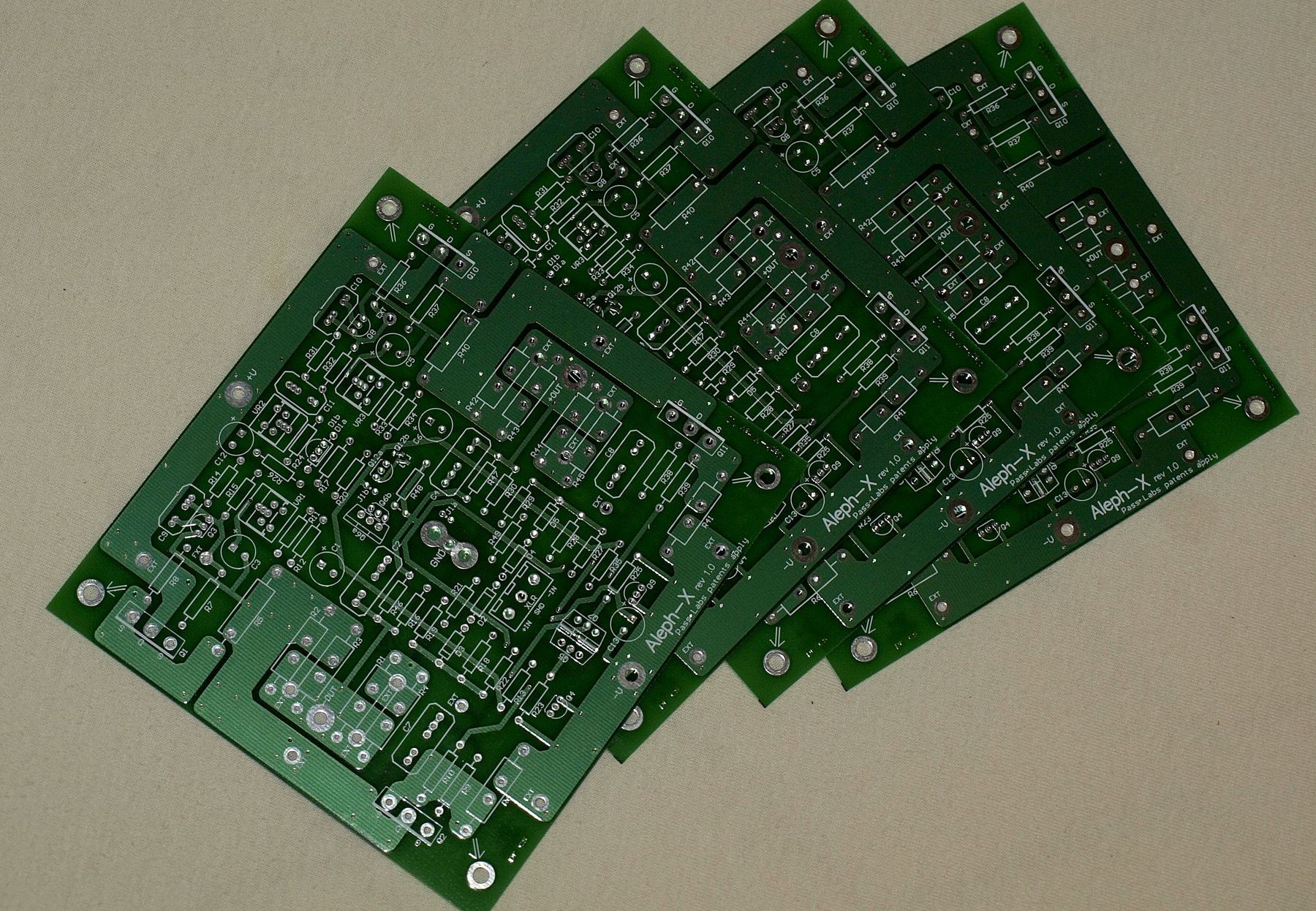

Hello,
I offer the PCB Aleph-X for sale.
I need to have for the four Boards 36€ +shipping cost.
look at picture
Bye Alex
Hello. Did you still have the PCB for sale ? I will be interest. Shipping is to France.
Please let me know or contact me in my e-mail.
Regards, Victor

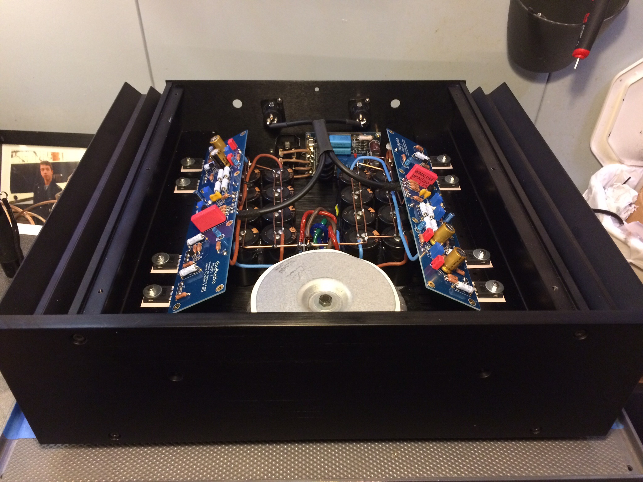

Hi Leikis,
That's a pretty cool case. Looks very much like a first watt one.
I like this chassis very good, absoluteley worth the money.
You can find it on Ebay !
Hello Leikis,
Can you tell us how hot are the heatsinks in you amp (if you have a temperature measurement device)? If not, could you still put your hand on the heatsink for like 5-10 seconds? Thanks!
Because of the small hetasink i have to lover the bias to around 320mV, then i reach 54-55c i a room with 25-26c. The transistors is around 60-62c.

Finaly done, just some fine adjustments left.
But cant realy find ut what the LTP Bias pot does ? Any sugsetion what to do ?
400VA 2x18v toroid. 80000uF for each channel using Elna 10000uF 80v.
I suppose this sets the absolute DC at the outputs. VR2 in the original Hifizen schematic.
William
