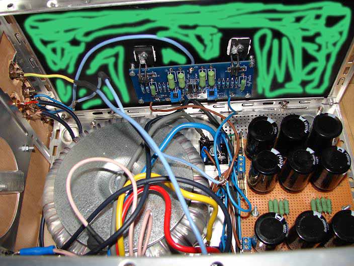

The idea is to get as much heat from the Fets out of the box through the heatsinks. We do not want the heatsinks radiating into the box.
Would it be a good idea to insulate the heatsinks. I could imagine applying some kind of material to the surface of the heatsink that is inside the box to stop it radiating into the box (see attached foto; this is not an Aleph J but a photo I pulled of the web and photoshopped to illustrate the point I want to make).
Anyone ever seen this done (DIY or commercial)? Does it work?

this is a modushop 4U 400mm? it will handle the power. do not insulate the heatsinks. its better that the heat comes out in the chassis, then beeing trapped in the baseplate of the sinks. those chassis are well vented. a buddy of mine are running JLH 40W classA froom the same chassis. and it only get a little warm. far from hot.

No, would only have some meaning if the rest of the case was not made of metal.
If keeping the heatsink heat out of the amp is of importance, more logical would be to design the power amp with exterior heatsinks, e.g. '80s Krell KSA/KMA with the star-shape heatsinks.
What you do see are amp boards of close to same size, mounted to the heatsink with stand-offs.
Thus creating a vented tunnel, with openings in the bottom and top of the case.
The boards serve both as an insulation shield for the rest of the amp interior, and help to channel the air flow.
(there's an occasional Class A power amp model with an extra wall mounted on the inside to separate the output stage from the supporting hardware)

i've seen some atempts on that. the smartest was a bottom plate bended up and went all the way up. then you have the airflow from the bottom and out the top.
but i don't know if the gain is nothing to whrite home about. moder nature takes care of the vents with the air pressure hot air climbs. negative pressure accurs. and cold air will be sucked inn to get the pressure at atmosferic
