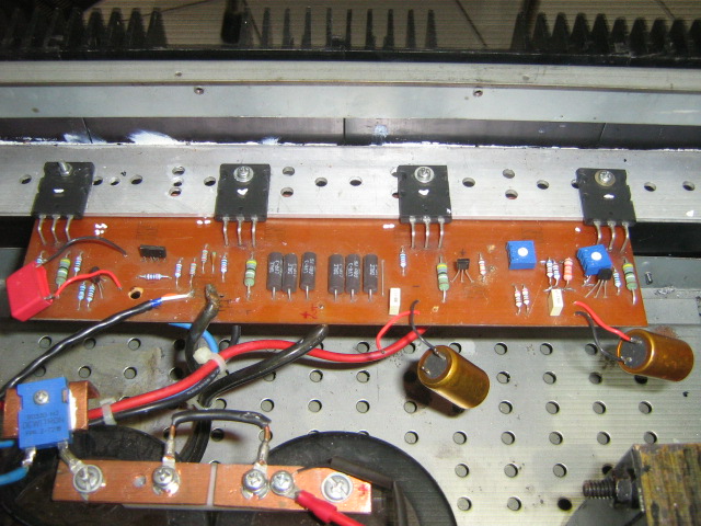

schultzsch, I did tried decoupling R24 (C3 in my case), difference in mids, ZM is right some like it, some not. I think with R24 in place things are more transparent, decoupled bit muddy there but sweet thanks for your tips, here is my humble AJ-2SK1530's , C3 decoupled

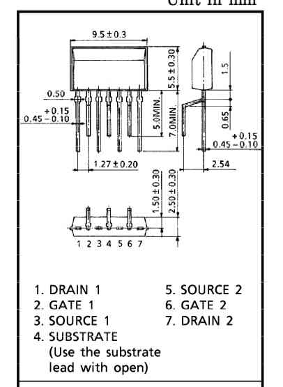

The substrate is separate on the dual FETs. You have to figure out how to handle the substrate pin. (The data sheet is *not* the best resource here.)
Hi Charles,
what do you think ist the best connection when using these parts in a LTP? Connecting the substate together with the sources?
Charles Hansen 7th July 2005 03:29 AM
You will have to measure the connection from the substrate pin to the other pins with the "diode" mode of a multi-meter. A parasitic diode exists between some connections, which should not be forward biased. Once you have determined which connnections are allowable, you will need to do some listening tests (like everything else in audio!) to see what connection sounds best.
http://www.diyaudio.com/forums/solid-state/59543-need-help-j-fet-problem-print.html
Hi Charles,

Pin 4 is there for a reason.
Do a search for what Mr Charles Hansen posted about the substrate connection.

thanks guys! I had no idea, so I guess 2 x j74 doesnt make a j109 afterall
