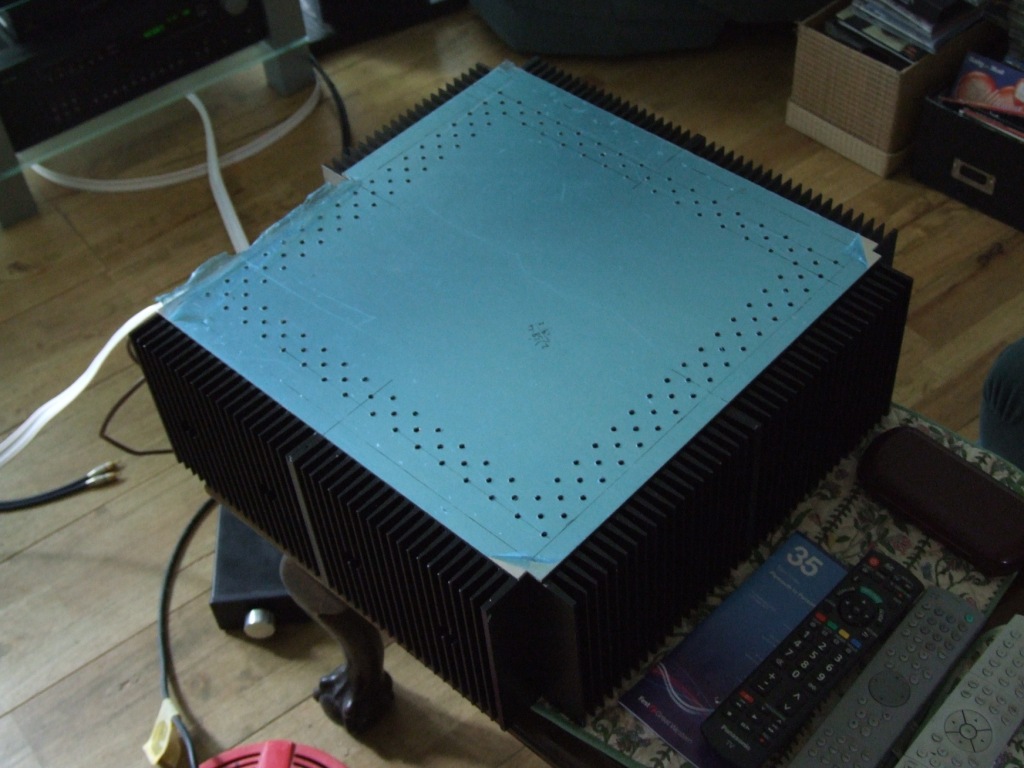

Help with thermodynamics
Thermodynamics isn't one of my specialisations.
Can someone please look at the two photos.
The top of the case has a matix of 4.5mm holes drilled above the MOS-FETs to let the heat escape.
At the moment I have 3mm holes drilled in the bottom of the case to let cool air in.
How big should the holes in the bottom be ? Obviously there is no danger of little fingers dropping things through the bottom like there is at the top.
The spacing of the holes will allow 10mm holes, hopefully that will allow enough air convection for interior cooling.
The amp runs cool enough with its lid removed so it's only interior heat that has to be removed once the lid is in place.
The lid has now been painted matt black to match the heatsinks.

No need to be an expert in thermodynamics. The higher number of holes, the closest you will be from the no-lid figure in T°C.
Therefore I would drill all holes @ 10 mm, and add all possible holes on the lid extending towards center. I would also try to get more holes dia.10 mm on the bottom metal sheet too.
Best,
nAr

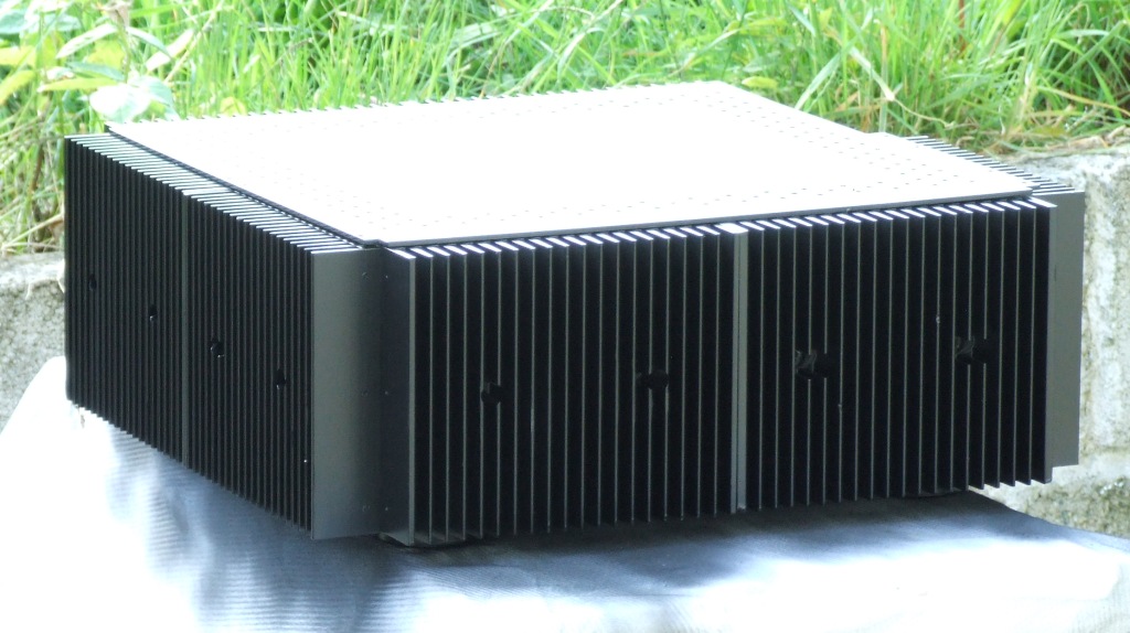

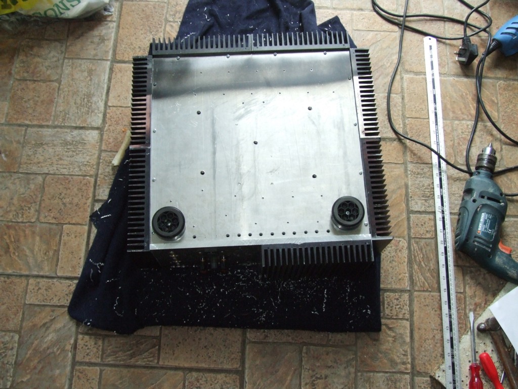

It's coming along.
It's had its final coat of paint now.
The bottom now looks like a colander, so hopefully the internal heat will be convected through the holes in the lid.
At #245 the holes were only along one edge and were only 4mm. They now go all the way around the circumference of the bottom and are 9.5mm.
Obviously it now has four feet as well.

Fan : Use an internal fan running slowly and check inside ambient air temp. 35°C is a max if you want to hold the capacitor bank long life. For the speed, your mileage may vary. Try & Error is also part of DIY's routines ;)
