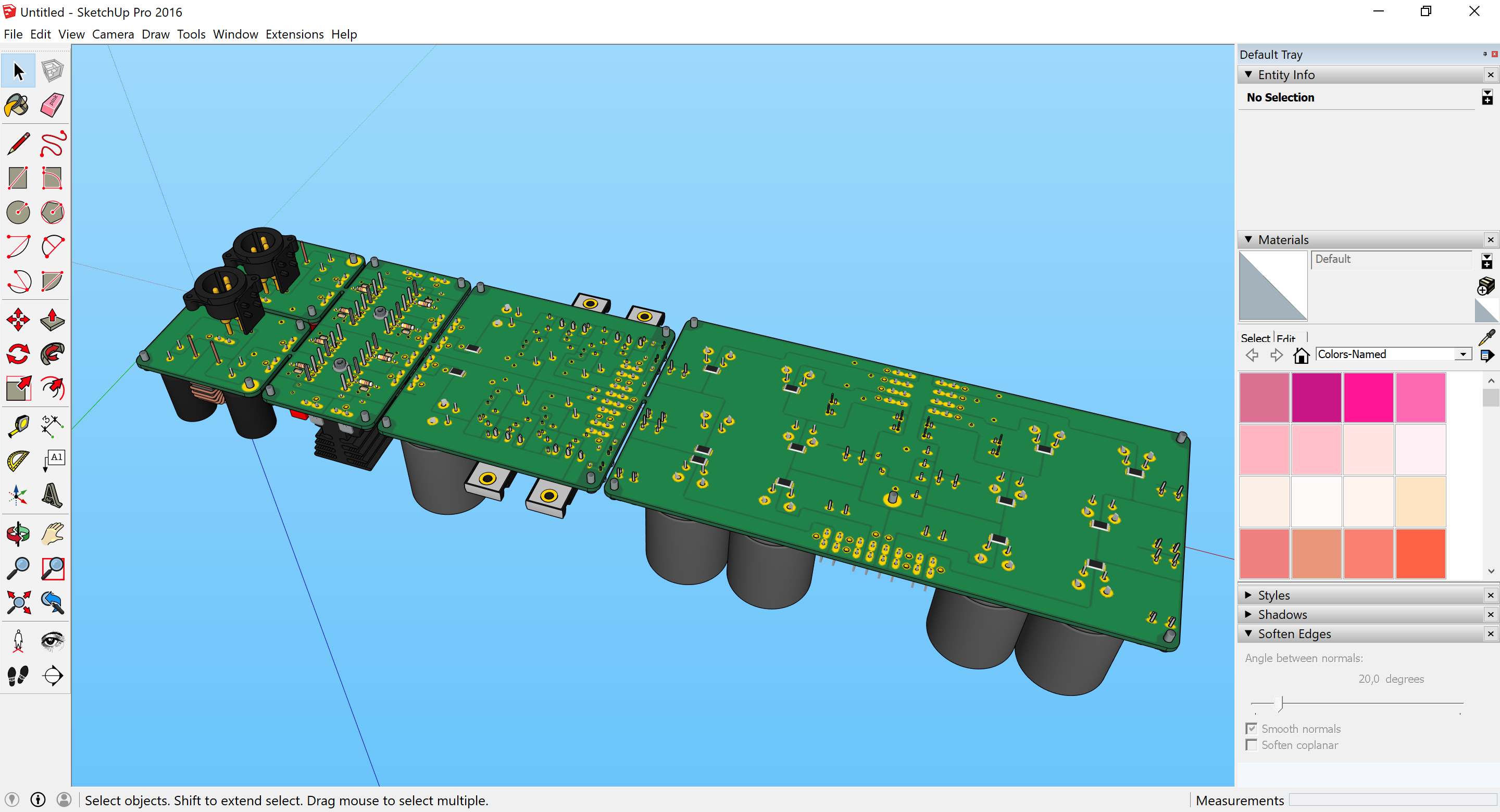

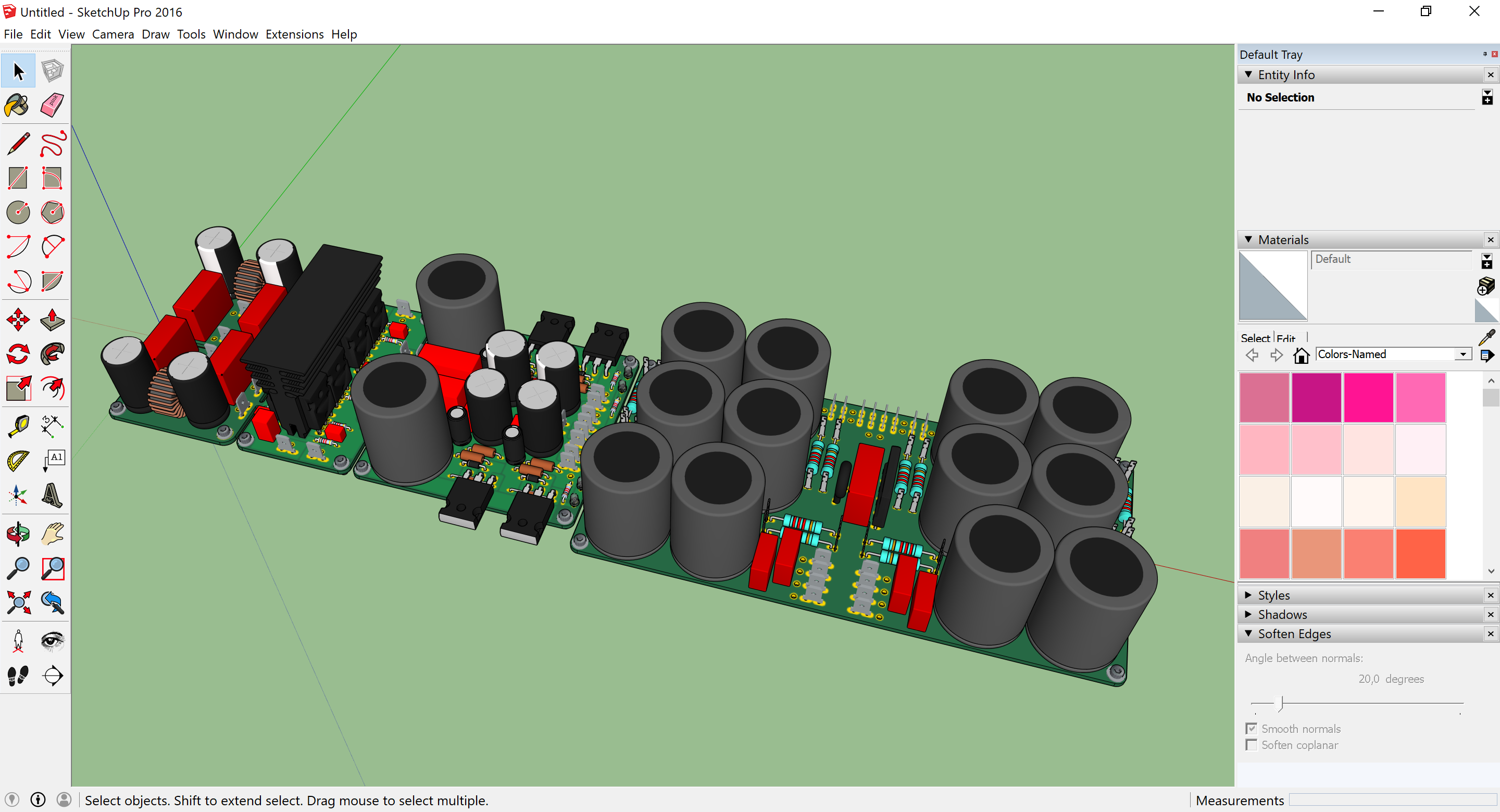

Hello X and builders (PASS one concerned too),
what do you think about universal power supply?
- CLC (XLR input connector as option otherwise hole or faston)
- dual bridge (8x TO247/TO220 and snubber)
- CapX (credits goes to @Prasi and @JUMA, his logo and her name on board)
- CRCRC (châssis grounding included)
25EUR pro panel (by 50 pieces order): 442x110x2mm, 70µm CU, ENIG, silkscreen and vias cemetery.
JP
Founder of XSA-Labs
Joined 2012
It’s probanly more a matter of the max power dissipation. If going 32v on Alpha 20, you need to swap to big IXYS TO-264 MOSFETs as it is now putting out 50w ea (assuming 1.5amp bias). I think you have two attached to one CPU cooler and they can do 125w so should be ok the with a fan. But since IRP240/9240 are so cheap, you could try it (with dummy resistor load) and see what happens. You will need to adjust the LTP bias resistors to limit LTP total current to 2mA. Probably copying the settings for Alpha BB is your best bet for runnning at 32v rails. 50w is over the SOA of the IRCP240/9240.

Thanks X.
I have a pair of Hypex SMPS’s just sitting in the draw waiting for a home. I would use them for the BB, but I don’t think they can supply enough current
(3.4A continuous)
If I use them with a CapMx, I can get the voltage dropped to about 32Vdc, I would not rework my current ALPHA20 for this power supply, it would be a complete new build with the heavier duty output devices.
Founder of XSA-Labs
Joined 2012
You can always drop voltage with bigger R’s on CRC. Just make sure they are rated for the power. Bigger R values will really reduce ripple but get hot. It’s ok for Class A as long as you are strong the requisite steady state bias current you need. There is no dynamic current requirements on SE Class A, unlike Class AB. A Cap Mx is also good for 4v drop.
